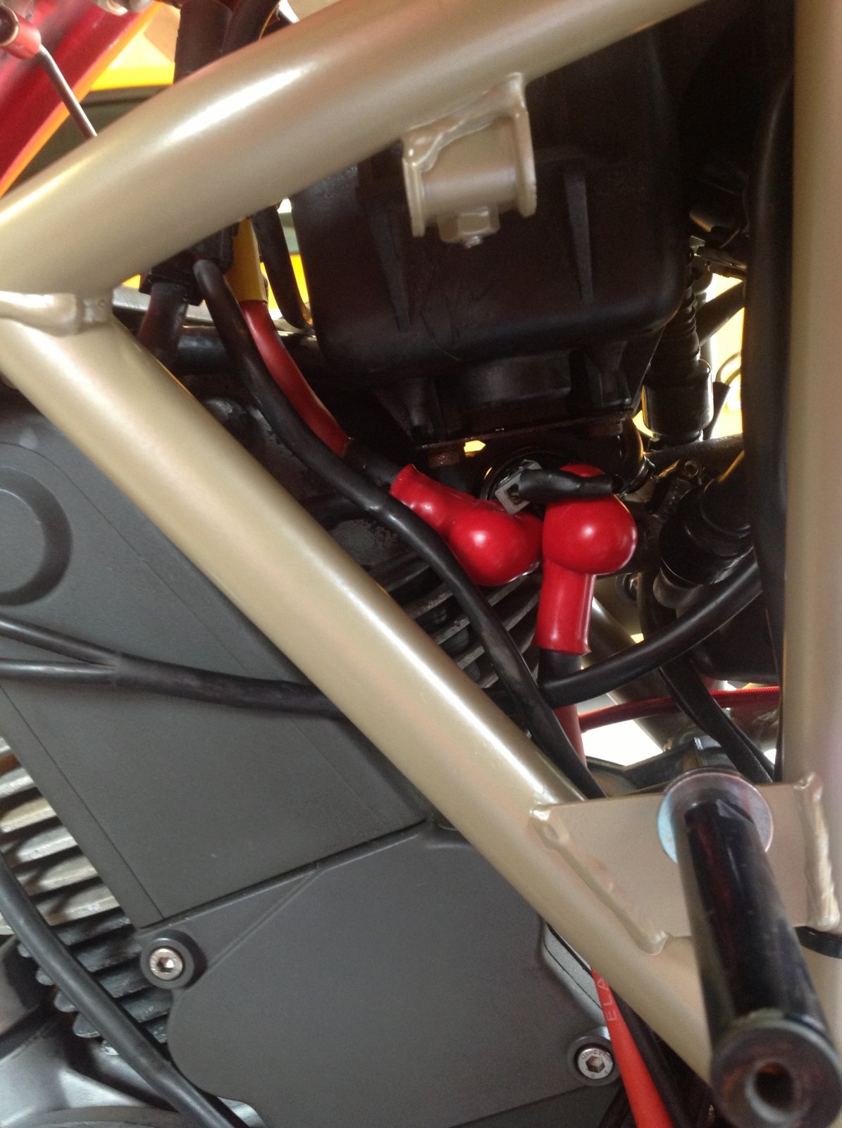

  1. IMG_0845.JPG Just fitted prototype upgrade cables for battery to solenoid, solenoid to starter and the main earth from battery to engine earth point as supplied by Stuart of Exact.
    I gave Stuart the dimensions etc for him to produce this first set for the 900ss IE model.
    Battery to solenoid and main earth cables piggy back the existing cables. Solenoid to starter is direct replacement.
    Quality and fit of these cables is excellent.
    Bike started immediately first press.

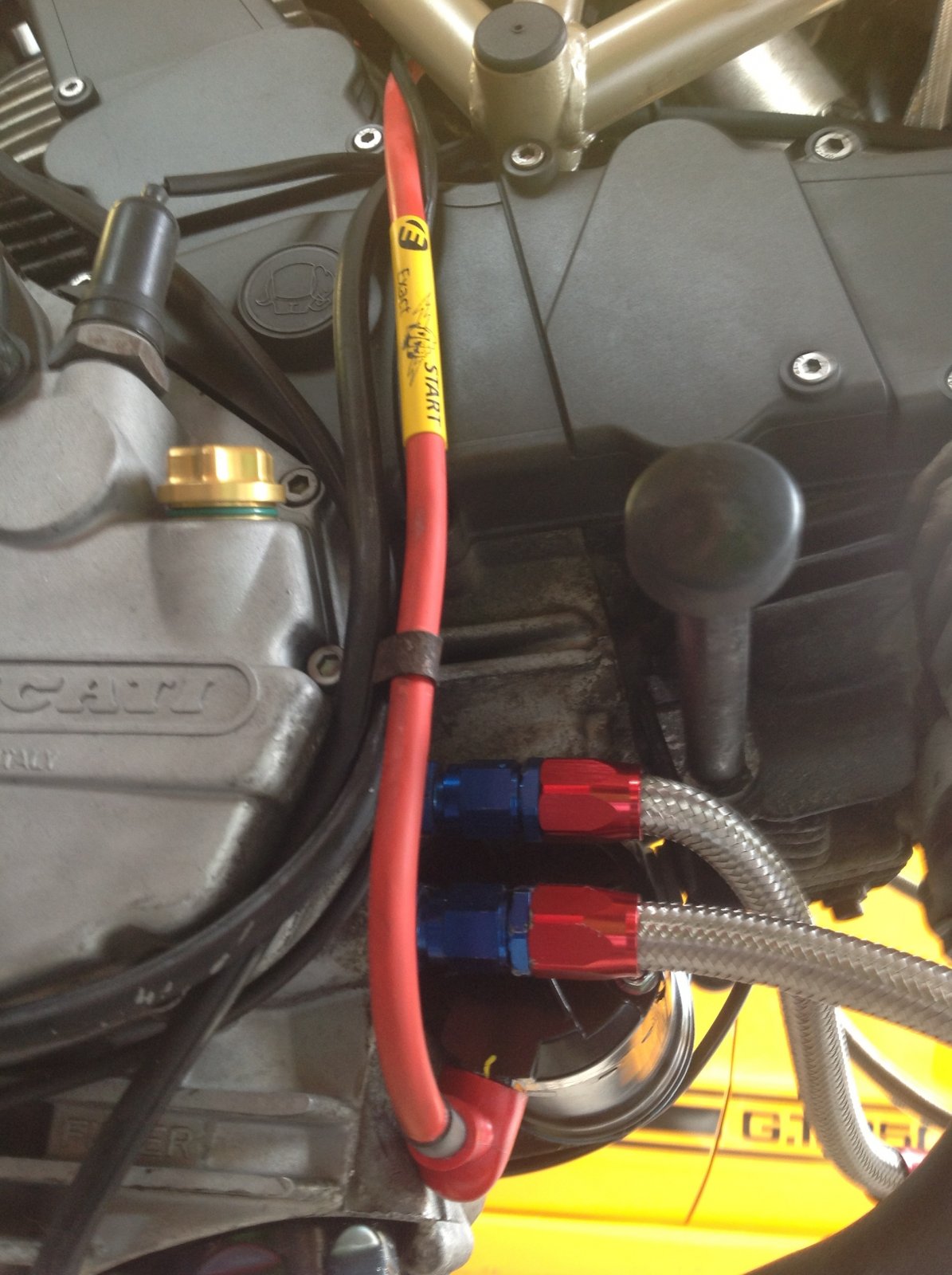

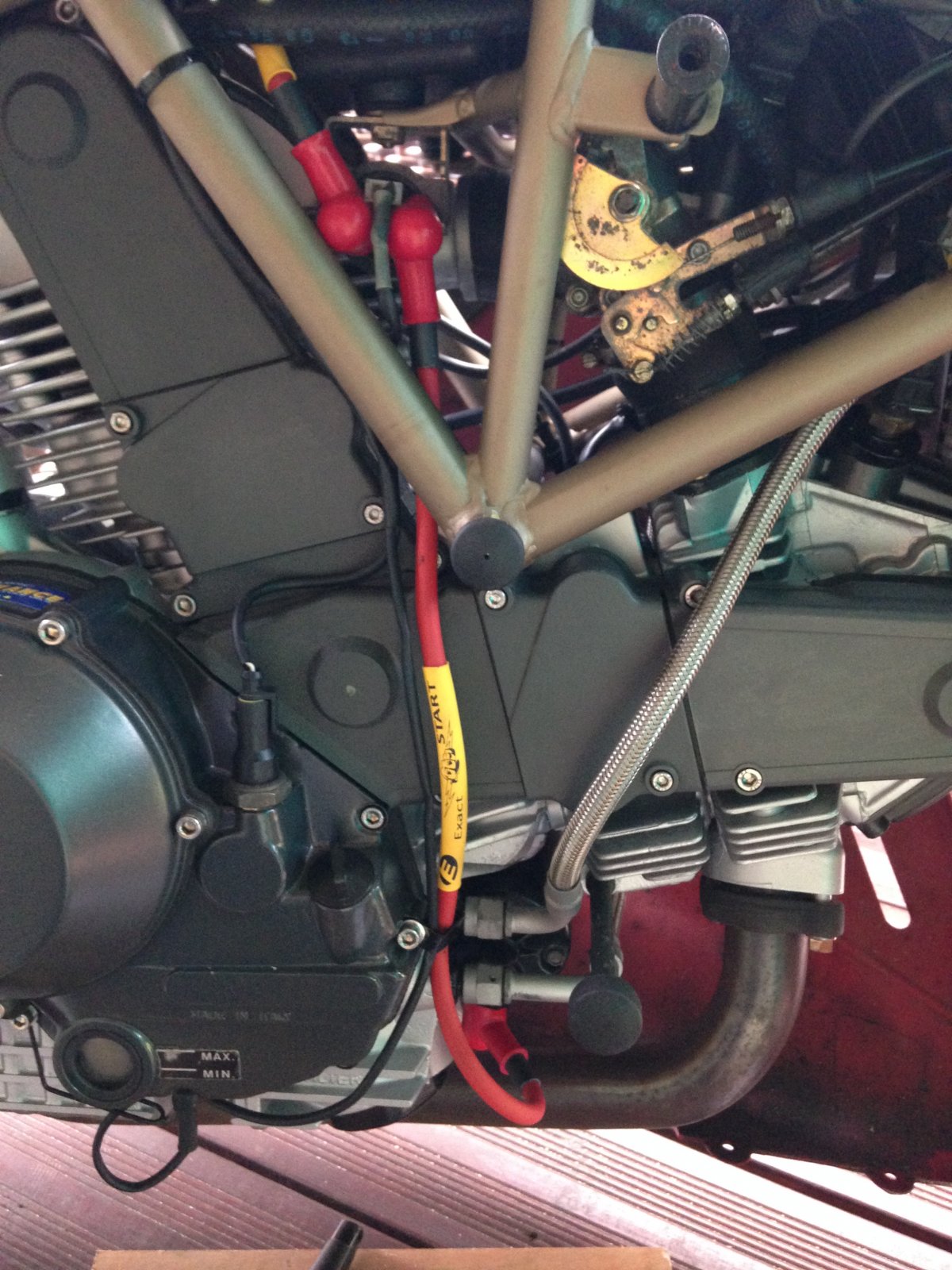

  15. Bought some starter cables off Exige for my 1996 900SS, really good quality and big improvement over standard. Also bought a coil pack off him but not had chance to fit yet. image.jpg image.jpg
