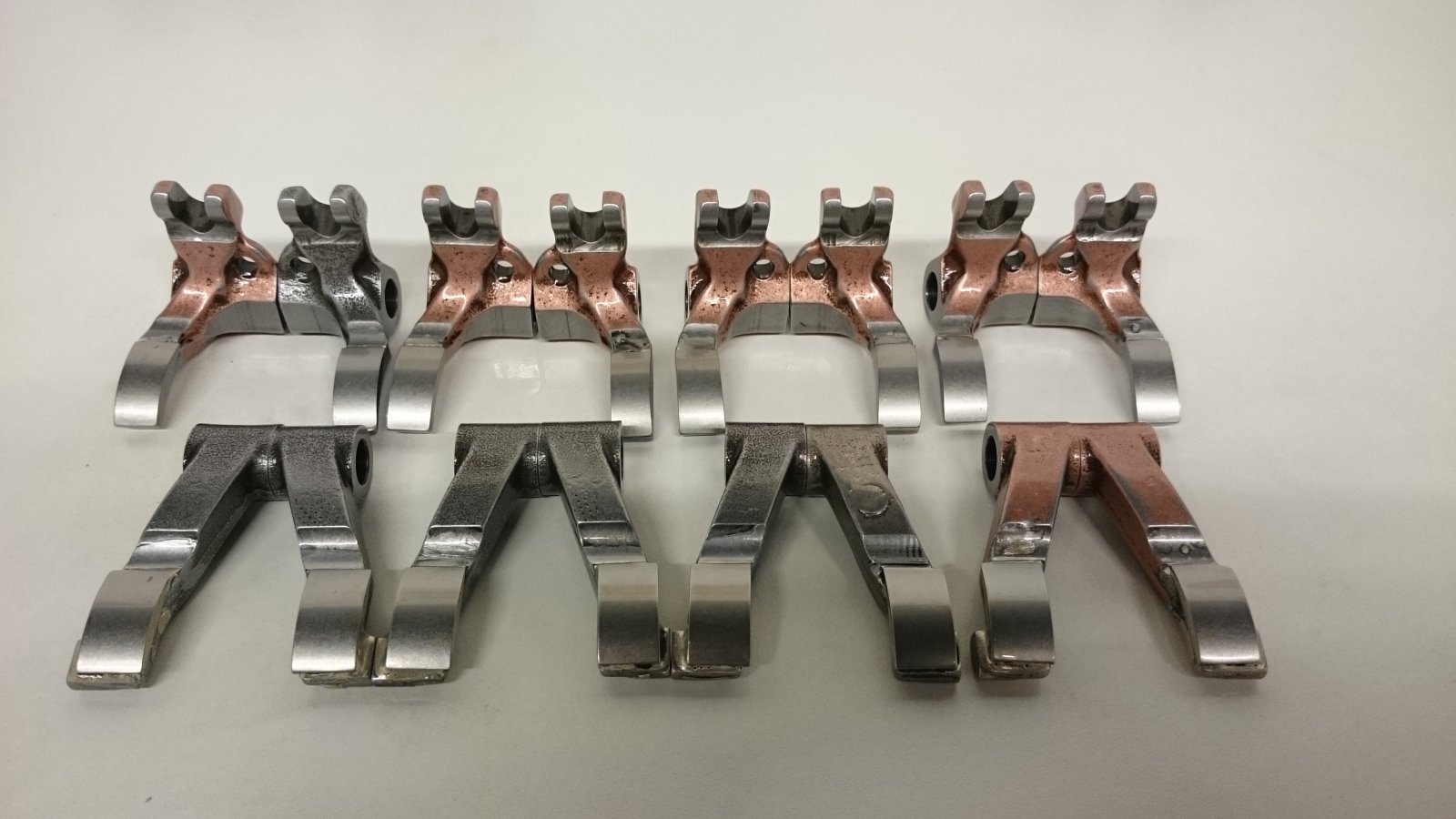

  1. Before I resort to buying all the cheap rockers I can, and after mulling over everyone’s help, experiences and thoughts in my original rockers thread a decision was made to try out the Newman cams fix.
    My reasoning being 11 years Experience with this bike has taught me that rockers flake. It taught me good second hand rockers can and have flaked. It taught me the later style “fixed” rockers can and have flaked. Also openers/closers, inlet or exhaust, horizontal or vertical my engine’s not fussy what it eats, some years its hungry and others not hungry at all. As the valves needed to be reground in any case this would mean a reshim from scratch, both time consuming and expensive but would have to be done either way. Bizarrely I think that might even be a future saving if I do the rockers now…not sure I believe it but it makes me feel better.
    So if anyone is faced with the same dilemma (I hope not) this is what £45.00 inc vat per rocker looks like… :)
  2. So thats what they look like from Newmans?Hopefully a once in a lifetime job.
  3. Any discount given for having the full set done in one go?

  7. Keith, yes that’s what Newman cams refinishing looks like and it will be interesting to see how they last.

  10. Had some done by Dave Newman Cams, on my ST4 a few years back due to the same old 'flaky chrome' issue you've been experiencing. Rich at Louigi Moto had a big cardboard box under a bench, full of scrap Desmo Quattro rockers that he'd previously replaced!
    After he'd given a couple of companies a go at 're-chroming' them and been disappointed with the results (as you've been), he's changed to having them done by Newman Cams. Mine had another 6k miles put on them and looked like new, before I was forced to sell the bike :-(
    FWIW, the only thing I would advise is to replace them in pairs e.g. both inlets/both exhausts, as until I did that I experienced some high frequency vibes through the footrests. Rich put this down to the refurbished rockers having a subtly different profile to the originals, which messed up the fueling slightly and set up a very slight imbalance between the cylinders.
  11. I've had Newman opener rockers in my 916 for 3-4yrs now and along with MBP collets the valvetrain has been spot-on.
    Previously had 9 openers flake but since 'Newmanising' I've had no 'glitter' in the oil and only one shim change (at recent service) and even that was still well within tolerance and I only changed it for OCD reasons. ;)
