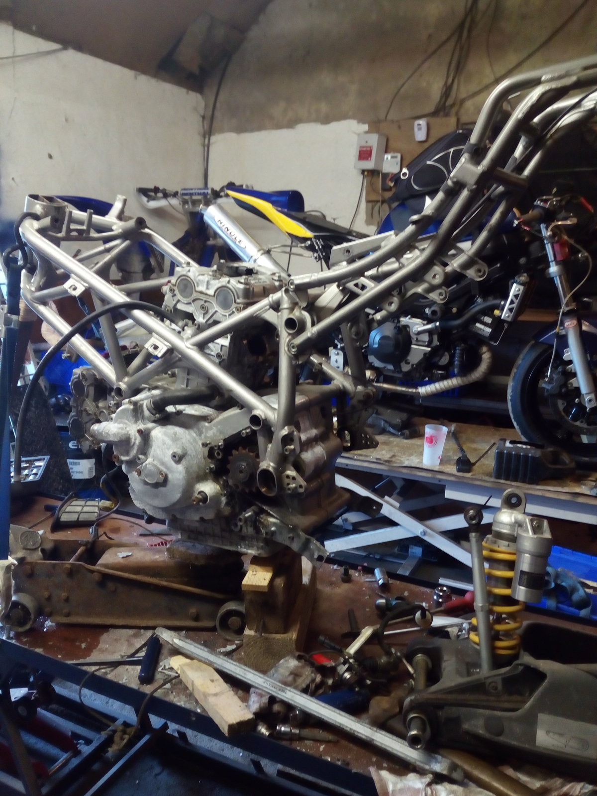

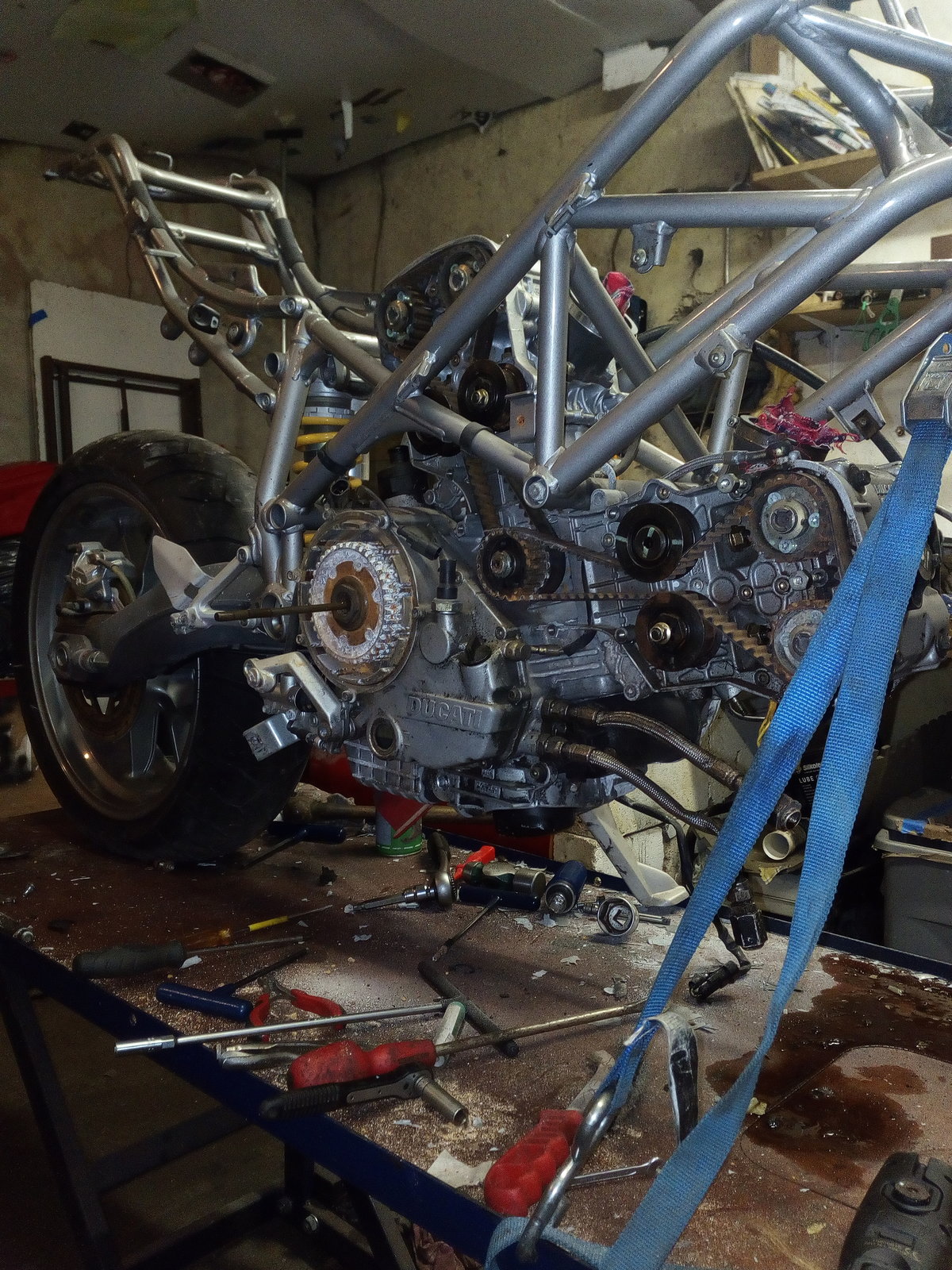

  2. Lots of piccies!Crappy weather is coming,so need something to keep away from the telly!

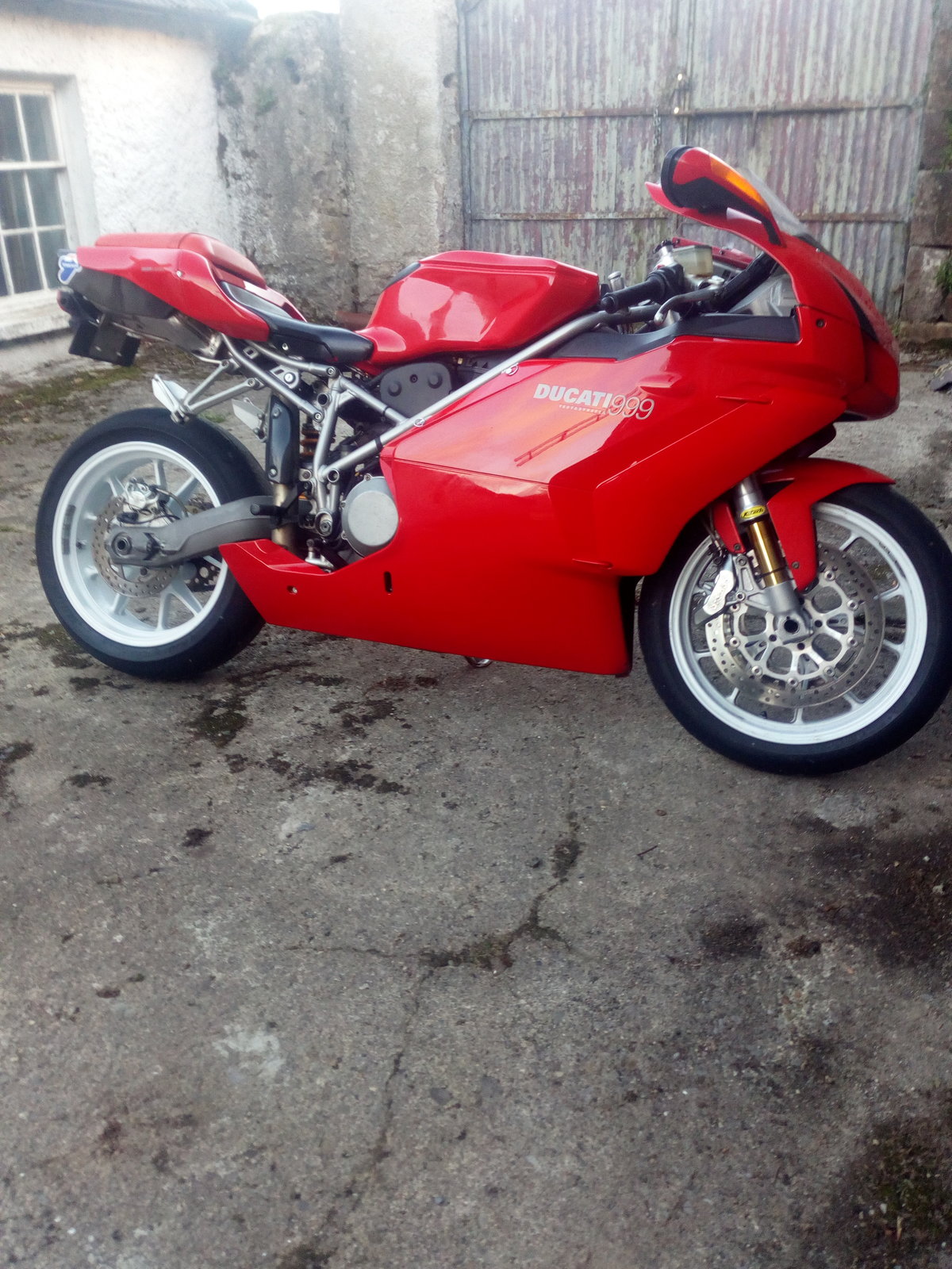

  3. Here's the one that I use and enjoy.

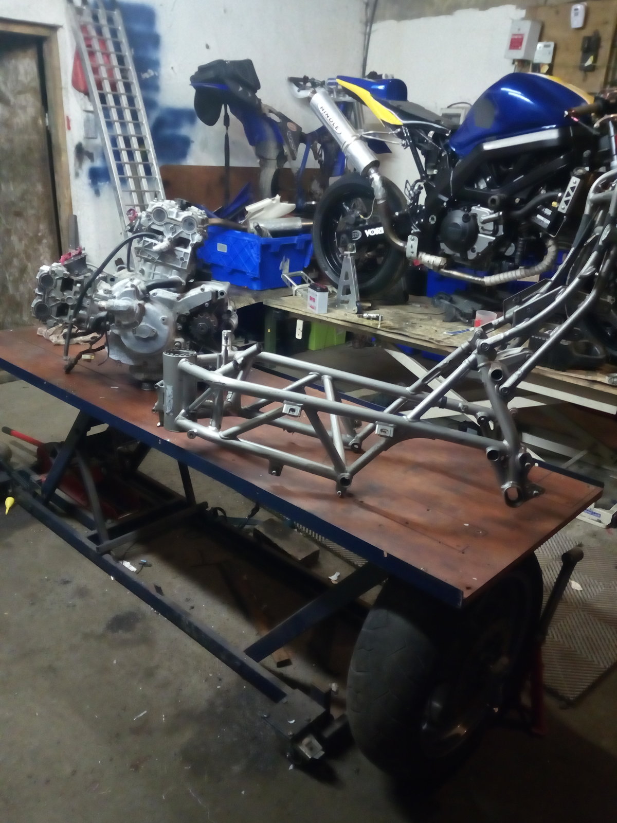

  4. IMG_20181027_165006.jpg Swingarm off.
  5. IMG_20181027_193932.jpg Time to get busy on that ratty looking engine. Not sure what direction to take with the frame. I'd like something different...de-lug the frame and make a naked. It would be cheaper in the long run.

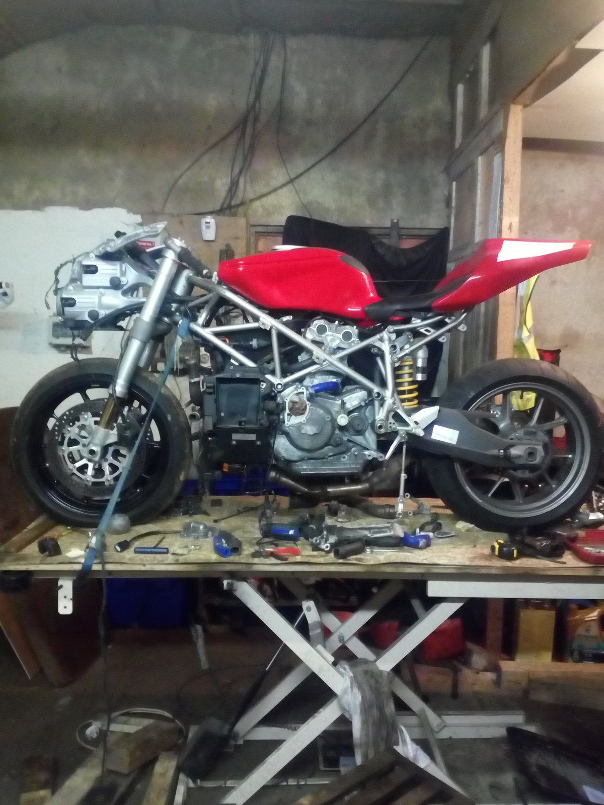

  6. Some progress.
    I have a rolling chassis.
    It's got great form. I'm swaying towards a naked build, minimalistic.
    Possibly a red frame with silver body work. That ugly electrics/battery holder is the only thing that will cause issue's. IMG_20181116_173939.jpg

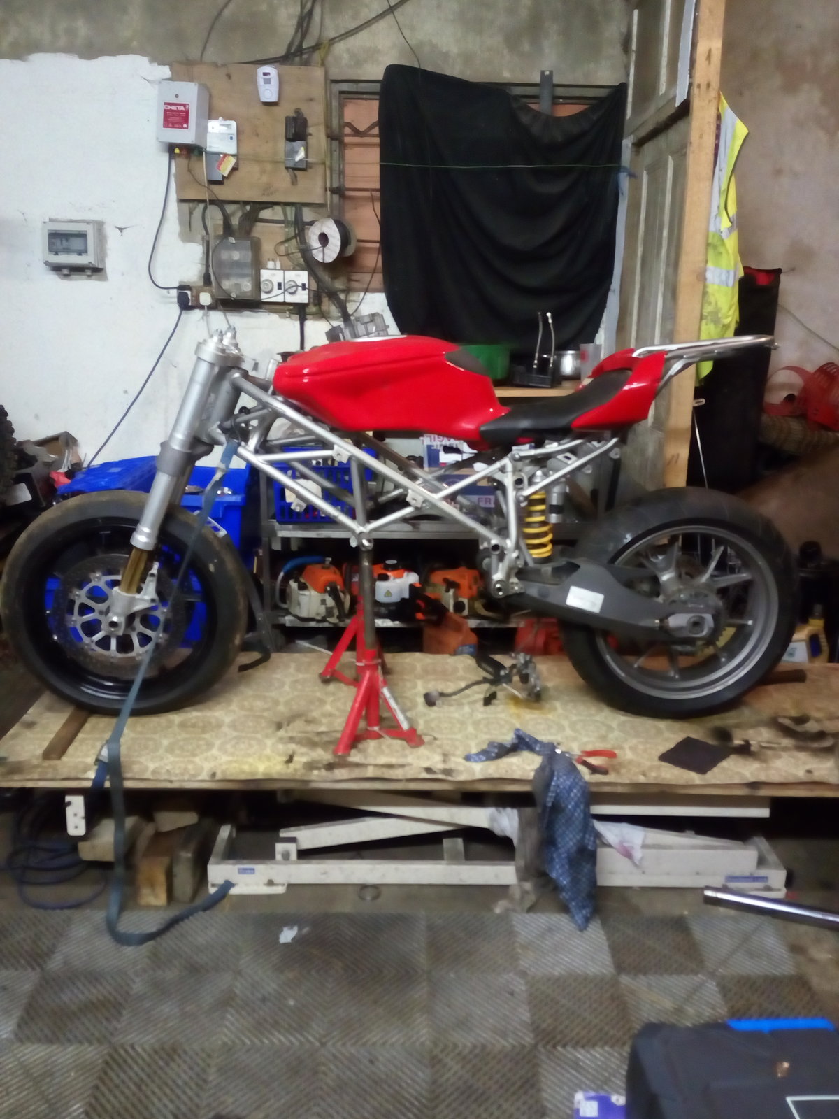

  7. IMG_20181222_210140.jpg Just hooking everything up to see if there's life. I'm not sure if I have the original clocks. They came with it,the LCD screen in busted but the date on the back is '05. It is possible they were changed before the crash. Fingers crossed.
  8. So I hooked up power, fuel pump is priming,clock is sweeping, oil light,neutral light, engine management light and the little key symbol on the LCD screen along with a rapid countdown when I power on. What I thought were the original clocks just have flashing idiot lights and no LCD display. Start button does nothing to the starter relay,clutch switch is bypassed. Am I missing something to get the starter activated??
  9. There is a good build thread turning a 999 into a Sports Classic which may be of interest if you are going naked.
    Personally I'd be putting the fairing back on, even if it's just Chinese while you source decent OEM.
  10. did you get it running before you took it apart..
  11. sidestand kill switch?
  12. Kill switch is hard wired on as is the side stand switch.
  13. Bike hasn't run since 2005 when a car hit it. It was running up to that point ;-)
  14. So before you stripped it you didn't see that it would run...
  15. Key symbol and countdown is indication of immobiliser looking to be programmed. You need to get around that before it’ll do anything else
