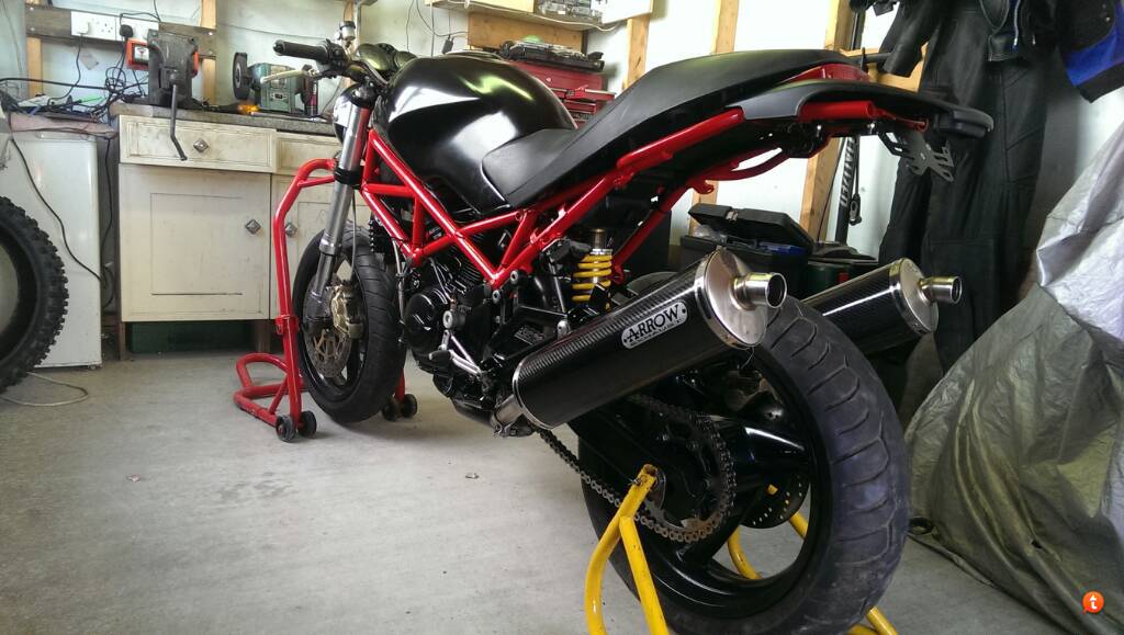

  1. Hi all, my monster is all back together after stripped and powder coated....Had a virginised ecu of Chris from the forum due to mine being fried, and bike fired before strip down. No I can't start it of the button. Battery was showing over 13v, all electrics working, pump priming. Bike will crank over when solenoid is bridged, clean main earth, no noise at all from soleniod when starter button pressed. I've put a multimeter on the two tiny spades in connector from starter button to solenoid and it's showing 9.5v...but no variation when pressed??? I'm also confused by I've a picture of the loom behind the headlamp prior to strip down, and I can see a little white wire connected to the bracket behind the headlamp by an eyelet, but I can't seem to find it now...All lights work, horn ect...but I have removed indicators.....very frustrating![​IMG]

  5. If the switch is faulty you will probably need to bridge it out to test it, I'm not familiar with your bike but that would be where I would start with your symptom's.
