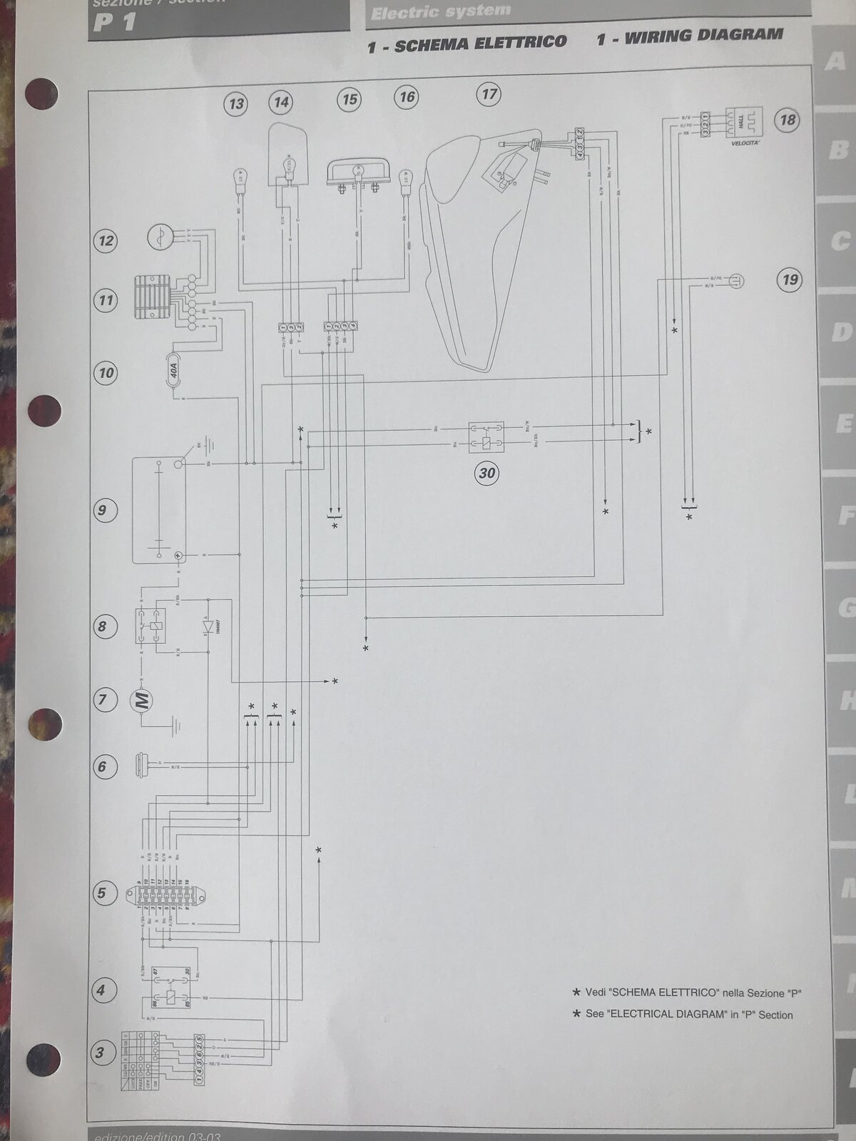

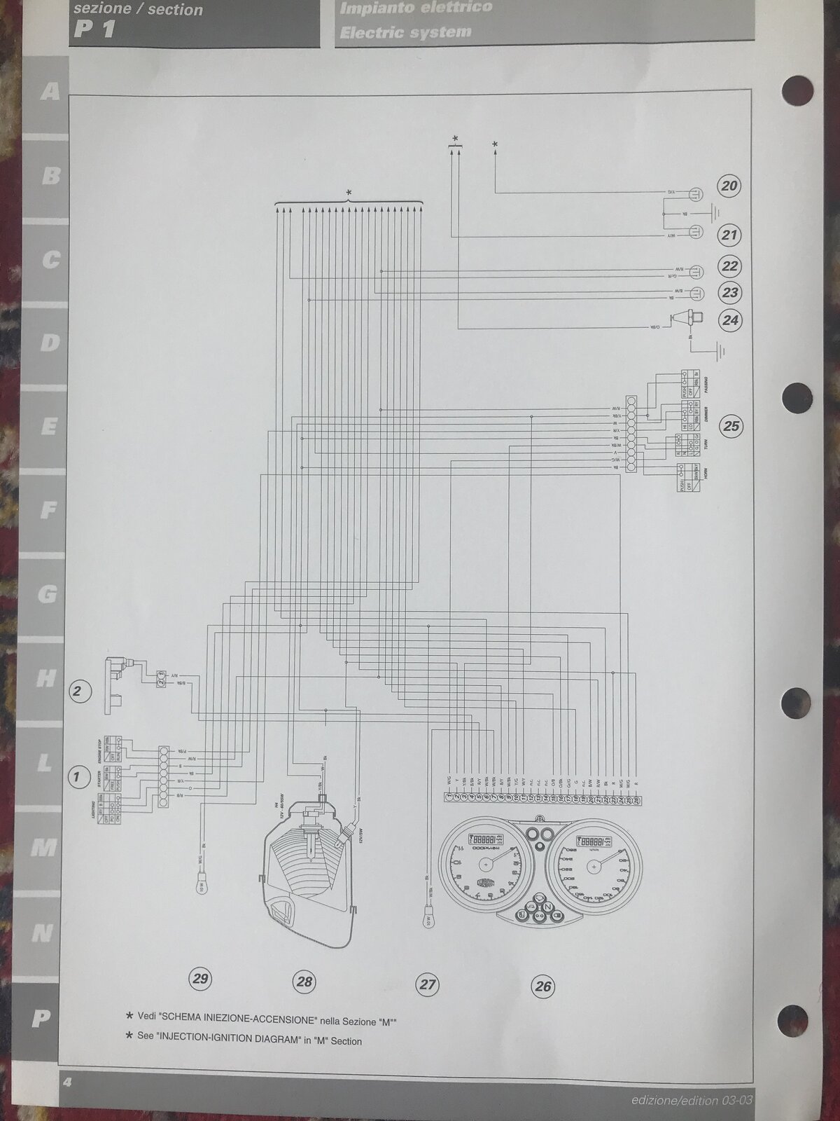

  1. Does anyone have a wiring diagram for a 1000SS ie?
    I've looked everywhere on google and can't find one.
    All the usual sites have owners manuals for the 1000SS but not a workshop manual with a wiring diagram.
    The closest thing I can find is a Monster S2R 1000 one. I'm hoping it's almost the same as it looks like it uses the same clocks which are key to the system with lots of connections made internally on their PCB.
    The at first obvious choices are no good.
    The 750/900SSie has a completely different electrical system because it uses different less complex clocks(mechanical speedo etc), and the Multi 1000 again uses different clocks and I believe is even CAN BUS.
    Thanks
    Nasher.

  3. Here you go
    C376769A-145F-4F6F-BB77-FB9C544199EB.jpeg 687D2B96-7272-4033-8FB3-7EE6C61F40A3.jpeg 75CB4046-267A-4E6E-8BB3-48CC0A20C6FC.jpeg 0324E04E-049B-4569-9ECA-4FE760CACACA.jpeg
  4. Wassy, you're a star, many thanks
