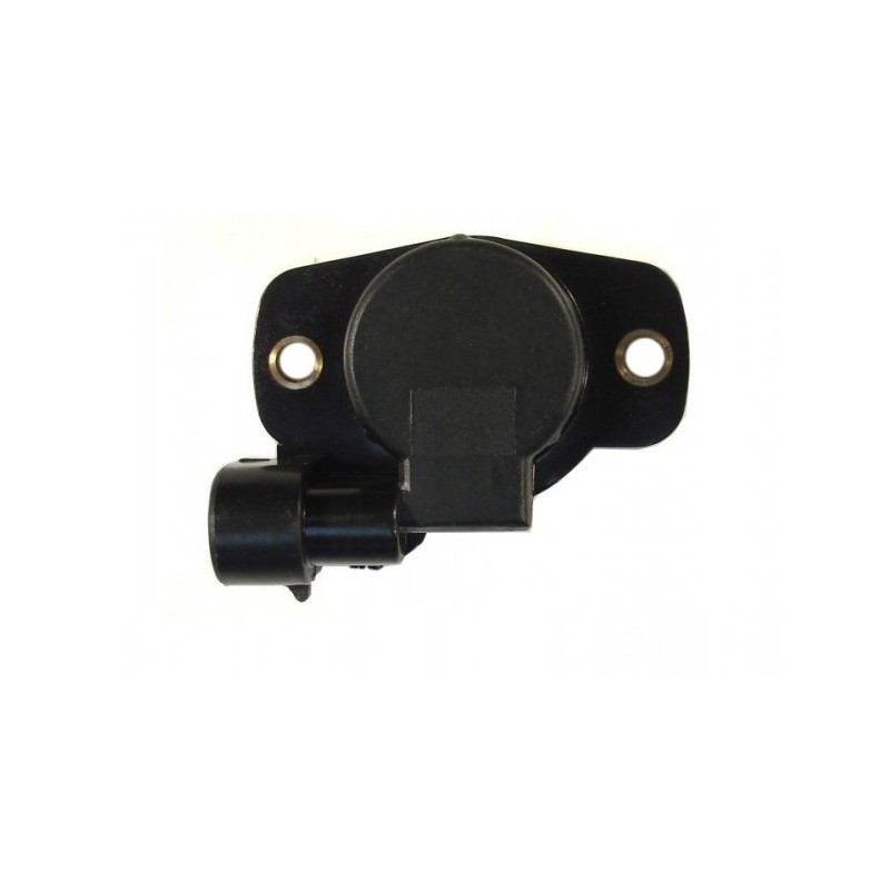

  2. How are you resetting a non-linear TPS using JPDiag?
    The TPS reset is for linear TPS.
    For your bike the TPS has to be reset using a multi-meter. Hence why the TPS has slots where the bolts attach.
    http://www.bikeboy.org/ducati2vthrottleb.html

  4. Non-linear 28440021a
    Or Linear
    A quirk of JPDiag is it will allow the TPS routine even when a non-linear TPS is fitted.
    #4 chrisw, Nov 14, 2020
  5. Easily observed as above. Non linear has slots for adjusting but for clarification the 1000ssie was fitted with a PF3C part number 28440021A and is a non linear TPS. My 2004 monster 1000ie is fitted with the linear TPS part number 28440081A.
  6. Sorry Geoff, that's not correct.
    I've had a look today and the bike is definitely fitted with a linear TPS just as Bikeboy says, and about 50% of the websites I've checked agree.
    The other 50% say it's fitted with a non-linear PF3C like the 750SSie and 900SSie, but that's incorrect.
    I've also had a message from another 1000SSie DS owner who's had a look and confirmed his is fitted with a Linear TPS. So it looks like for the 800SSie and 1000SSie DS the Linear TPS was fitted.
    Nasher.
  7. Thanks for the update. I’ll add this info to my notes. The TPS could be faulty. Hopefully you can pick up a cheap Fiat compatible one.
  8. Thanks for correcting . Just goes to show you as that’s the part ducati list for the 2003 1000ssie. One good thing the linear TPS is a lot cheaper from ducati.
    https://www.bike-parts-ducati.com/ducati-motorcycle/assignment_spare_parts/28440021A
