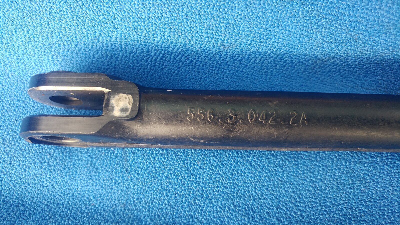

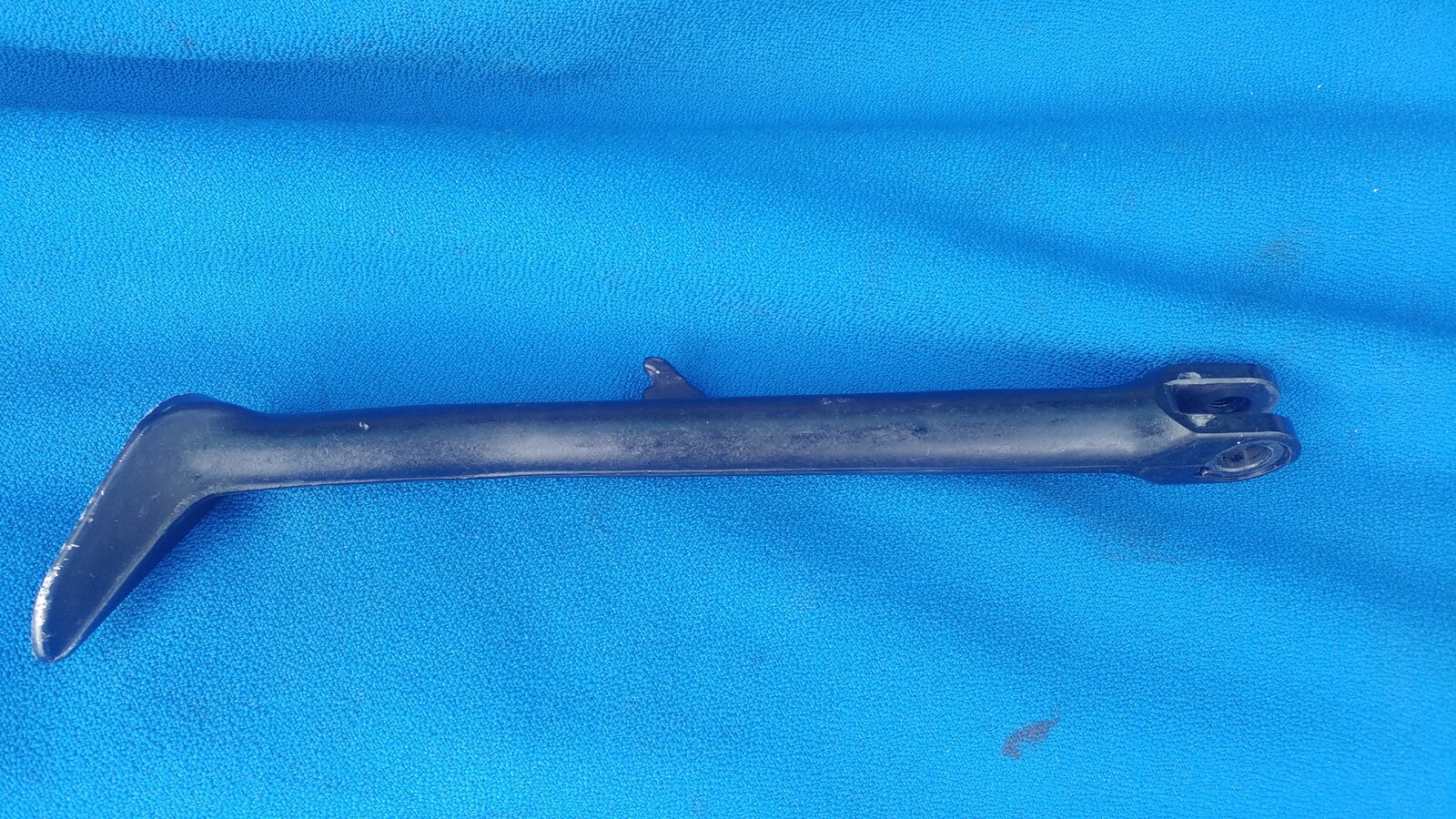

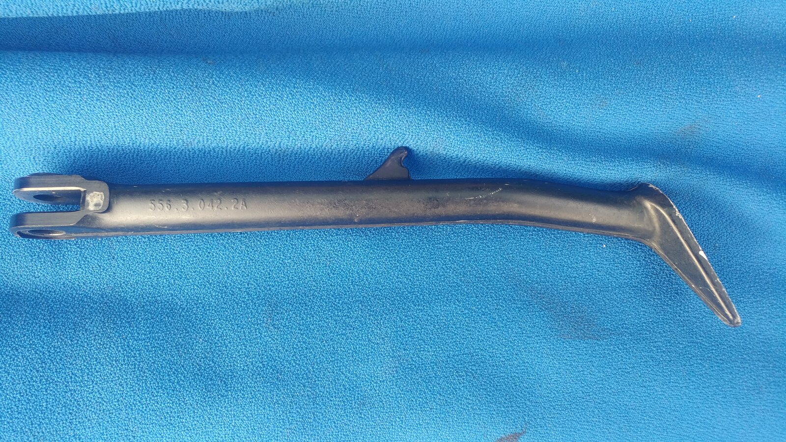

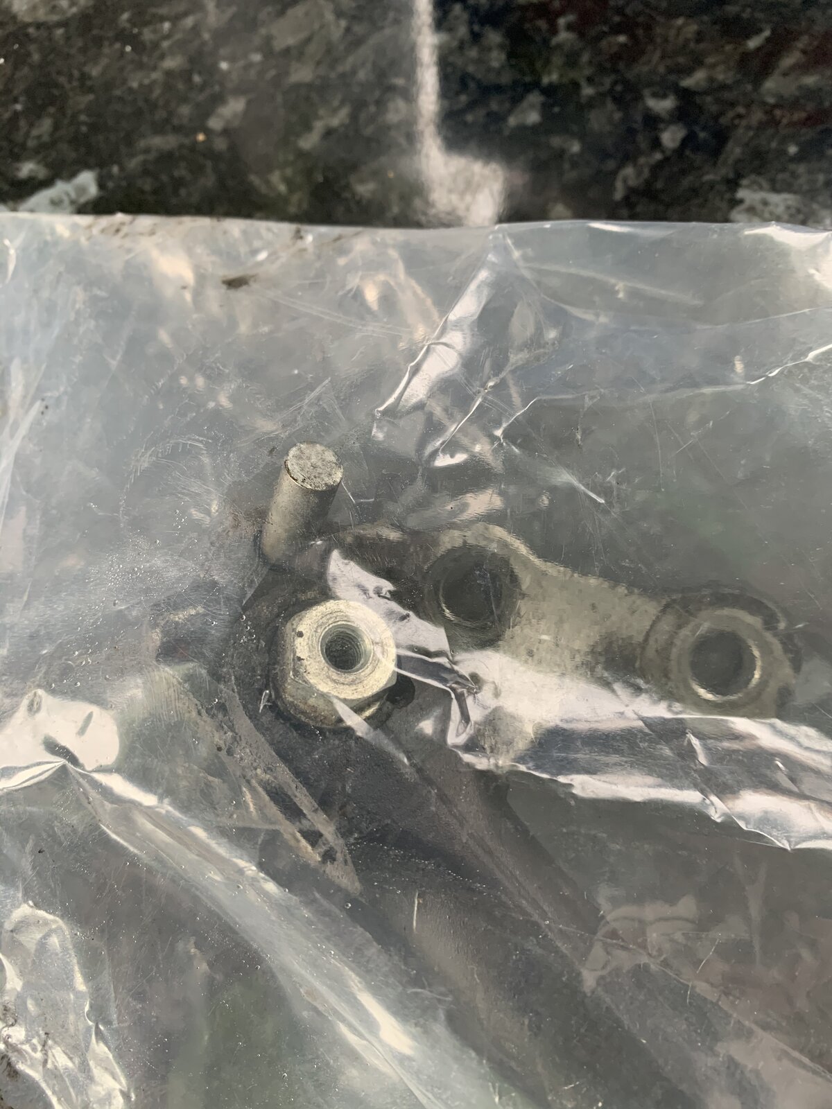

  13. Looks like I got the bolt and bracket included. Makes it even more of a bargain. 8B304EE7-DC5A-4BBF-81BE-9E78A850C1D0.jpeg

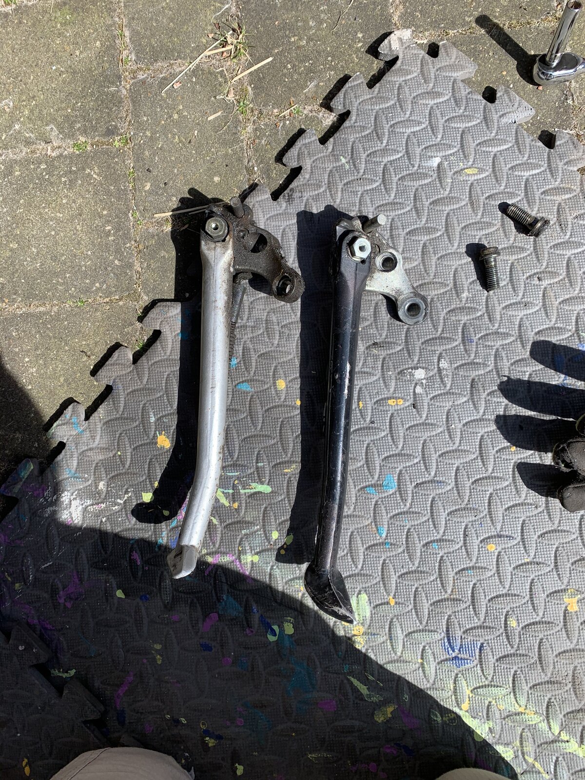

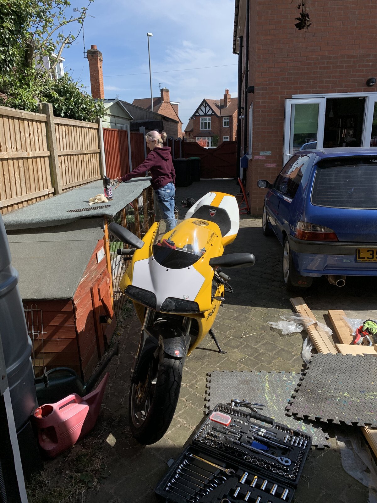

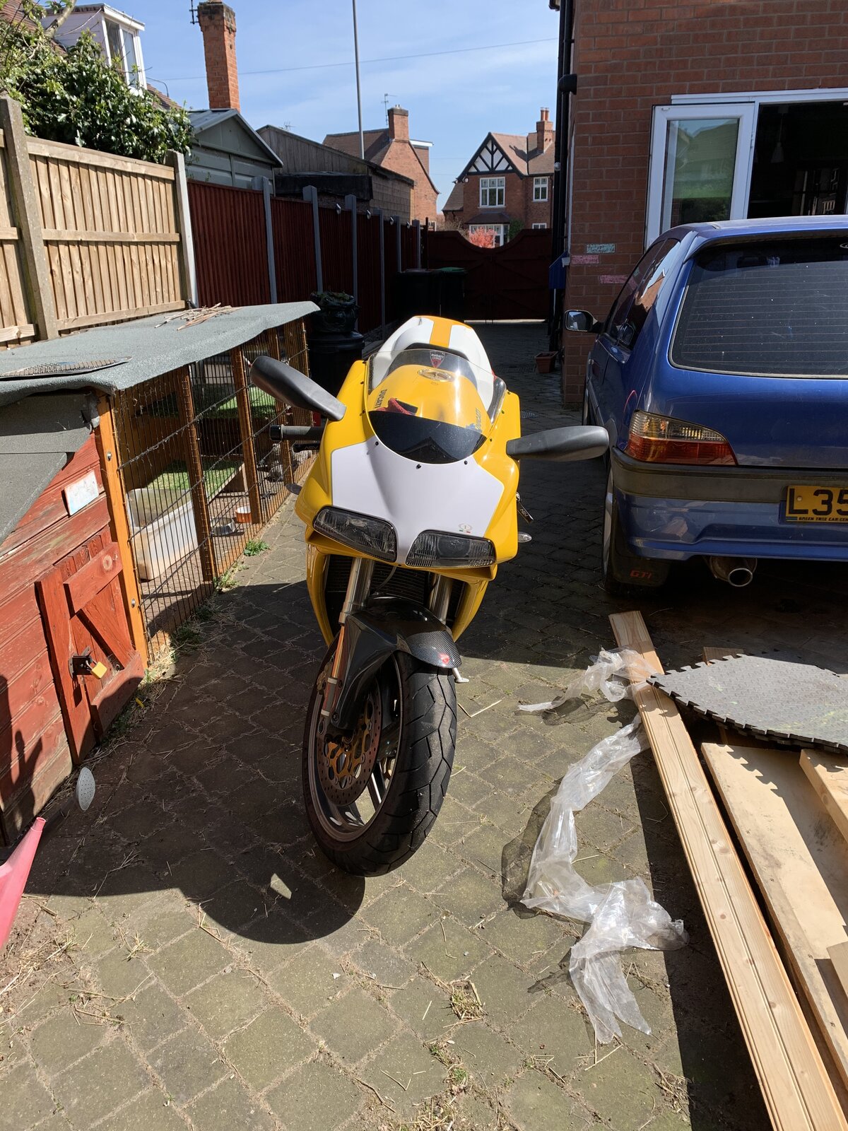

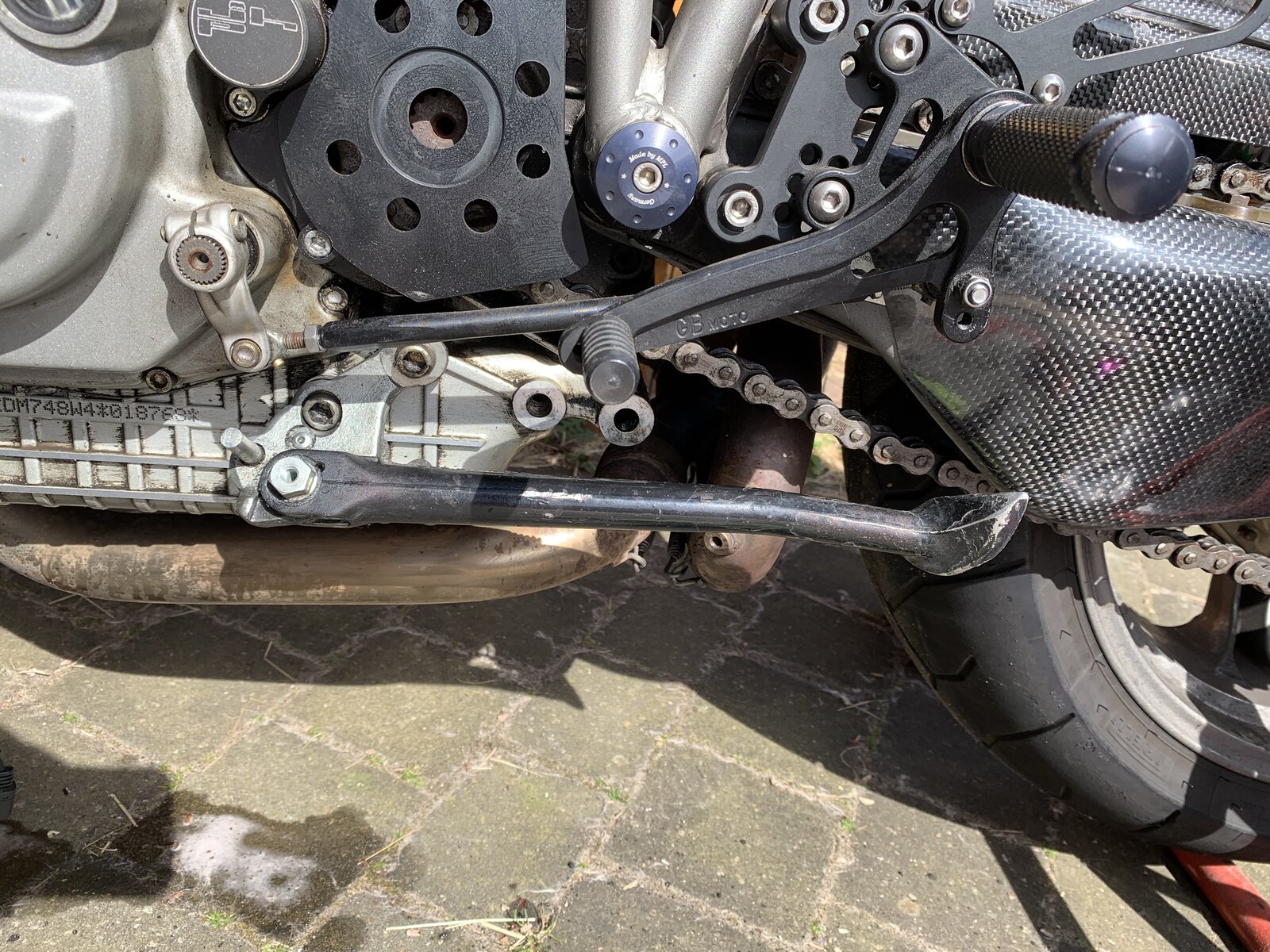

  16. 53207420-5506-4F15-A39E-38E6548688D7.jpeg 14897F6C-E907-474D-A468-C69A7F1F7993.jpeg 0FCE585B-0C63-4C8F-A60A-8C674DCA4355.jpeg 1AF3BEE9-2F62-41A3-8022-46AFBB3E08E7.jpeg
    finally got round to fitting this today. Only took 5 mins. Pics should be in order. Before during and after.
  17. Yeah that’s back on. Just didn’t photo it fitted back on.
    tested it works ok still and it does.
