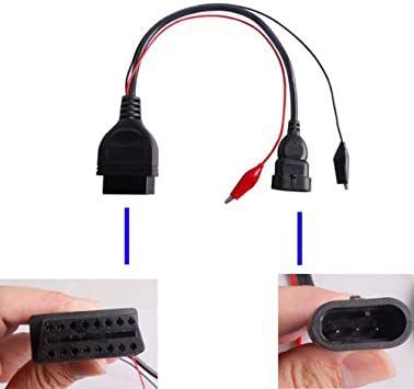

    I went with the following at a total cost of about £24
    Fig 1. OBD2 to Fiat 3-pin adapter lead.
    Fig 2 - OBD2 to bluetooth adapter.

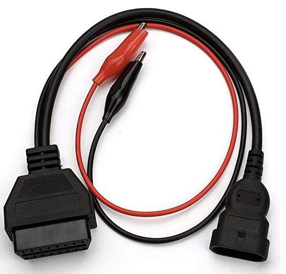

    The first (Fig1) to plug into the bike, an OBD2-to-Fiat 3 pin cable (what online wisdom suggests is the correct connector). And the second (Fig 2) is an OBD2-to-bluetooth adapter.
    After rooting around in the loom (my 1098 engine is in a 996, so things aren't where you'd expect), I hit the first problem: The Fiat 3 pin is most definitely not the correct cable:

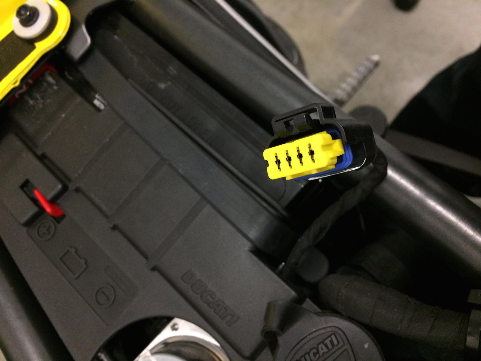

    Fig 3 - (Not my image, but identical to what I experienced) Top; the connector on the 1098, bottom: the Fiat 3-pin connector.
    So; the connectors don't mate properly and the pins on the bought cable are far too big to fit in the Ducati connector. Interestingly, the Ducati connector has three pin in the connector, but only two wires running to it. This got me curious and I looked up the wiring for the Fiat 3-pin connector.
    From left to right in the above image (Bottom of Fig 3, let's say pin 1,2,3) they are labelled as follows:

    Undeterred, I fished a spare superseal kit out of my toolbox and decided to 'modify' the 3-pin end of the Fiat 3-pin cable to make it fit the Ducati's superseal one.
    I used a multimeter to 'buzz out' the purchased cable and make a wiring diagram, and then cut the 3-pin fiat connector off. Fitting superseal pins (not the full connector) to the bare wires then allowed any and all combinations to be tested, but I started with the wiring in (*). To be honest I wasn't expecting it to work because of pin 3 not connecting to anything on the bike, but trusted the instructions provided and plugged it in with my fingers crossed...
    It didn't work.

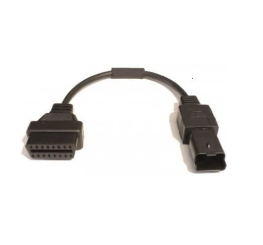

    Fig 4 - the Ducati 4 pin connector. (again, not my image, but the connector is identical, so who give a f**k).
    I'd noticed this connector on my 1098 wiring loom and decided it was worth a punt, so I ordered the connecting cable:
    Fig 5 - The Ducati 4-pin to OBD convertor cable I ordered.
    I was full of optimism, convinced it would plug straight in and all would be well.
    Again, disappointment. No connection to the ECU with any of the apps.

  2. Curious where you got your 3 pin cable? Mine fits my 848. The connector has the vertical plastic piece between pins 2 and 3 as well.
  3. Connector was an amazon job. Can confirm it also has the plastic divider between pins 1 and 2. Exactly as this photo (see bottom right of image):
