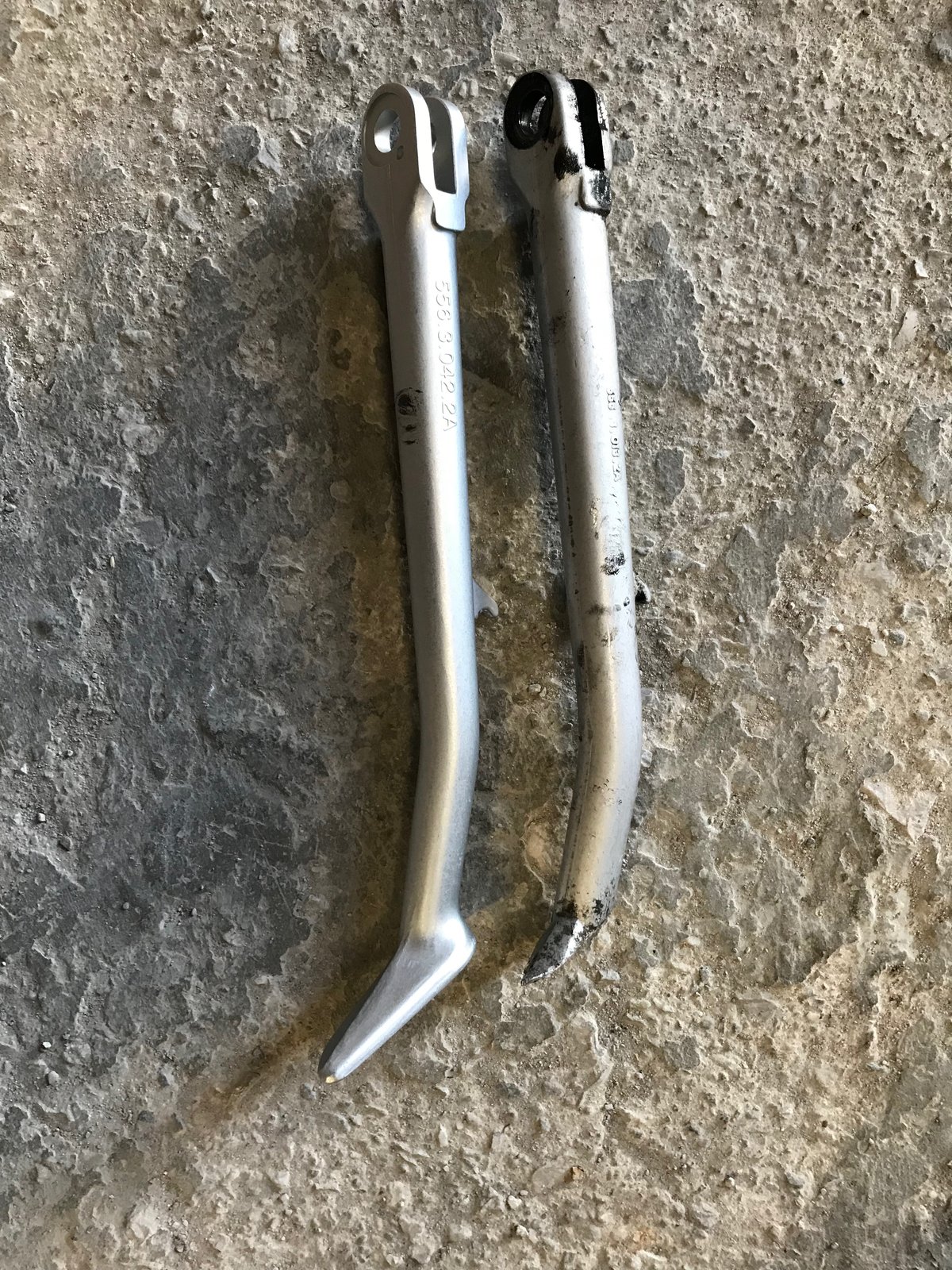

    My old side stand was knackered. Bruised and battered after two bike-knocked-or-fallen-over incidents, and I guess nearly 20 years of service. I was scared to leave my bike parked on the stand as it was leaning over so far, a light breeze would have knocked it over again.
    After a lot of thinking about what best to do to replace the old stand. I decided to take a punt and order a replacement - but from a later model bike. In this case I ordered a 1098 stand.

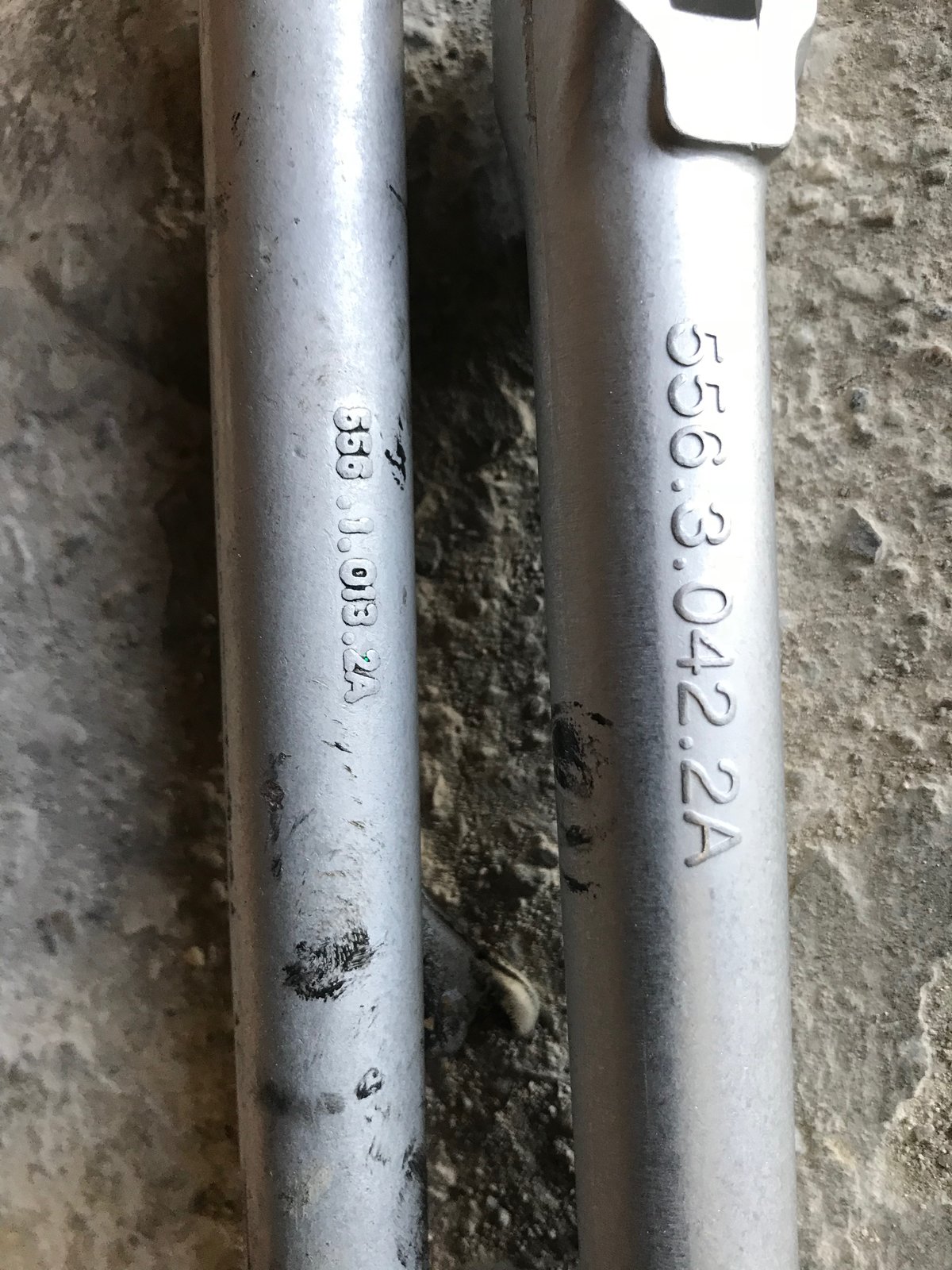

    996S stand part number: 556.1.013.2A (55610132A)
    1098 stand part number: 556.3.042.2A (55630422A)
    Here is what I found:

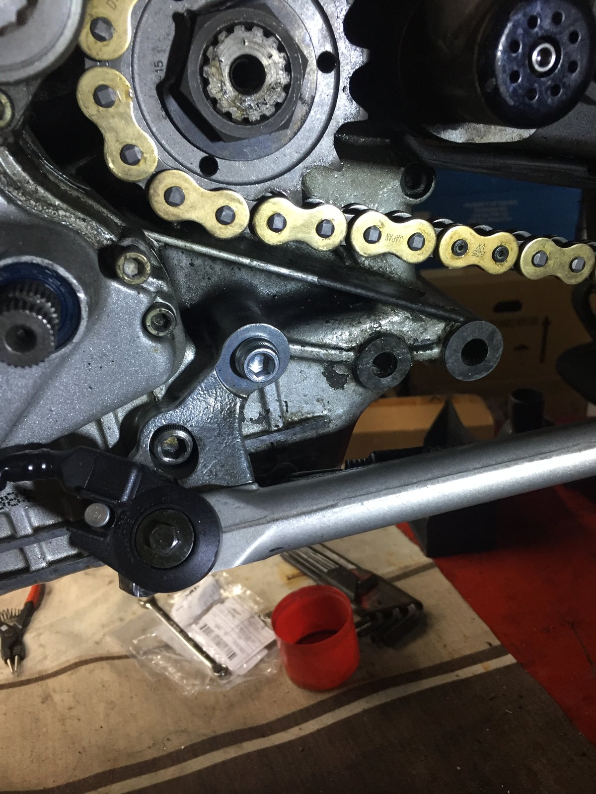

    1. It is a straight swap. All pivot bolts, springs and mounting points are exactly the same
    2. The later model stand is marginally longer
    3. The later model stand has a much larger footprint
    4. The bike stands more upright and feels infinitely more secure.

  9. Yes it will :upyeah:
  10. 100% straight swap. Even the neutral safety switch is a perfect fit

  14. I want to make a point so other readers are not confused - this is not replacing a good condition 996 stand with an aftermarket alternative. My original stand was in a bad way and could not hold my bike up at a safe angle. Suffice to say the original stand had reached the end of its service life. So I needed a new one. The 1098 stand, compared to a bruised and battered 996S OEM stand, was substantially better.
    Now with the new stand fitted: I kick the new stand into position. As I let the bike fall gently to the left, onto the stand, it moves just a few inches. Leaving the bike in a much more upright position on a much larger foot pad. Anyone needing to replace their old stand, I guess as long as their ride height isn't adjusted too high, will do well to consider a 1098 generation stand.
  15. Ive just ordered the streetfighter 1098 stand, only place I could get one was the usa, Going fit it to my 888, will update and say how I get on but could be a few weeks before it arrives, also have some info to share but will hold out for now on that one
  16. ??
  17. Want to get my money back first :bucktooth:But just so you know it's regarding a certain well known ebay seller. Will see how I get on but getting money back shouldn't be a problem. :upyeah:
  18. Good luck
  19. Lol all I will say is don't buy the 1098 side stand he has for sale. It's the one with the 996 side stand part number stamped on it :mad: yep I should have known better but I took the gamble. Was the only so called 1098 stand on eBay He also asked me to buy outside of ebay to get it cheaper. Bank trans or PayPal. I went PayPal but bought it as goods. Not that stupid to gift him :eek: I bought a nice Ducati leather wallet the same day through ebay of him. It's arrived but I'm going to sell it on because it's smaller than I was looking for. Its the size that would hold service books etc
