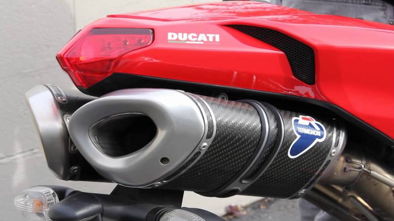

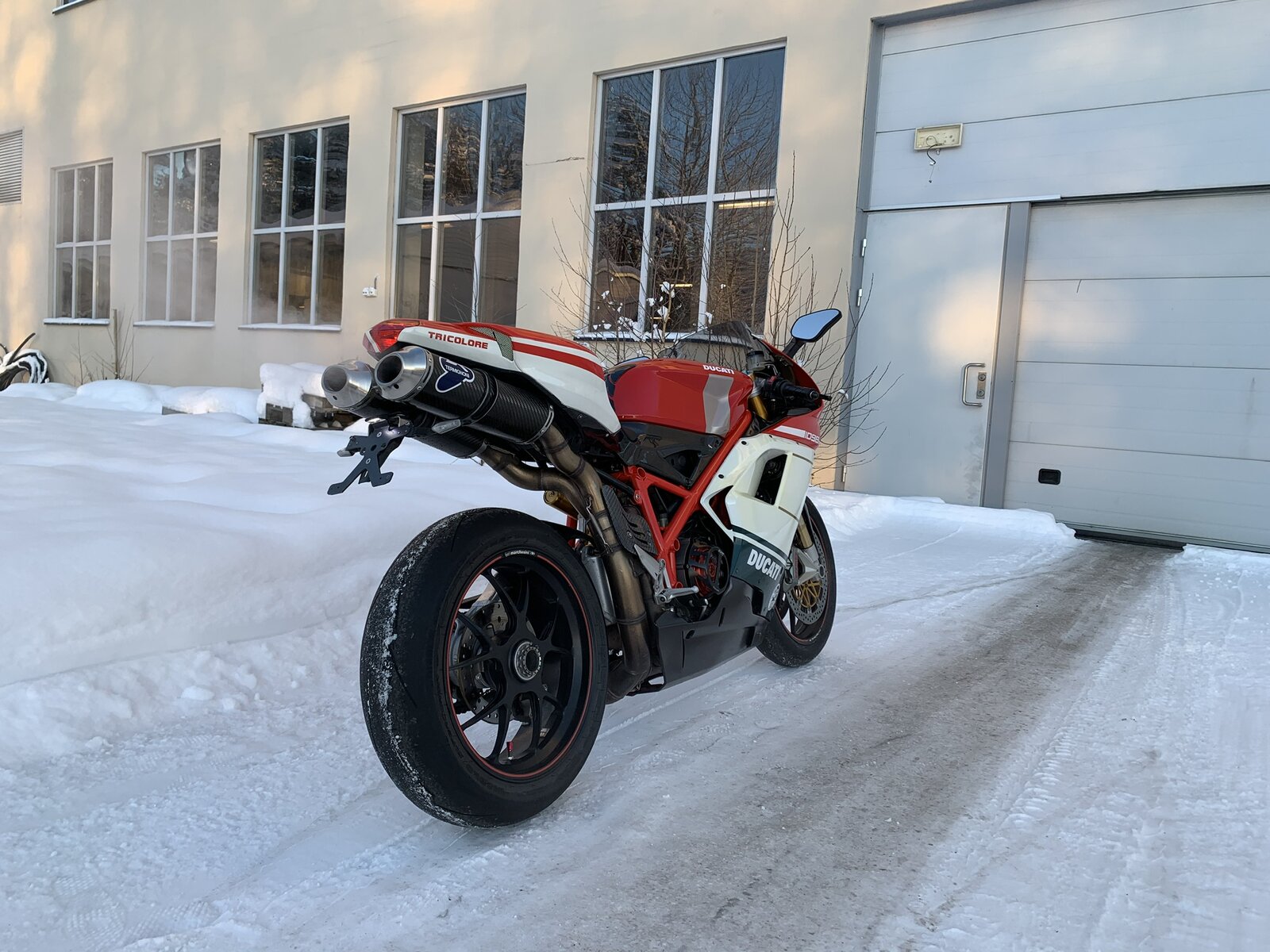

  1. I recently bought a 2007 1098s with the «old» type of Termi cans. Can I swap my old cans with the «new» slash cut Termi cans like the ones on 1198? Will the slash cut cans fit straight on my old pipes? I believe I have the full system, the dash is showing Racing EVO when the ignition is turned on.

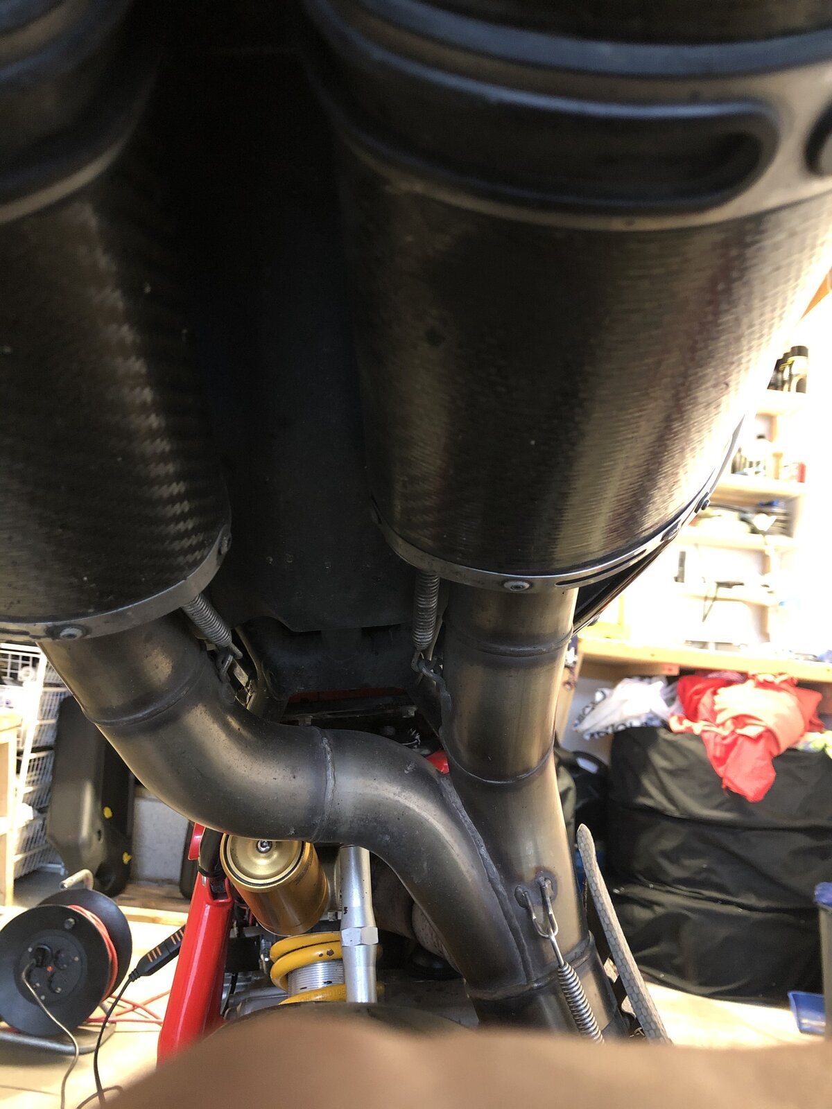

  4. I have measured the outer diameter on the connection between the pipes and the silencers to be around 56mm and the pipes themselves to be around 69mm. Here’s how it looks.
    DBB976AD-03BB-4A3A-A986-542B097CFB95.jpeg 36B06A50-4E21-4FD9-A717-799FB10E7E19.jpeg
  5. That looks like a 70mm system. I believe the spring lugs on slash cut system are on the opposite side to the non slash system.

  7. I think you are right there R (I’m not home) the spring anchors are a bit bespoke to the system they are sold with, bound to be others along to confirm.

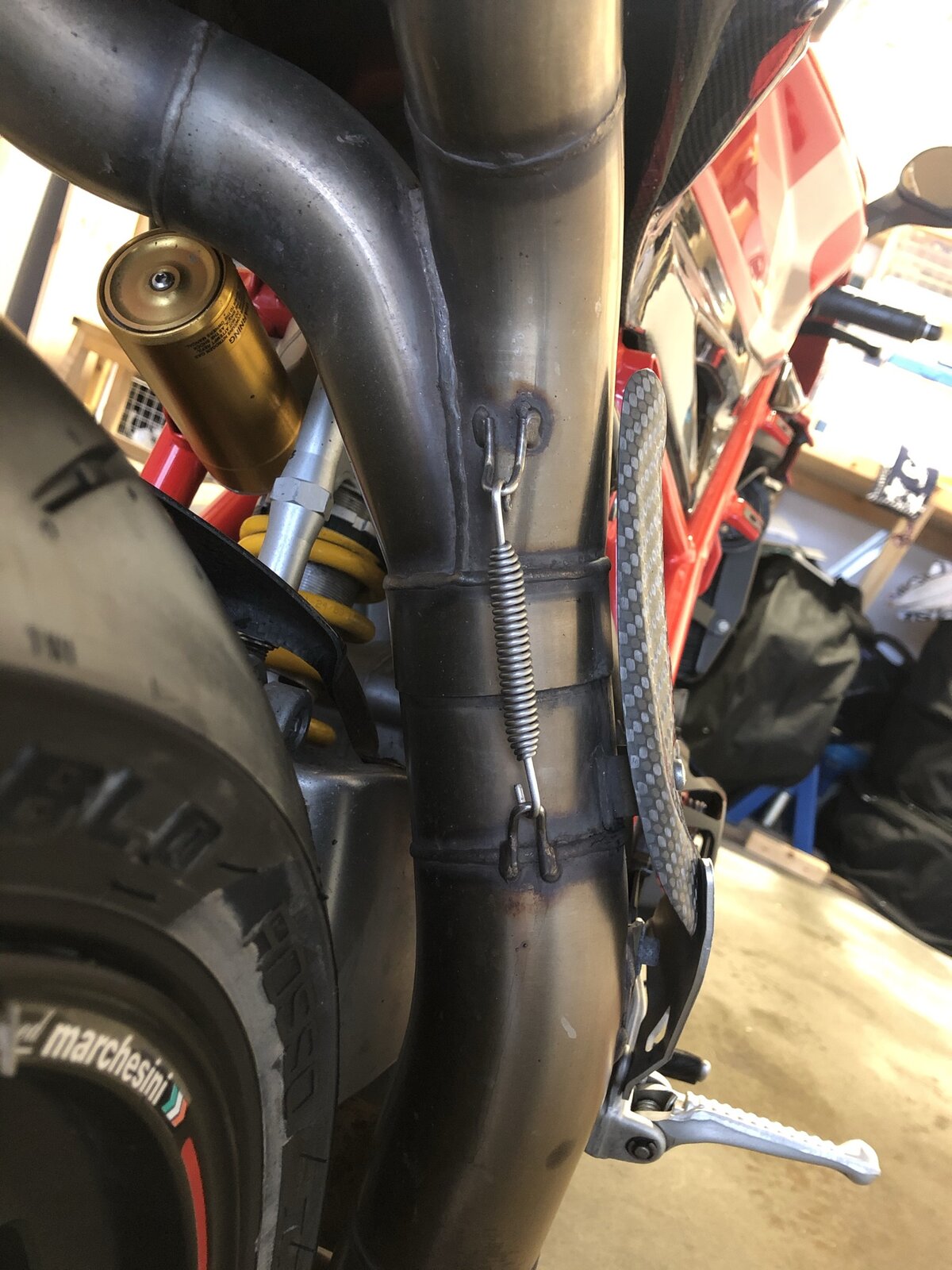

  8. Okay, so not brilliant but
    1098R, 70mm system, slash cut can to adaptor springs facing each other. The black plastic is the seat base.
    and slash cut can adaptor pipe to exhaust pipe
    Andy

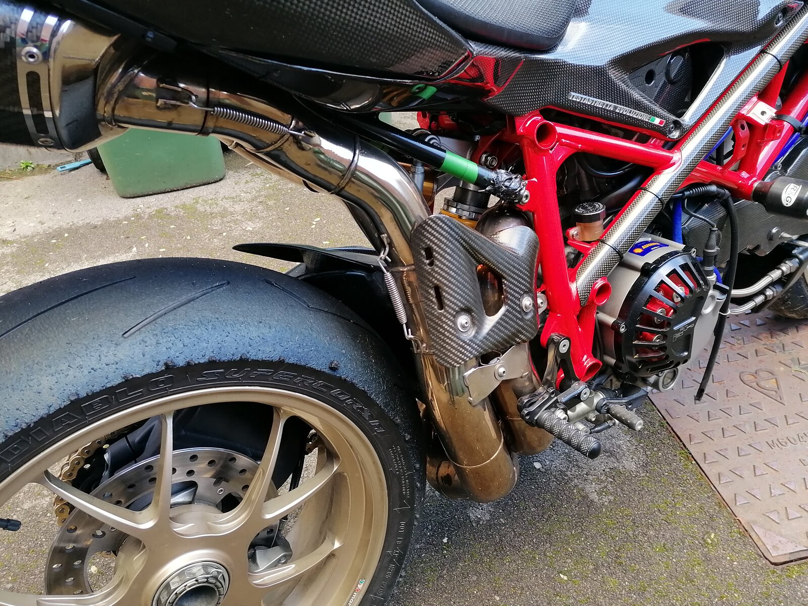

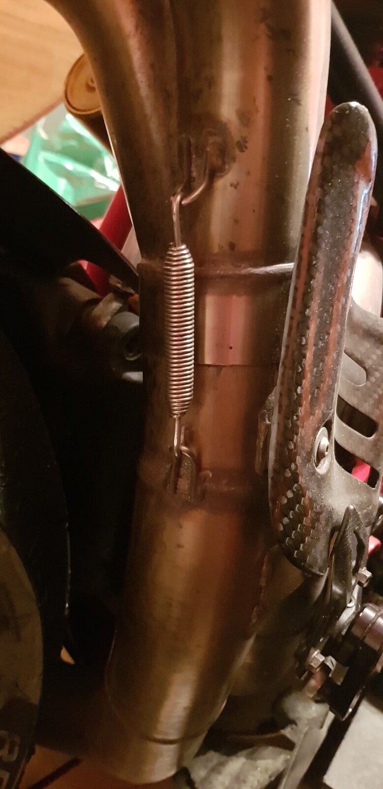

  12. This one from Post No 1 has the springs on the outside.
  13. @RickyX I noticed that too. All my Google searches show the springs on the outside. My system has the springs on the inside. Think I’ll just cancel this project. Thank’s you guys for all your input. Cheers.
  14. When I fitted slash cuts to my 848, as stated above, I had to weld the spring hooks on the opposite side. Easy 5 minute job for someone who can TIG weld.

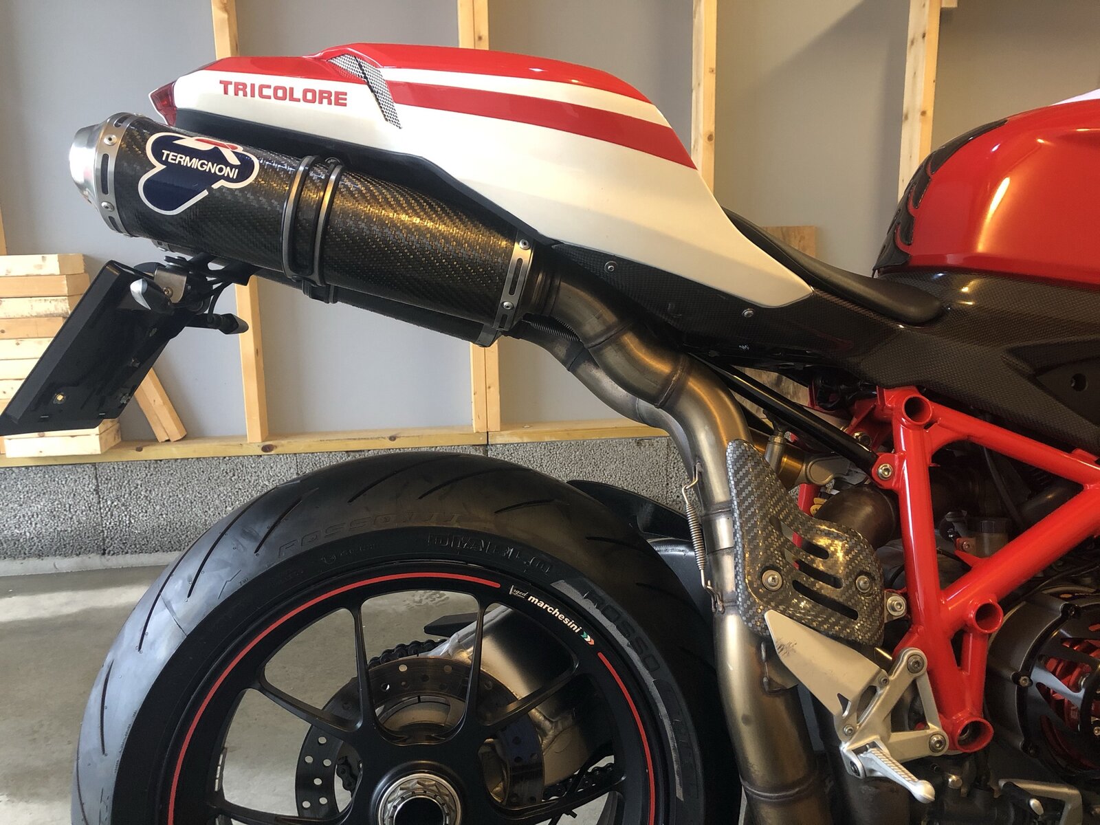

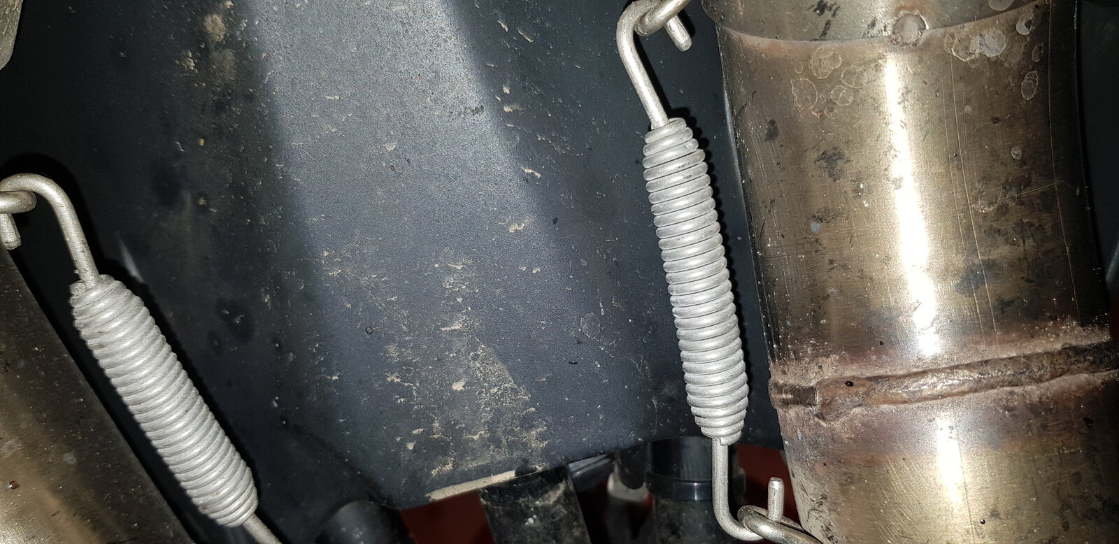

    I will look at mine tomorrow (70mm full system with slash cuts) and let you know.

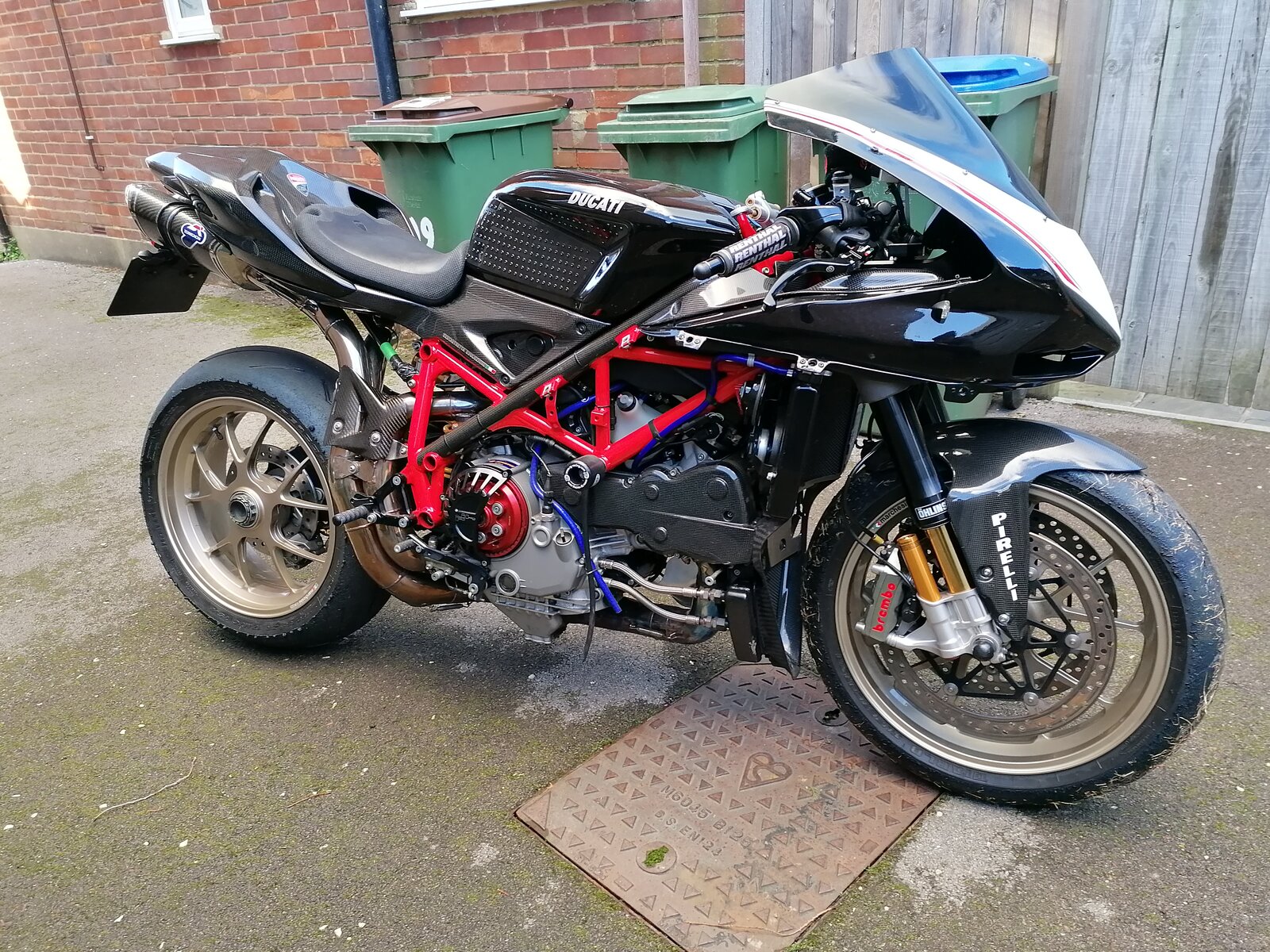

  16. Pic of my 70mm system... Springs on outside.
    Also gratuitous pic of the R as I wheeled it out into the sun...
  17. Wow what a stunning bike.
