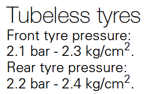

    From the manual....
    2.1bar = 30.5psi
    2.2bar = 32psi
    Oh, nice choice of bike btw. Get some pics up once you've composed yourself. :) :upyeah:

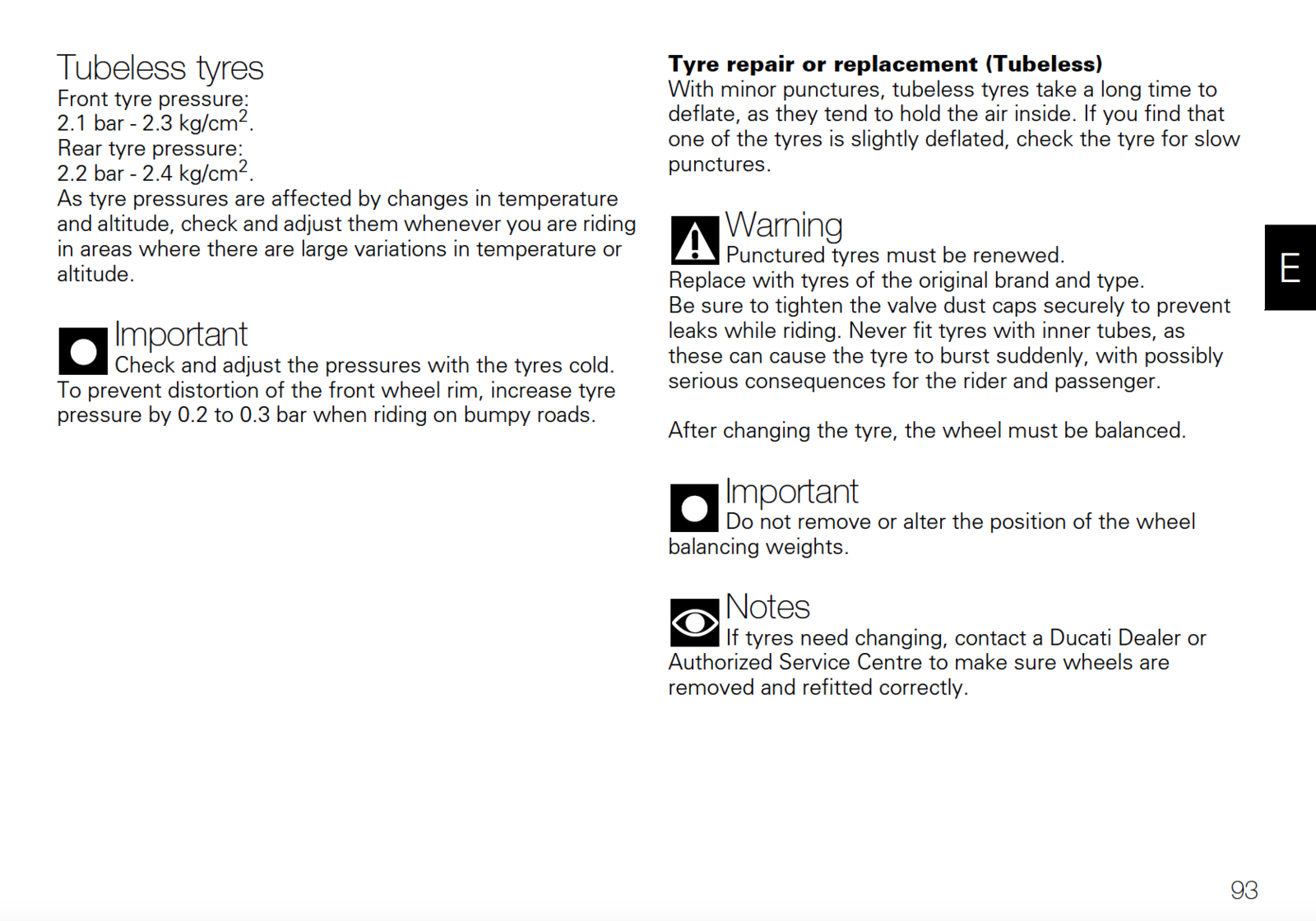

  8. Yep, from the owners manual.

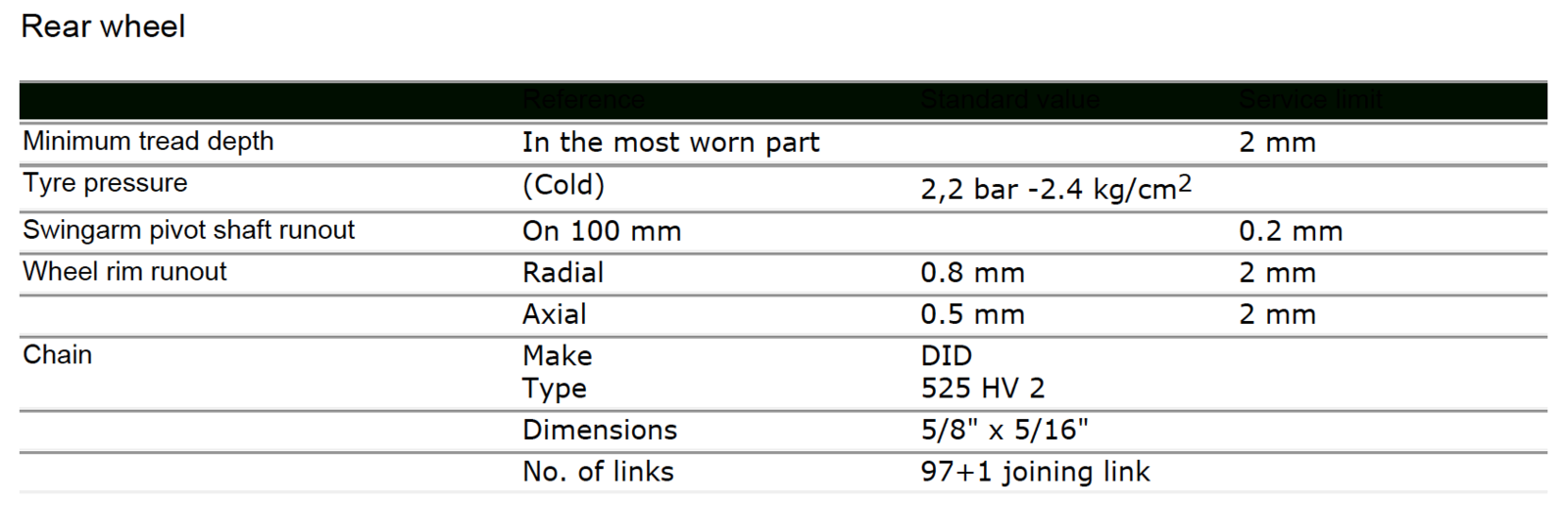

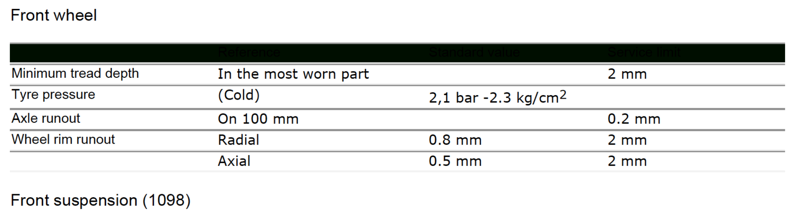

    Confirmed in the workshop manual.

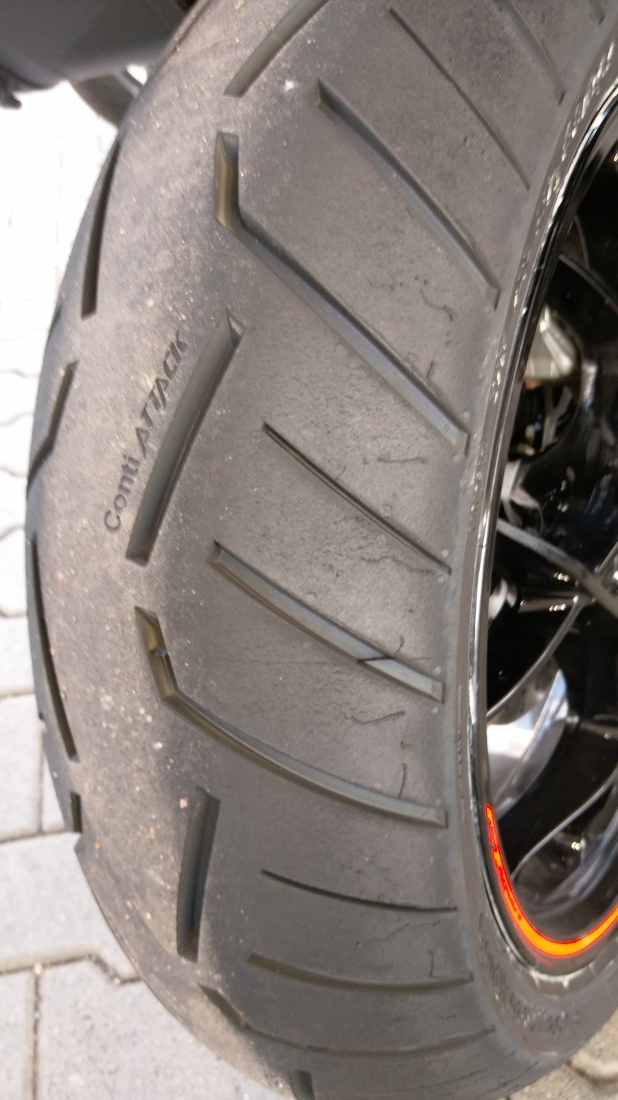

  10. Interesting stuff. So how to interpret this tyre, was on the first day in Germany last year, very hot day with 'good' roads in Eifel Park area. Only had 200miles on it at this point. Thought I could feel its sliding and backed off a bit..maybe it was working as it should?
