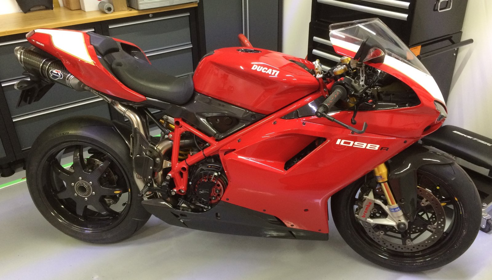

  16. So did anyone make a tally of forum members who own a 1098R ? I would also be interested in what people have changed from the original equipment. Andy
  17. Mmmmmm, nice BSTs. What else did you do ? Andy
  18. Front forks re-valved, reverse shift and rearsets. It don't need much else (if anything). Oh yeah, I put all the carbon bodywork in the garage and replaced it with corse fibreglass (got it way back in 07 when I got the S) - which is just as well because I have binned it in the gravel at least twice :-o
