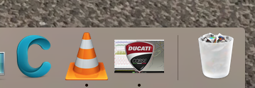

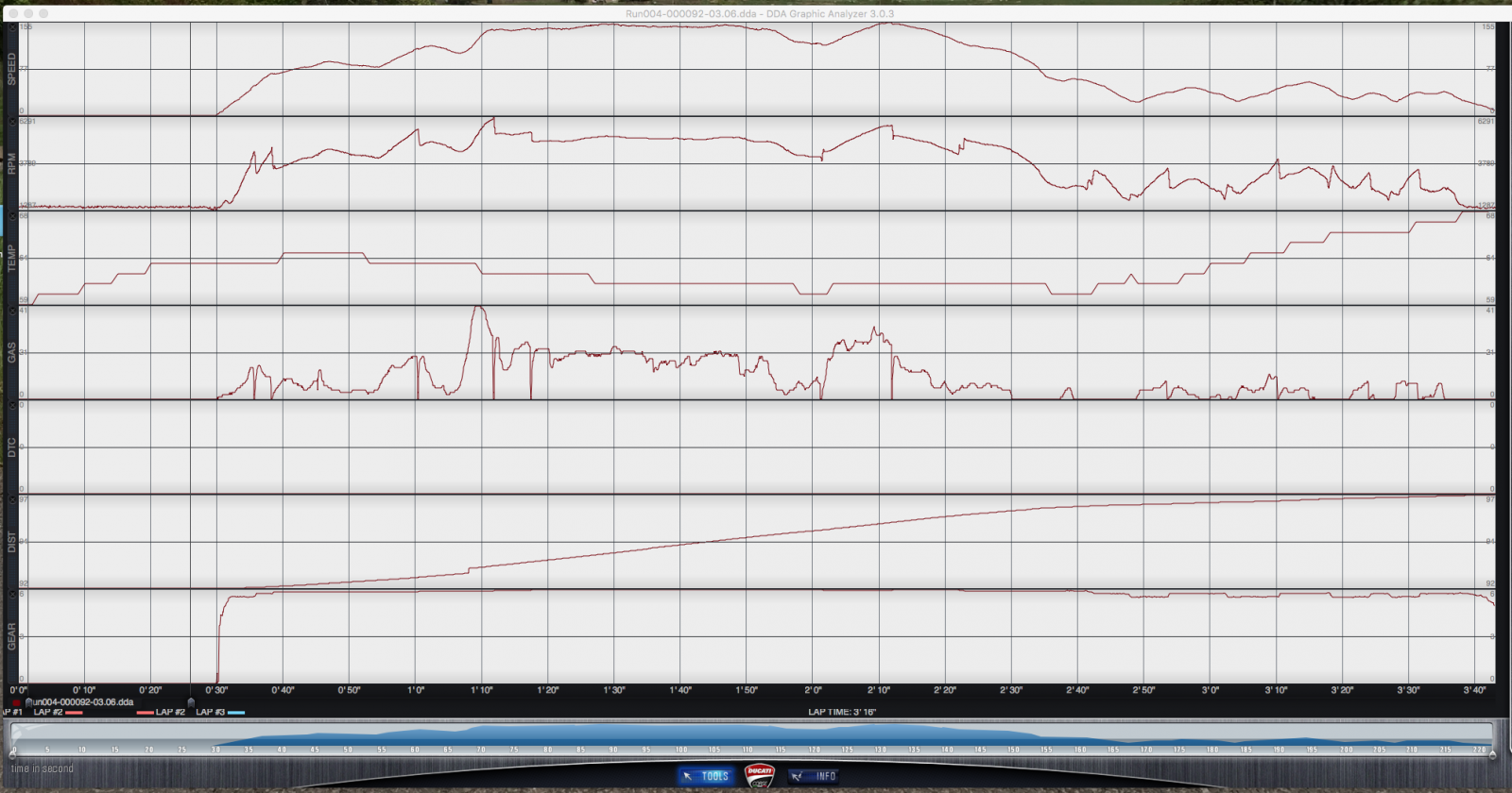

Download the software to your computer. You may need to go onto the DDA site to download the latest version. Then you have the DDA program (below - on Mac) Turn your DDA on in your clocks and start recording. If I remember correctly flashing the main beam activates the DDA and each subsequent flash starts a new lap. Here is what I got when I took mine round the block to try it out, but normally I don't use it much. It monitors speed, RPM, distance, throttle position, engine temp, traction control & gear.
