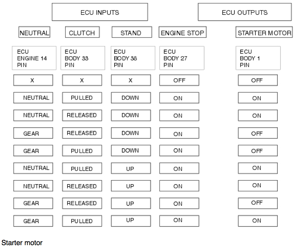

  3. Not sure that I qualify as a "clever clogs" but sounds a bit unlikely to me... The only role that I know of for that micro-switch is to determine whether the bike can be started or not, depending on the position of the side stand and whether the bike is in gear or not, as in the attached schematic.
    If you disconnect and/or short out the switch, do you get full power back?

  11. why does the picture on this post state that
    when in gear, stand up, clutch in, the engine cuts out.
    impossible it would stall the bike every time you tried to change gear
  12. It doesn't - It's showing the "logic" it uses to allow power to the starter motor/solenoid
  13. I assume you're referring to the last to lines? The way I read those is:
    With the bike in gear, clutch released, stand up the starter motor can't be operated​
    If you pull the clutch in, it can.​
    I.e. the last column in the table says whether or not the starter motor will work, not whether the engine will run or not, in other words whether there is an output from the ECU to the starter motor or not.
    I could be wrong though!
    As Tobytyke said!!!
  14. forgetting starting.
    the coloum before states engine shutoff.
    ever put your stand down and you bike cuts out? that thing....
  15. I thought the "Engine Stop" column referred to the position of the kill switch on the right-hand bar, it's "On" in every row except the first. The scenario you describe (engine cuts when in gear and side stand down) is rows 4 and 5, there the starter motor signal is turned off.

  18. in which i would say row 3 is incorrect with
    in gear, clutch released, stand down. engine stop 'on'
    that should turn the engine off.
    the diagram does do explain these bits.
  19. surly thats the engine start, coloum
