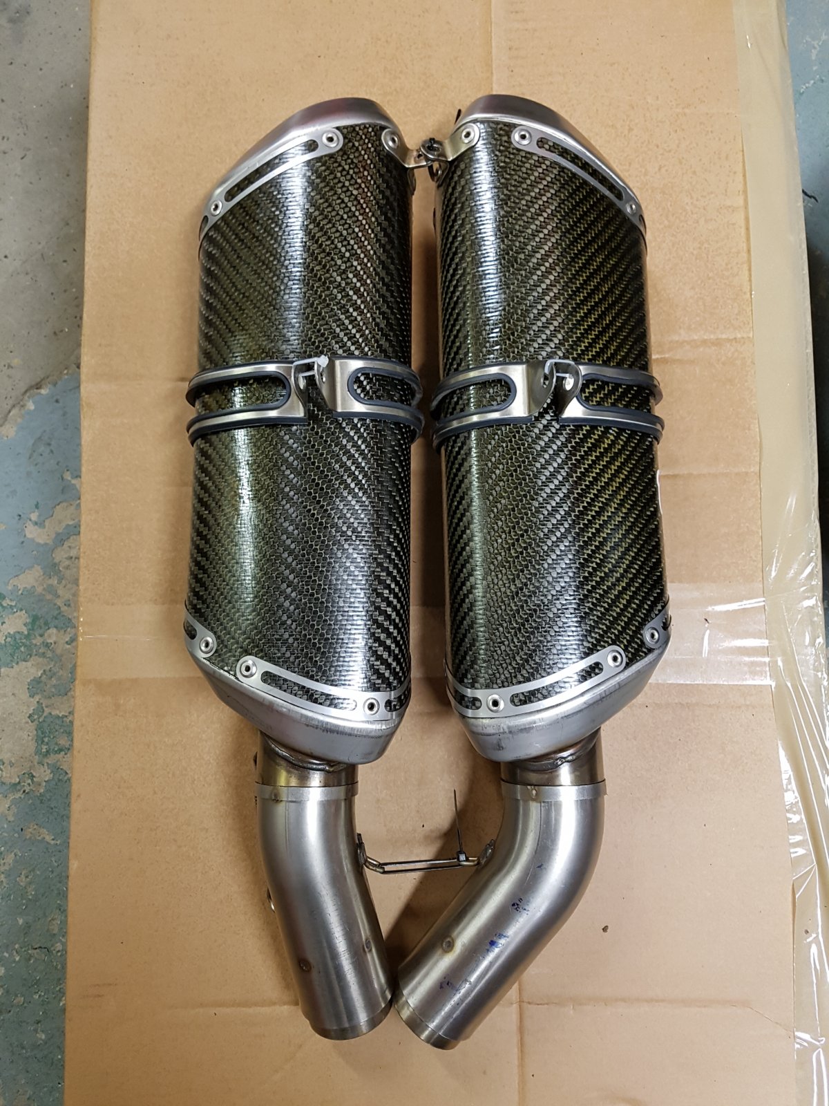

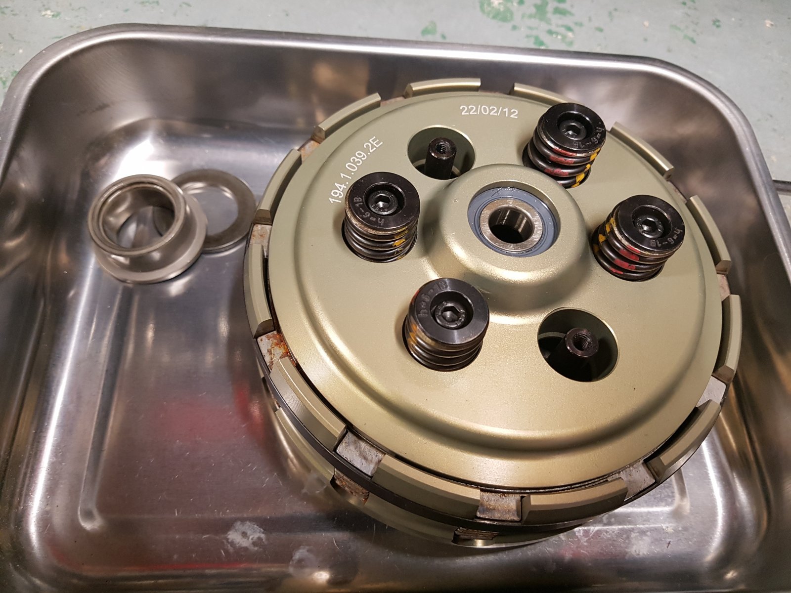

Basically new 1098rs slipper clutch including new rs clutch pack. This is a full kit and every part is ducati corse. Only done 50 miles max from brand new with me. £1000 999/1098/1199/1299 full floating race discs. £400 Brand new ducati corse race screen Has part # not skid Marx copy Only picture I have sorry but can take some of screen it's self if needed. £100 I have other stuff that I will add later Only selling as the bike is now sold. Please don't hesitate to text me on 07534162629 for fastest response. Thank you Luke

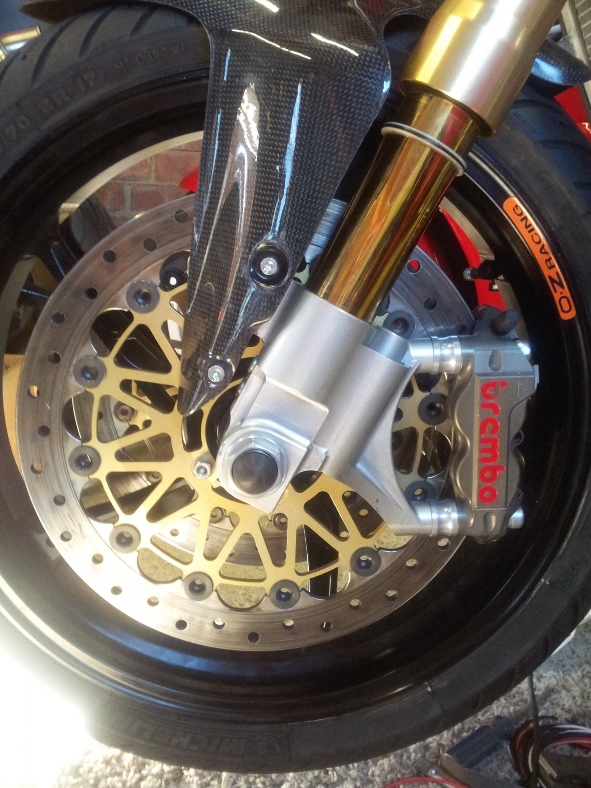

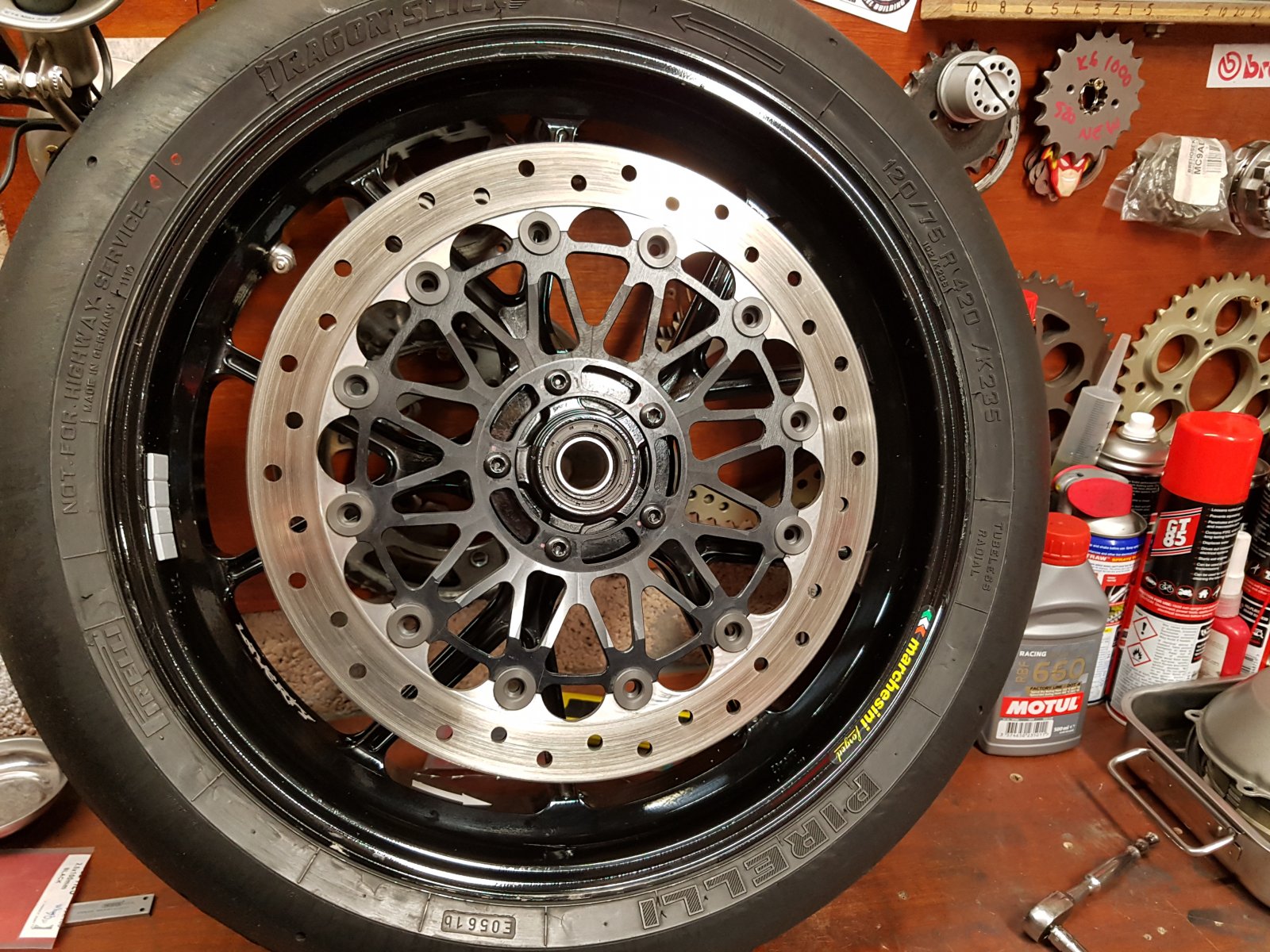

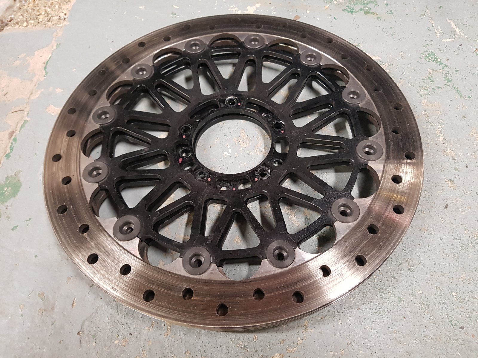

Just to make buyers aware, the 999/1098rs discs are 320mm dia and 6mm thick. You may need to make mods to your bike to fit them. ie caliper internal width. Removal of caliper spacers, or tdc sensor on 1*98 if fitted, or bikes with with 330mm discs. Or even a cheeky thin disc spacer. Although they are 10mm offset, the extra thickness of the disc effectively goes to one side if the disc, not equally across the centre of it's width. Some nice bits Luke. Not trying to derail your sale, just making potential buyers know what to expect. I know what FE went through to fit these RS discs to his project. I will be watching eagerly for your other parts.

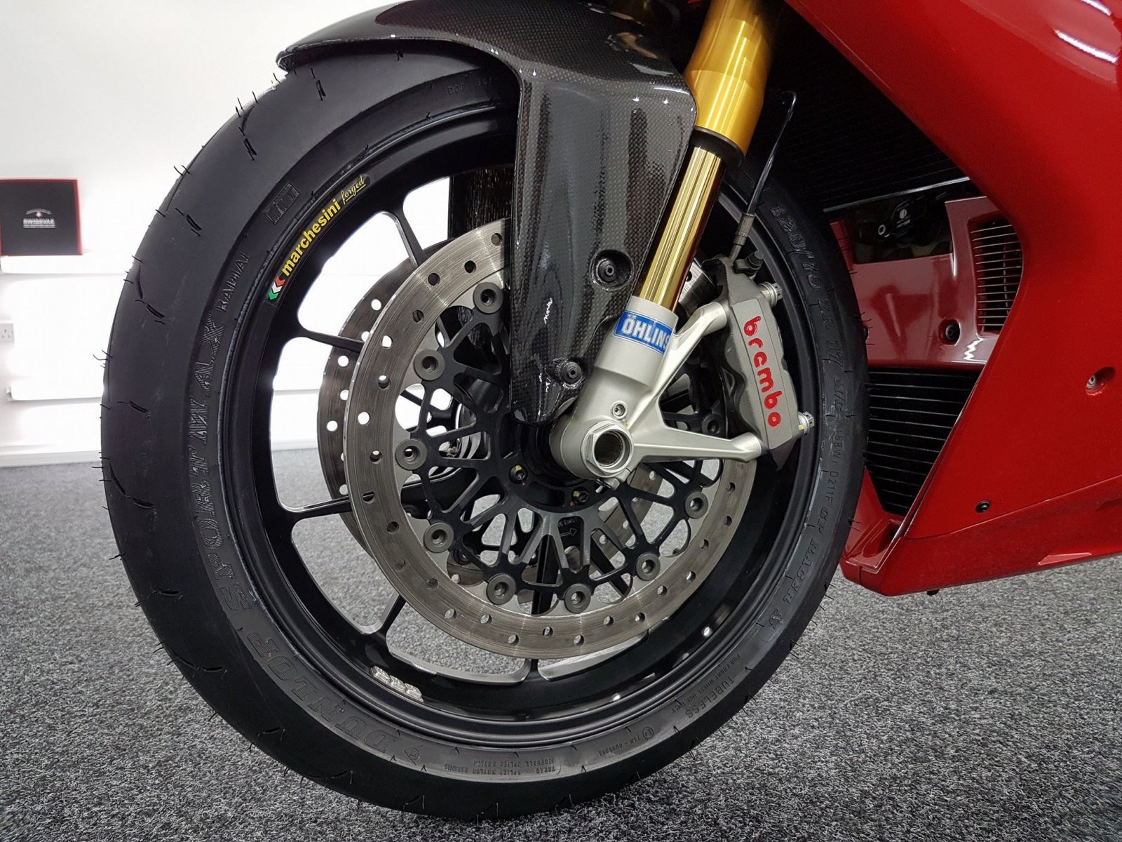

Termis sold.... Discs still available. We're installed on 1199 and 1098 straight fit no issues. Currently using another set on another 1098.
Whatever offset is needed. These are not rs specific discs as they would be 10mm offset. I have these fitted on another 1098 with zero issues and this set has spent time on my panigale and 1098.i also have a friend using same discs on his 1098s with zero issue.a member named Dennie also uses these on 999r.
Apparently the black carriers have the correct offset for street bikes. The ones with a golden carrier have a 10mm offset.
