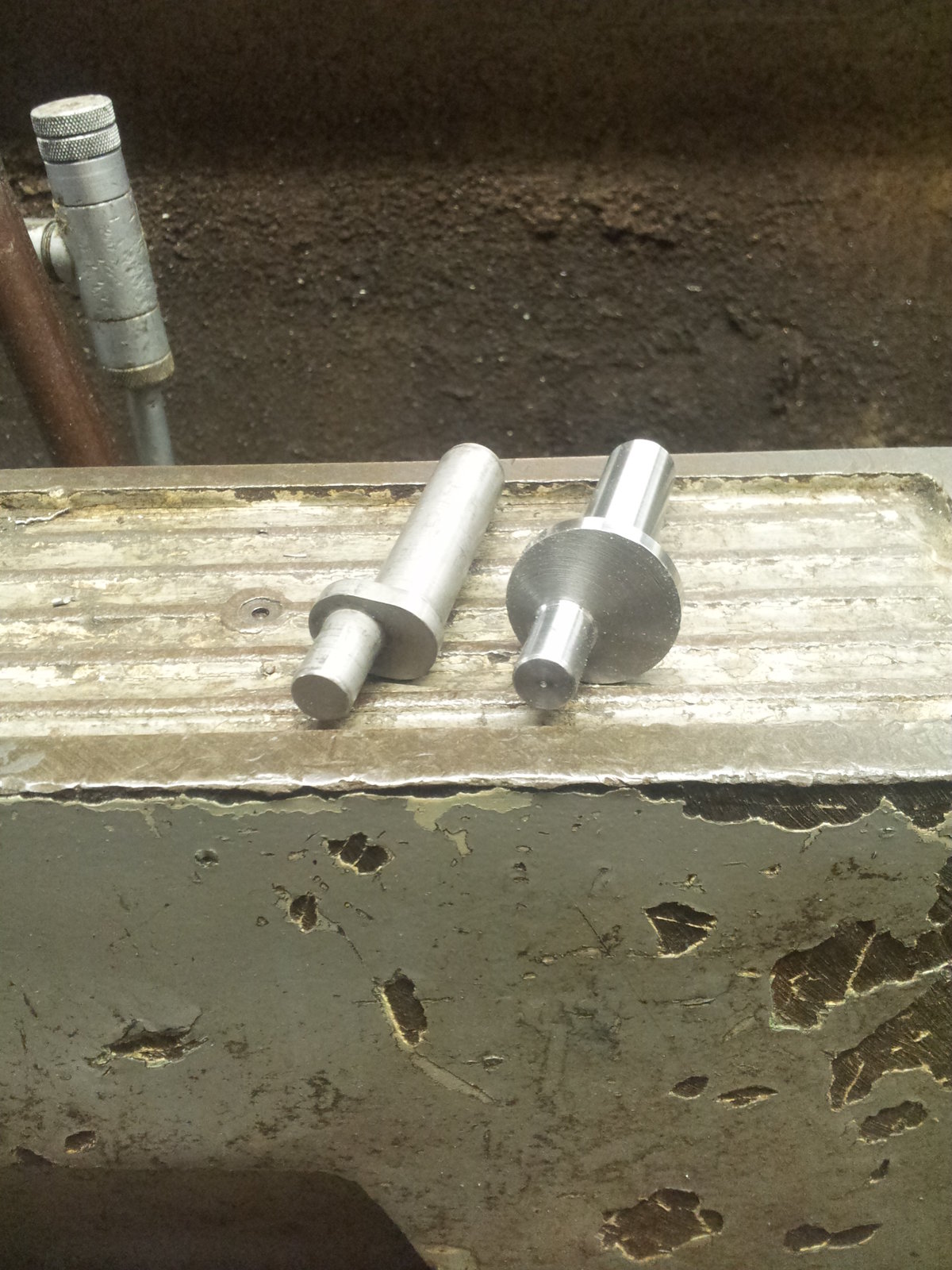

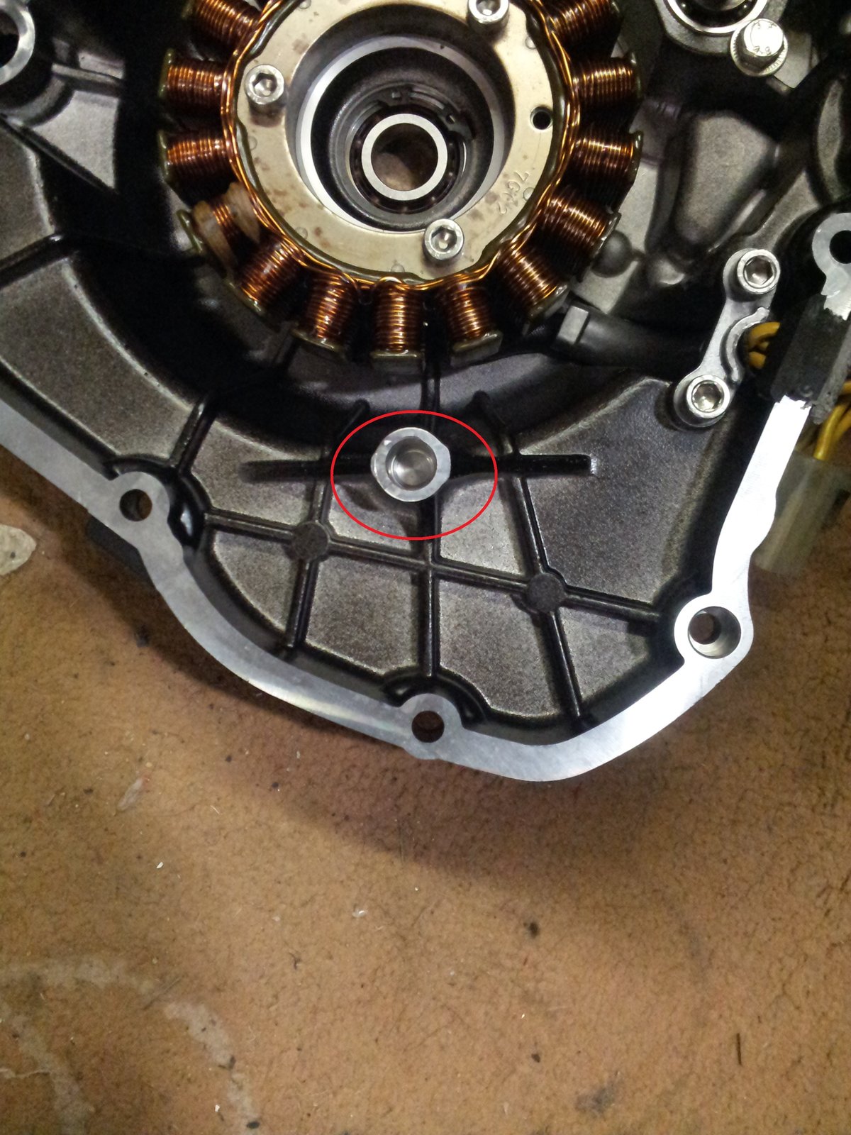

  15. You need an offset pin and a later 1198, 848 Corse alt cover. The later bikes have a longer pin supported by the alt cover. The earlier cases esp. R ones are not compatible with the later cover, as the pin position is in a different position to the later cases.
    These stop in intermediate gear pin from elongating the hole in the crank case, that the pin goes into.
    Due to the unsupported end of the pin and the force put onto the gear.

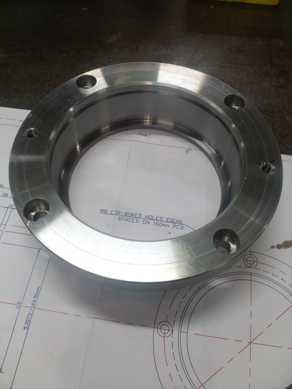

  16. Colchester Lathe?
  17. Good spot..Mascot
