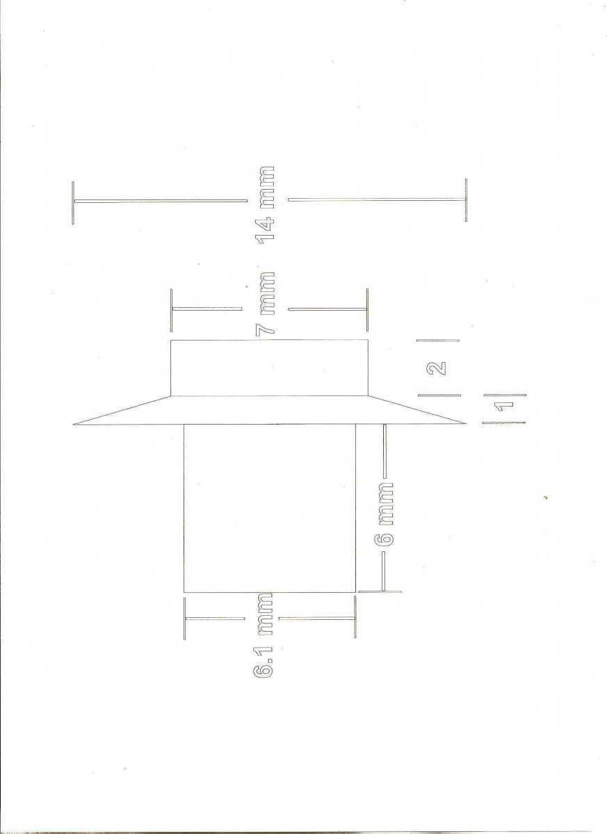

  6. There is a drawing on here somewhere, of the steel pips that can be made and fitted to std discs
  7. just need someone to do it then...
  8. Have some crash bung stuff first :bucktooth:
  9. hurry up!
  10. are you aware of anyone who can do this?
  11. would you happen to have a link?
  12. I have put it up before but cant find it atm.
  13. Here you go..
  14. Perfect. What material? Stainless?
    And spot weld them in?
  15. No: Steel - push fit. Try pushing your old ones out as mentioned above :thinkingface:
  16. nah they are interference fit press in or bradders hammer!
  17. You should just press in. Bit of loctite .
    Stainless might be ok, depends on amount of iron needed for sensor pick up.
    Other than that, plated steel.
