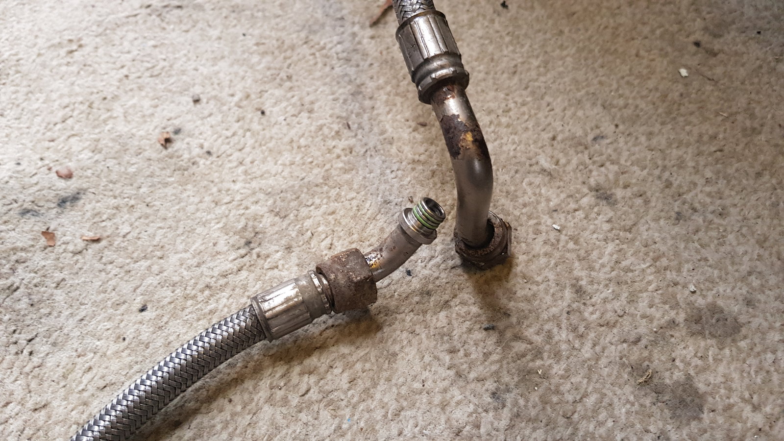

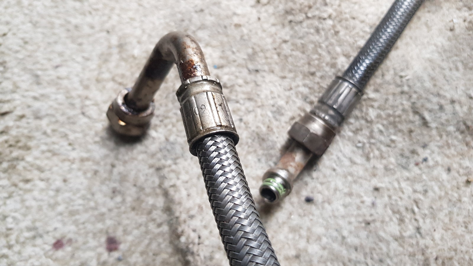

    The original hoses...
    Inspired by stainless but not actually stainless...on a 12k bike that doesn't really see the rain that's pretty shocking...however I can't comment on previous owners though...

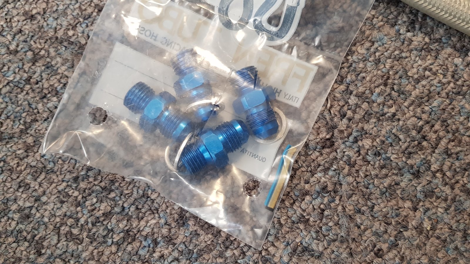

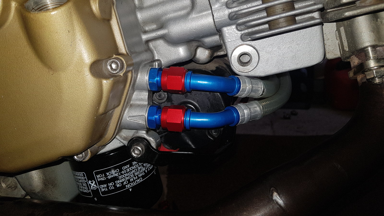

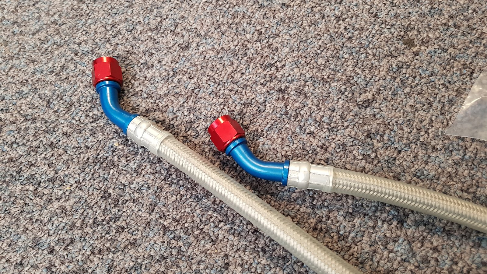

  2. New hoses....bit of a leap of faith. Got them from omnia racing in Italy....before I go any further they fitted...just...illgo into that in a bit...
  3. So. Standard oil change. They state the pressure limit being something like 300 bar but I found my existing lines weren't that tight....I'd hazard about 25 to 30nm at a rough guess...everything came apart fine...

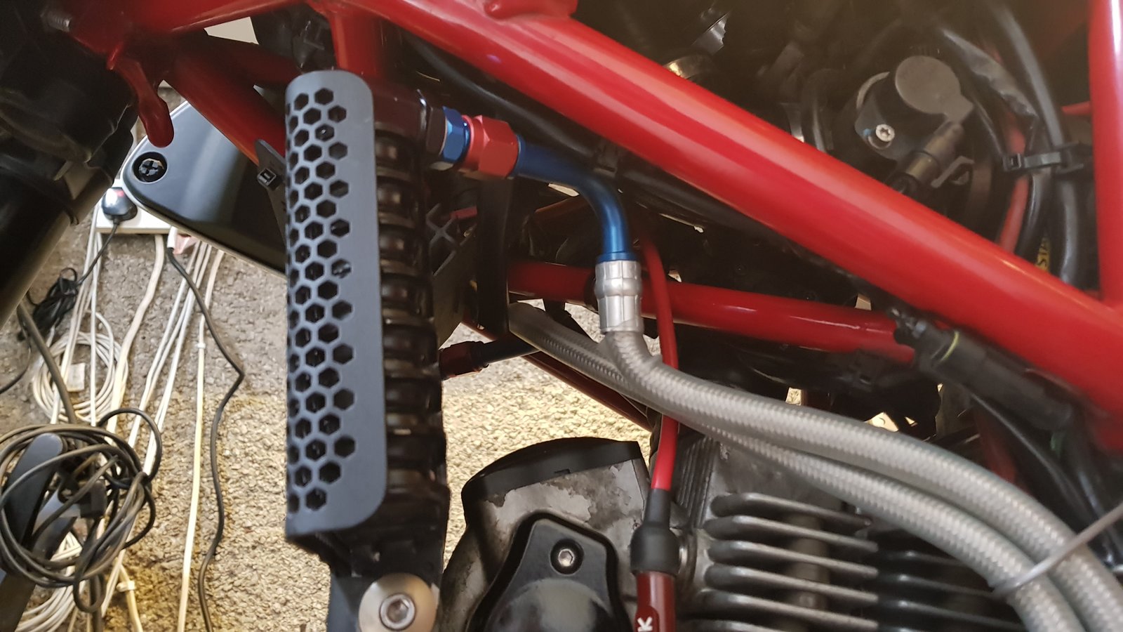

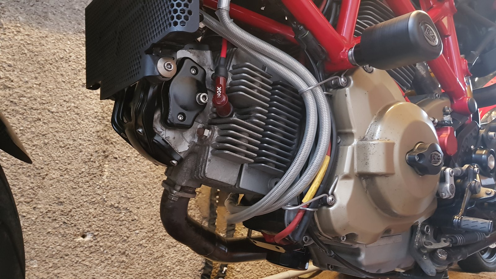

    Routed the hoses the same way as before...they were a bit shorter though so...not so good in one way as they don't go through the lower guide but, because they are shorter they follow the engine a bit more closely...
    So you can make your minds up yourselves...

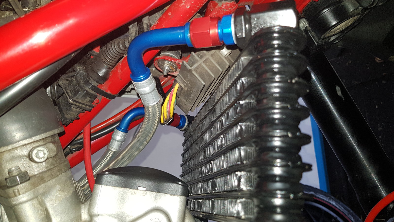

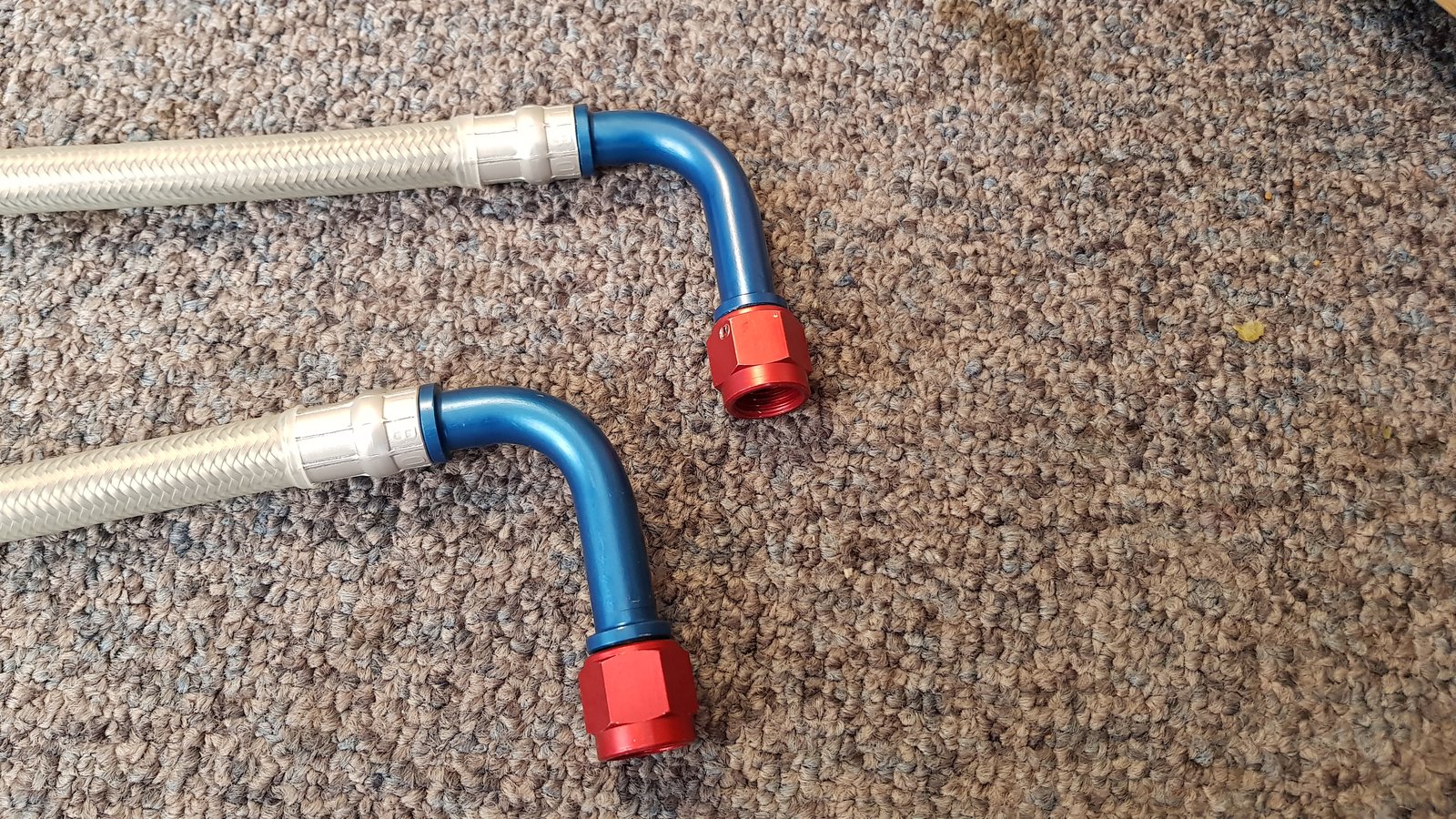

  4. The fittings on the red end could do with being 45deg instead of 90....but...they still fit...
  5. The bottom fixings again could do with being a tad shallower again, they miss, but a bit shallower...

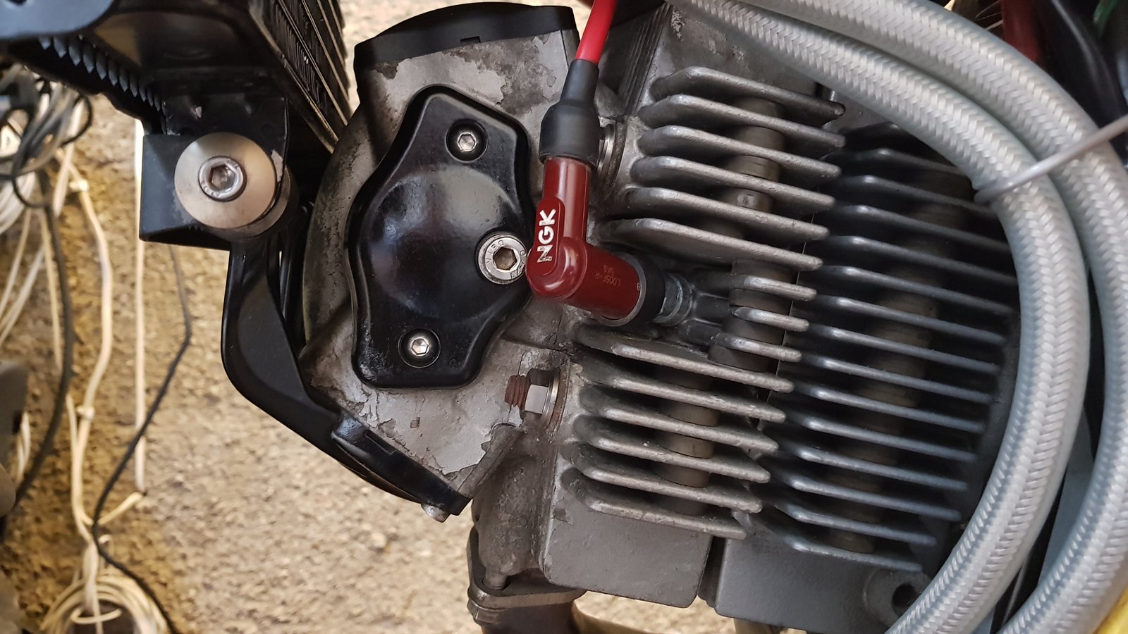

  7. Next job will be remocing the front barrell and getting it recoated in something that doesnt peel off in strong sunlight...look at that shit...

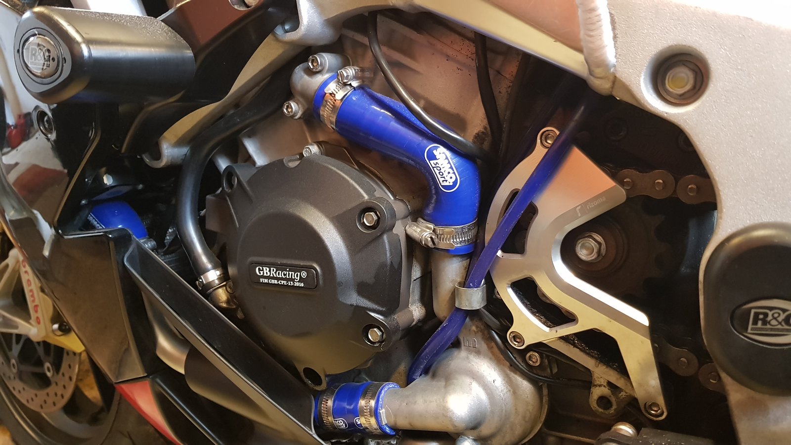

    And there's my rsv4 a year older with the same mileage...
    Granted that a side shot but it's pretty well the same all round...
  8. Is the RSV4 actually painted?
    There’s a school of thought that bare metal is better
  9. Well...no but it's not tarnished either but the water hose cover is and that fine, plus hardly any of the bolts have rusted and a lot of them were stainless to start with.

  11. Going to be honest here Comfy,i would take them off and return them the fit is awful and they upset my colour blindness.
  12. Well...I'm OK with them as the right angles are underneath and you can't really see them plus I like the fact they are a little tighter.... Colour wise I'm not really that bothered on top of that they look way better than the stock hoses.....the other thing is I've now fitted them so that might be difficult along with the language barrier....

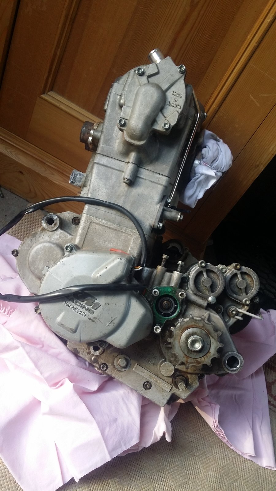

  14. Just catching up (work has been over the top this last week or so) @Old rider you say that but my KTM motor was bare metal and that was shocking but I think it depends on the finish and grade/type of metal.....here's the KTM...70 hours on the clock at this point...
    And that's after its been sdoc'd and scrubbed. I know its a bit anal but its just gets on my nerves that usually the bits of a bike are the most exposed the less attention it gets and it doesn't matter how much you spent either (on the initial purchase) and the cost to protect said areas is quite minimal. But for example to sort that from cylinder out will be a fairc bit of work...
  15. Not been in the garage since I fitted them but....apart from the length which I'm neither here nor there with....I had it in my head the original hoses were 45 degrees at the rad end...they aren't...they are 90deg fittings so, apart from the slightly shorter length they're right....so, while I'm OK with them I think you'd have to literally have the bike there at a fab place to make hoses which are slightly different...
  16. I hadn't read the last post, but looking at the pictures, I would have gone with the 45 degrees coming off the cooler and the 90's down at the engine. The extended length of the 90 fittings, look like they are to clear the starter and bring the lines across parallel with the starter body. They'd run in the lower guide then. The kink in the LH cooler pipe, near the union, looks "awkward"
  17. Hmmm...good point....sure they went round the other way....it was a day of interruptions...
