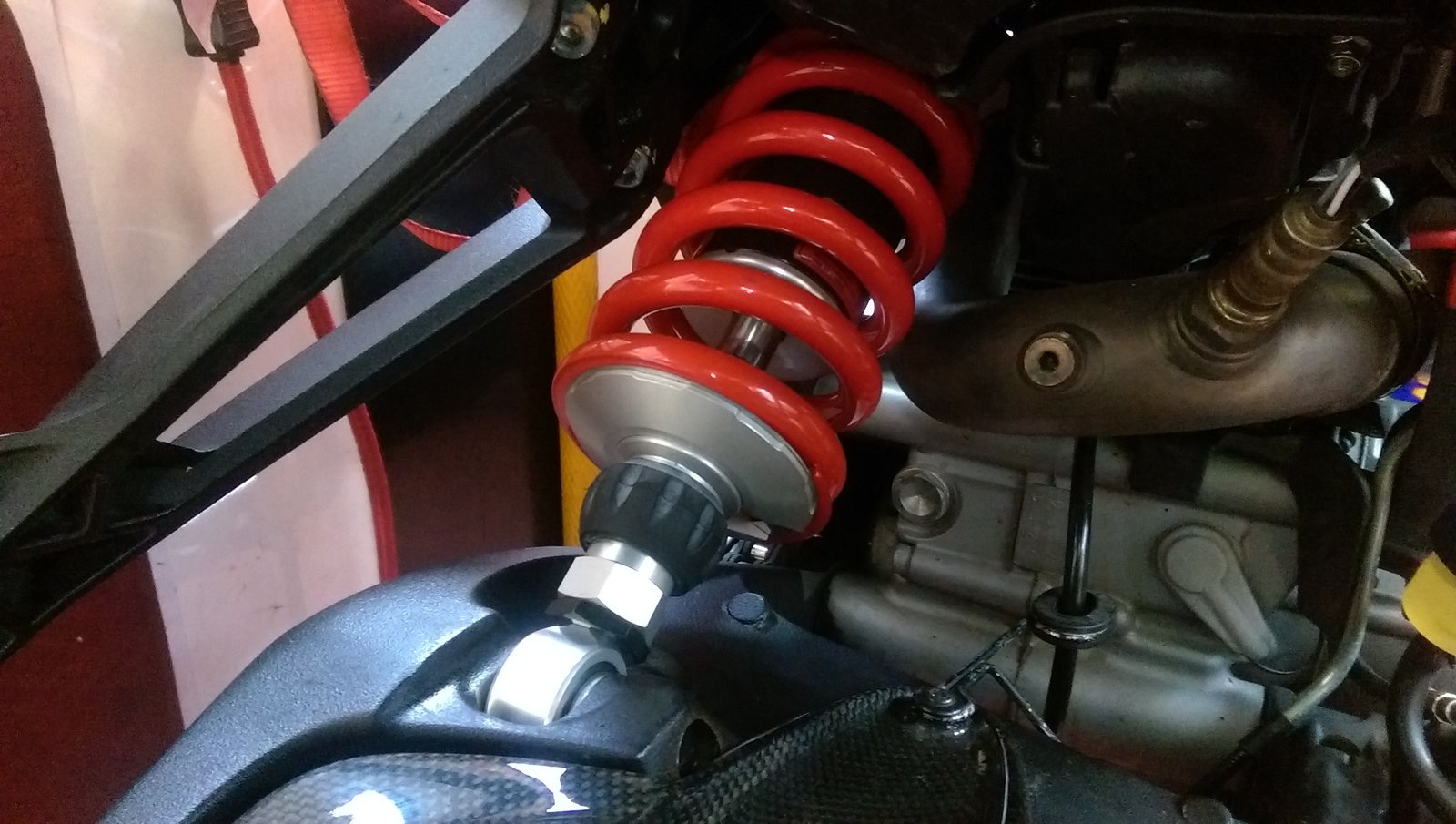

  1. Just fitted a nice new YSS rear shock to my 1100.
    Original was in dire need of service so took the opportunity of fitting this one to see how it goes at the next track day.
    I know an Ohlins, Showa or even Sachs may be better but even second hand ones are much more expensive than this new one.
    More news after the track day.
