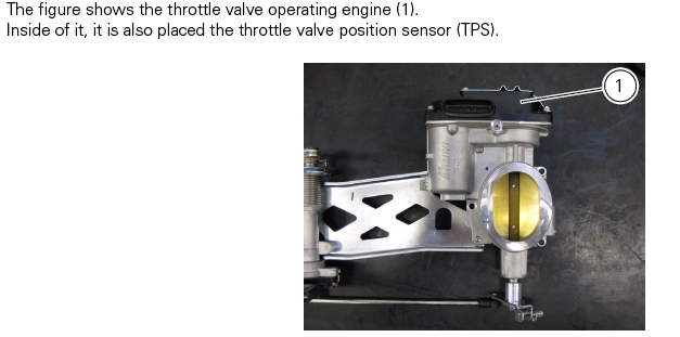

  6. Looking at the MTS manual shows the TPS to be integrated with the RBW throttle servo motor.

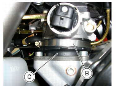

    The TPS from the 1098/1198 appears to be completely different.

  10. The early MTS1200 (top picture in Derek's 27th August 2019 post) uses an integrated unit, as he says, which is available from Ducati only as a complete unit and is very expensive. The Throttle Position Sensor (TPS) is not supplied separately as a Ducati part. However, it is the same as is used for the Mitsubish Lancer or Outlander, part number MR578861. It is easy to obtain and costs about £20. The extra good news is that you can fit it from the right hand side of the bike without removing any of the fairing or tank. 10 minute job.
