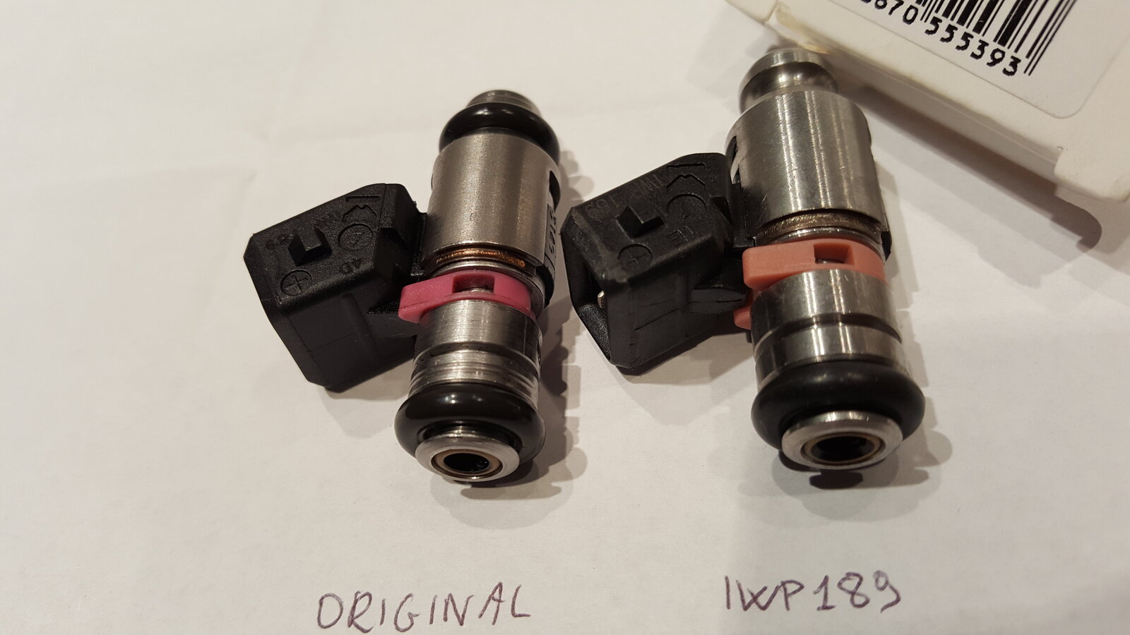

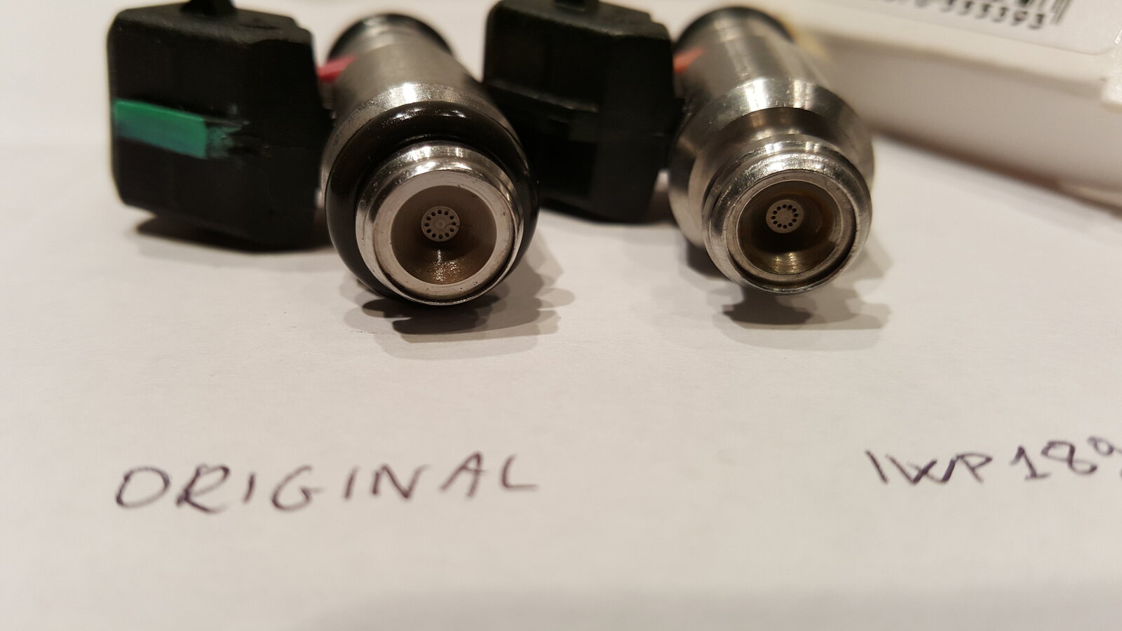

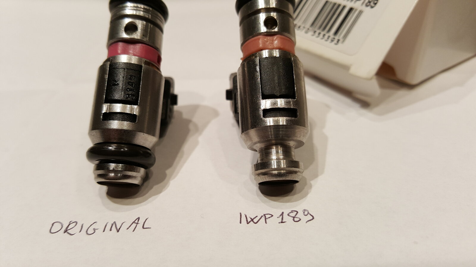

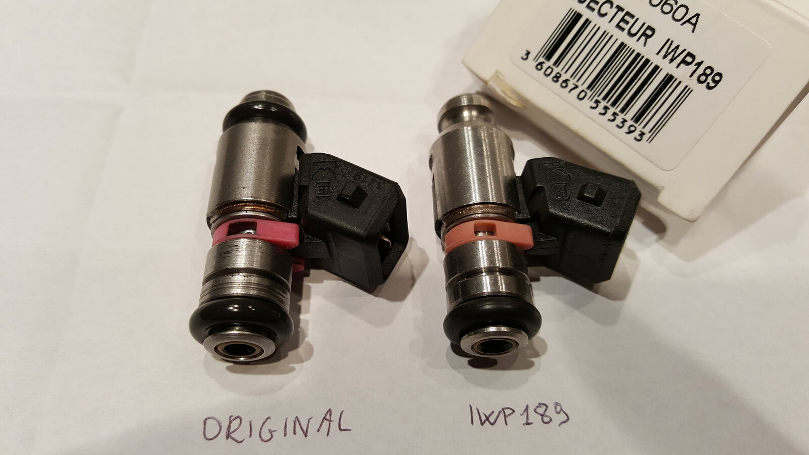

    Finally, it was a faulty injector on the horizontal cylinder!
    I bought a replacement online (type IWP189 -this code is printed on the plastic of the original one) for just ~30EUR instead of the astronomic price of ~300EUR for the original Ducati part.
    The photos below show the original (faulty) injector on the left, and the cheap new one on the right. They are almost identical, but the injector holes are a bit closer on the new one and the plastic has slightly different signs on it.
    Has anybody experience with such cheap injectors? Will they last long, or are they expected to fail soon?
    #6 luke1198, Aug 30, 2020

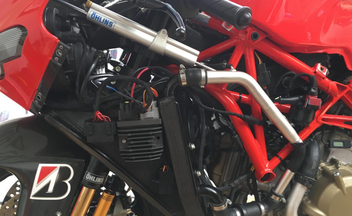

  7. Update: the problem has returned, and hence the cause was not the injector of the horizontal cylinder as I wrongly stated above. The test run which let me think that everything was OK lasted only five minutes (because of heavy rain). During a longer drive this week the problem reappeared. :mad:
    I am now suspecting a faulty regulator/rectifier ("regrec"), which I had to replace already once.
    What makes me think so are the following hints:
    * Before the five-minutes successful test ride I had charged the battery with an external charger.
    * Checking the ECU for errors (after the reset described above) produced a long list of new errors which make no sense at all to me (like P0115: too high, P0335: no signal, P0230: no signal, P0120: too high, P0505: no signal, P0120: too low). This may be due to under-voltages of the ECU (low voltages cause digital circuits to produce random errors).
    * After re-charging the battery and disconnecting the regulator I could make a new 5 minutes test ride without any problems.
    * The first time that the problem became very serious was shortly after a long break at a fuel station: when the bike is parked the regrec, which sits just above an exhaust pipe, can be invested by very hot air from the pipe and cook, I guess. Btw: it took so long because the fuel station was almost empty (the car before could not even tank) which led me to think having tanked dirty fuel, and hence having a problem on the fuel delivery line.
    * The engine was cutting more often at higher revs, where the alternator produces higher voltages and could disturb more almost-blown diodes/transistors in the regrec.
    My current hypothesis is that the regrec produces at random times quick short-circuits (too short to be detected by a household voltmeter) lowering the voltage below what the ECU requires to function properly.
    I ordered now an oversized regrec (an FH012AA), but unfortunately not produced by the Japanese Shindengen (too pricey). I will move the regrec to a cooler location similarly to what described in https://www.ducatiforum.co.uk/threads/mosfet-regulator-installation.68657/ . However, I will place it under the left fairing ahead of the radiator, next to the fork (as inspired by the image below). I will then report.
    #7 luke1198, Sep 6, 2020

    Also the first time that my regreg died the dash stayed on, but the "motorcycle diagnostics" light (orange) turned on. The failure of the regrec was however much more sudden and violent than this time (assuming that also this time the regrec has failed -which I do not know yet since the new one did not arrive yet). Back then I attributed the failure of the regrect to the newly installed lithium battery.
    Did you experience similar problems?
