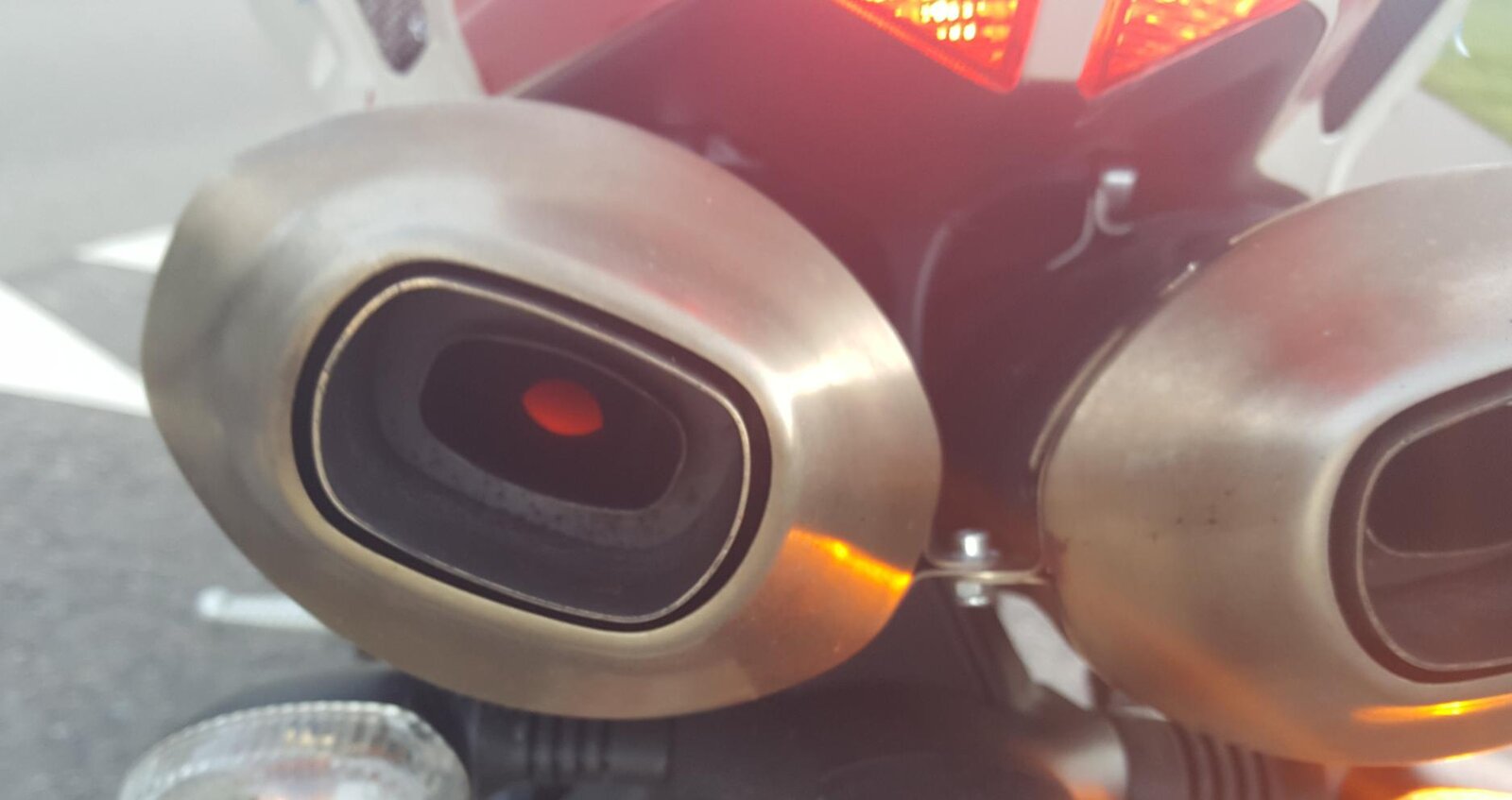

  14. Recently, while debugging my 1198 engine which was randomly cutting and/or running rough (https://www.ducatiforum.co.uk/threads/1198-engine-cutting-out-randomly.80667/), I disconnected one of the ignition coils trying to understand if the problem was affecting a single cylinder or both. Within a few minutes of drive, this caused lots of unburned fuel to go into the exhaust, where it finally ignited setting up on fire the exhaust. :bomb:Flames and smoke were coming out from the pipes for a few minutes after turning the engine off.
    It finally turned out to be a faulty Throttle Position Sensor (TPS), but then I noticed that I can see through the OEM exhaust the catalytic converter glowing (picture). Right now, I am running an ECU with lambda (O2) sensors disabled.
    * did I damage the exhaust? I cannot remember seeing the catalytic converters before, nor seeing anything glowing.
    * am I running rich? During the debugging phase, in fact, I replaced one injector with a cheap (30EUR) one, and I am afraid it injects too much fuel.
    Can anybody post an image of how an OEM exhaust is supposed to look like after a few minutes drive?

  15. So you rode the bike on one cylinder for a while on purpose.
    Does that not sound like a really bad idea to you?
    Nasher
  16. Honestly it sounded like a genius idea to me at first :joy:
    As somebody said: an Expert is somebody who did all possible mistakes... :poop:
    PS: what other bad things could have happened?
  17. Piston and bore wear
  18. Luke, you asked what other bad things could have happened, and I answered you.
    If the bores are awash with far too much petrol, the thin oil film left on the bore and rings is washed away and you get metal to metal contact leading to very rapid wear. Probably minimal if not done for too long, but like it or not, that is what was happening.
