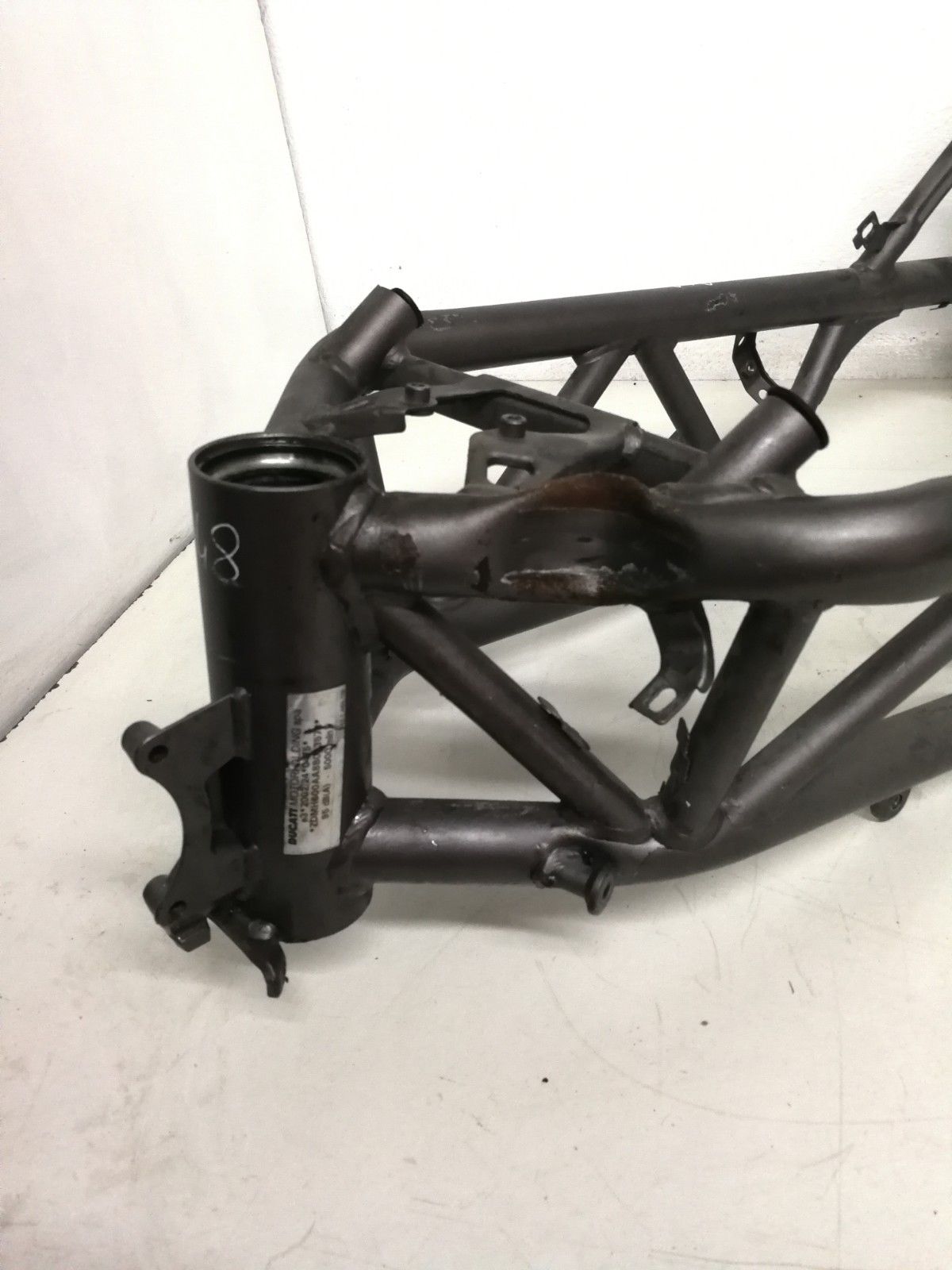

  1. Thinking of selling my 848 for an 1198s. My 848 has 2 tangs coming off the frame as the steering stops, is the 1198 steering stop different? I can't see any steering stops on the 1198.

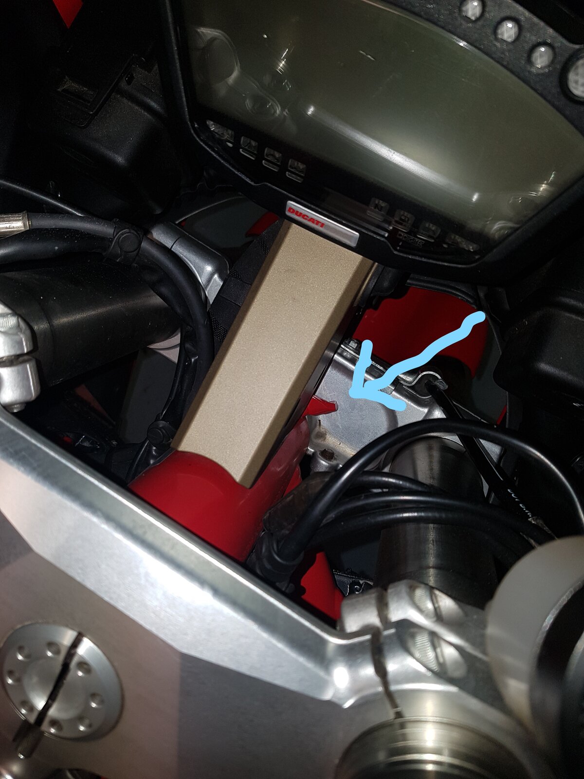

  2. It's central on the front lower of the headstock, with bolt adjustment on the top of the bottom yoke...
  4. Just got some pics from the seller, must be a totally different set up?

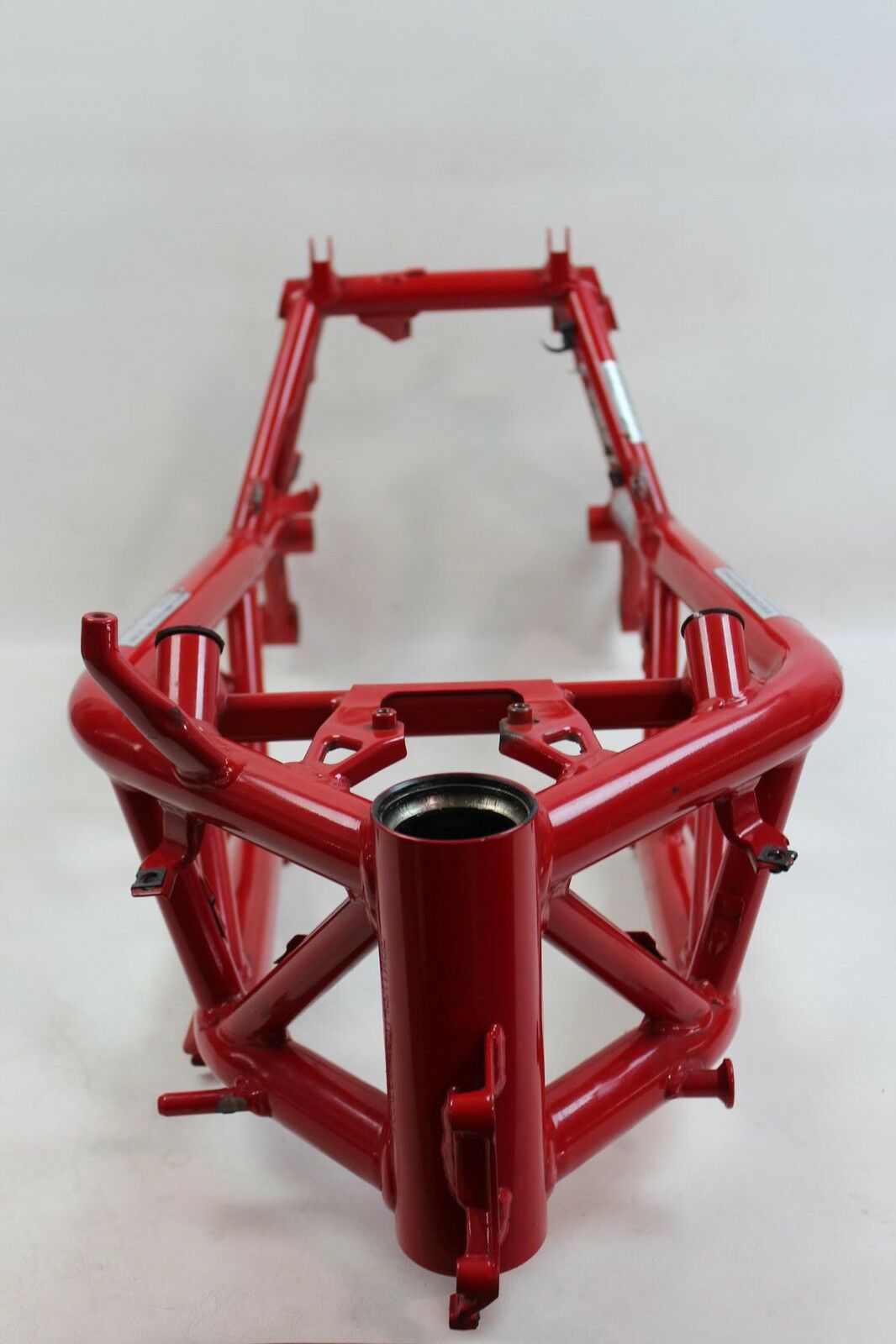

  6. Well similar, mine looks like this (1098R) if you can't see the adjuster screws on the one your looking at something is odd.
  7. looks like they must be different
    1098 and 1198 frames?
    848 frame
  8. is it a black bike? by any chance?
  9. No its a red one, it's not advertised anywhere just someone I know selling one
    Yeah thanks for the pics, thought they had maybe been cut off at first but can see they are totally different now :upyeah:
