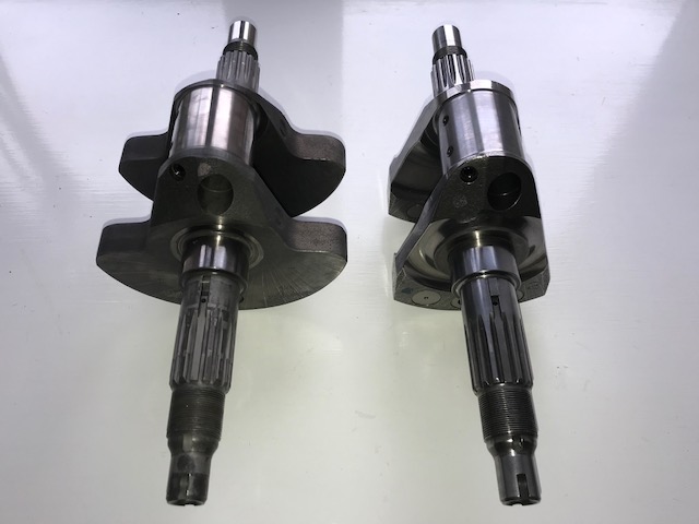

    I have a option on a 1198R crankshaft. I have changed almost everything to R components in the engine. Only the crankshaft is missing. Does this R crankshaft do a big thing instead of the oem crankshaft?
    Thanks for replying!
  2. Yes will be lighter than oem.
  3. but you'll need the r con rods as well or you'll be adding weight to the crank..

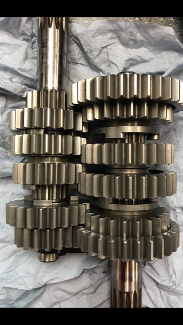

  4. do you have the sand cast crank cases? what gearbox are you using? std?

  7. heres a visual of the difference in size and visible weight let alone the materials they are made from.
  8. a strong 1198 motor bottom end is
    sand cast cases
    10/1198 crank
    1098R rods
    pistols pistons (two ring)
    and i would go for a nova or better value a BSD three dog gearbox whilst you have the crankcases separated!
    and of course the whole thing dynamically balanced...

  11. WoW! That is a big difference! How does it goes on road? It think it will be faster on speed or something?
  12. I am thinking about buying the sand cast casings as well
  13. The 1098r crank will spin a lot quicker, could be a handful on the road
  14. Mine is. :)
  15. especially with a lighter flywheel....:cool: ( ok for the track with a higher idle speed)
  16. around 1600 pounds... a nova is around 2200.
    beautiful piece of engineering!!
  17. I can vouch for the BSD box, super strong, use it with qs and gear changes are slick :upyeah:
