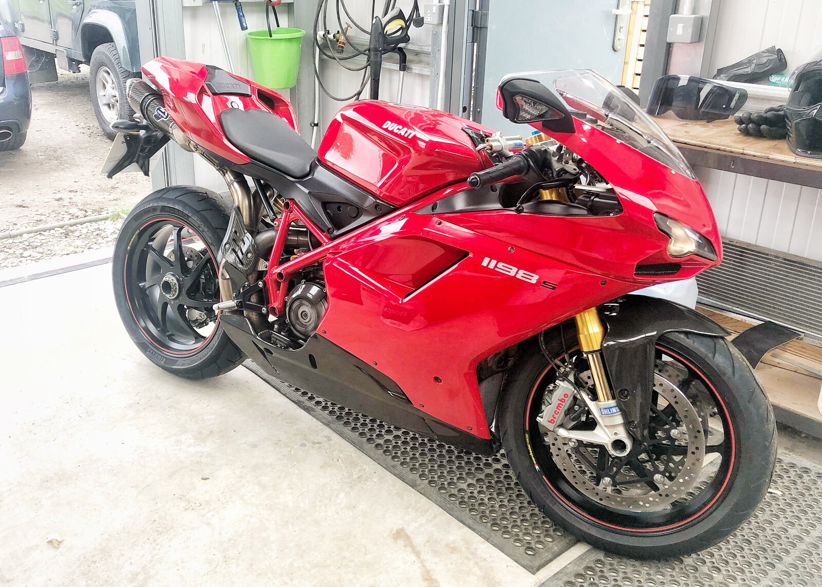

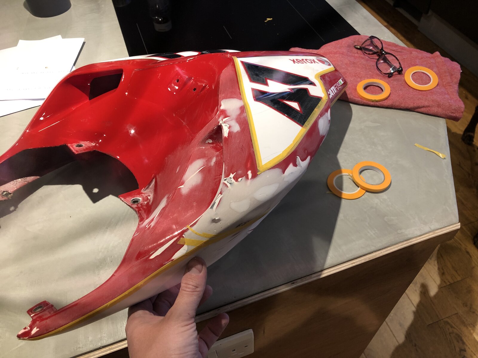

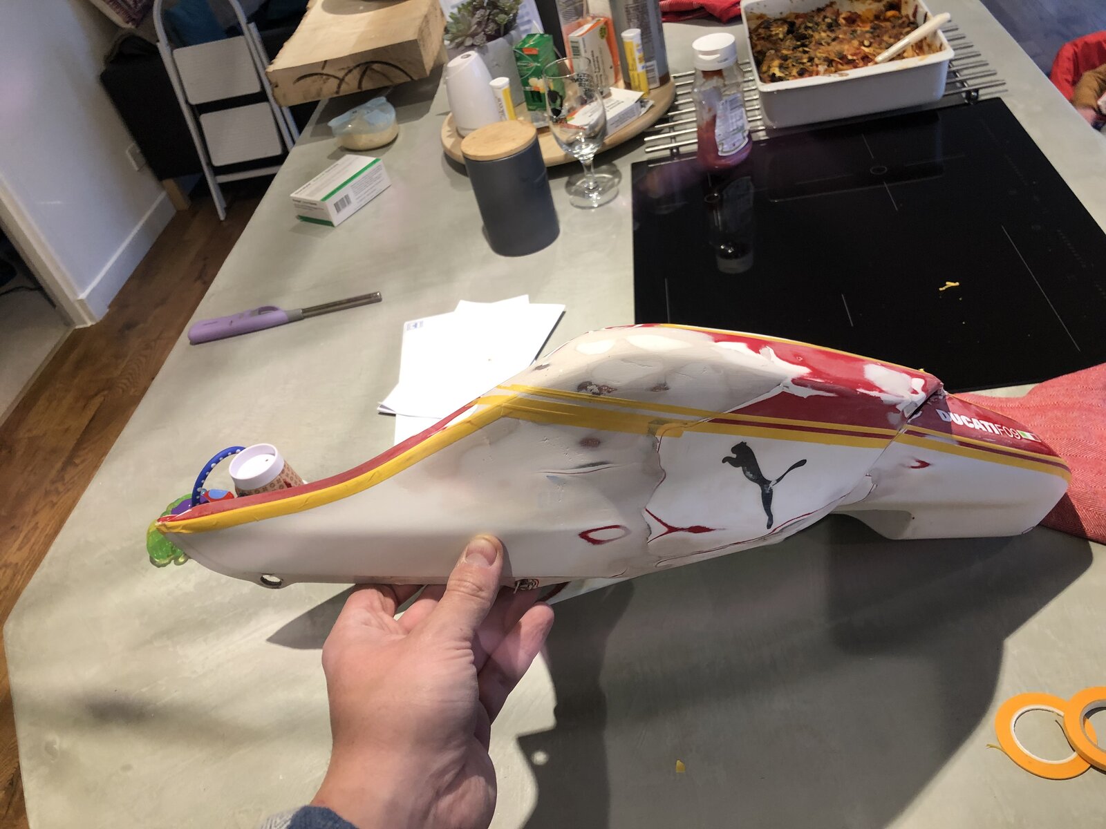

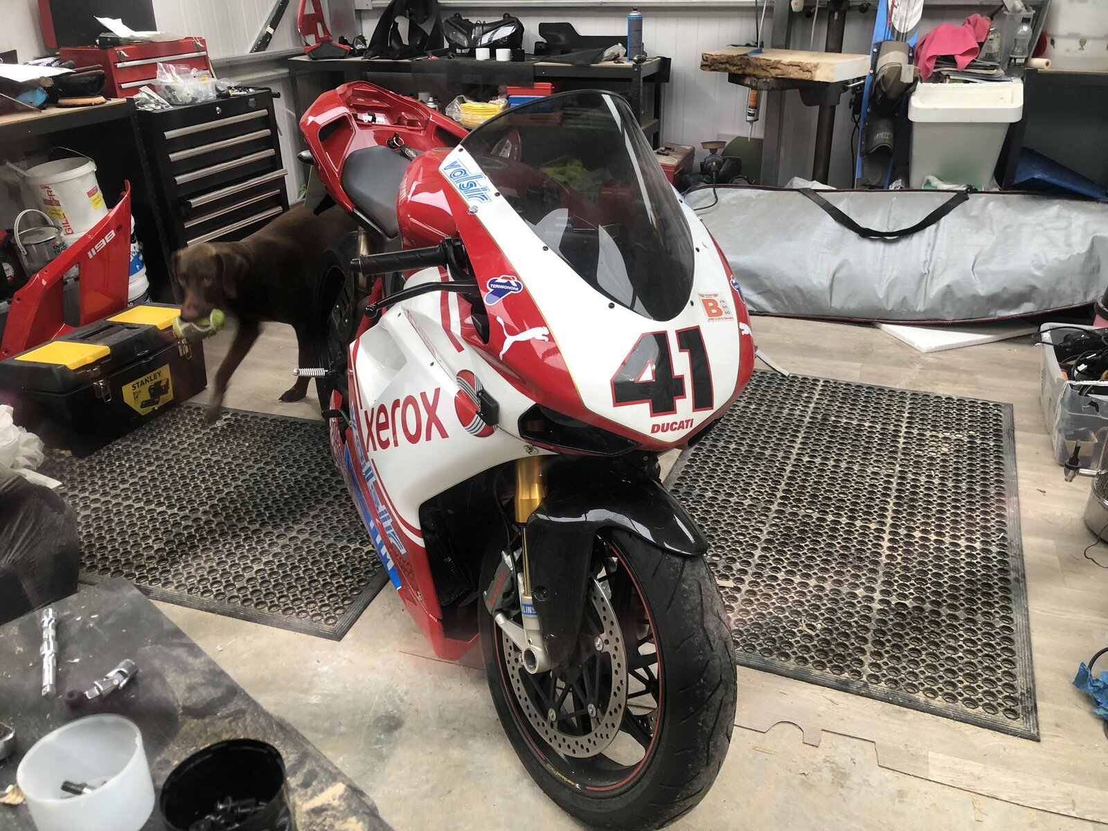

  10. Some more photos, race fairings in the background, 60 quid off eBay? Bit of damage, but nothing I won’t make worse.....
    Cheers
    Dave..... CC38060B-7F1D-43F2-A860-ACB2BCF2B806.jpeg 4899EC83-C617-4B34-B56B-7513C9C41766.jpeg

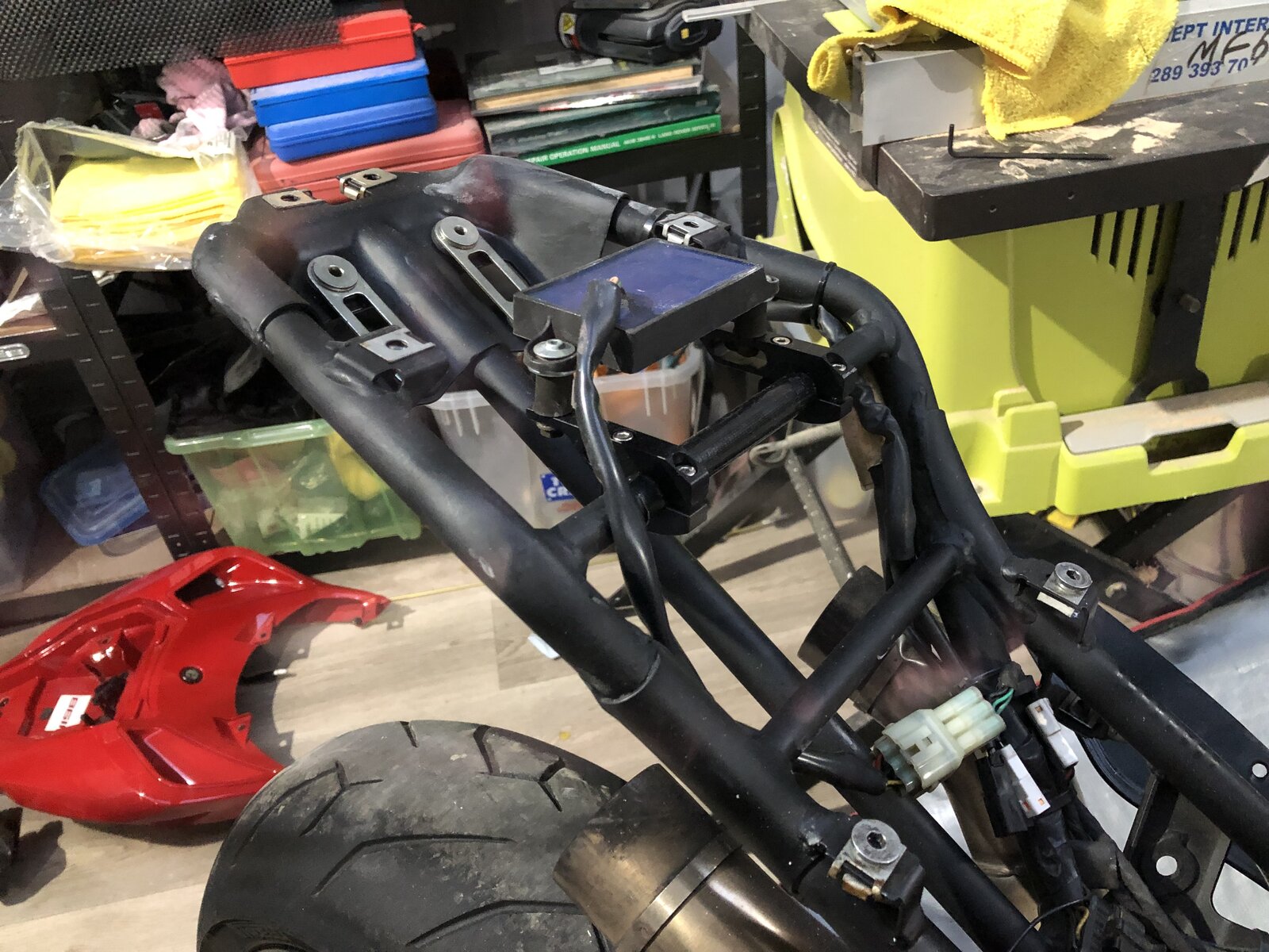

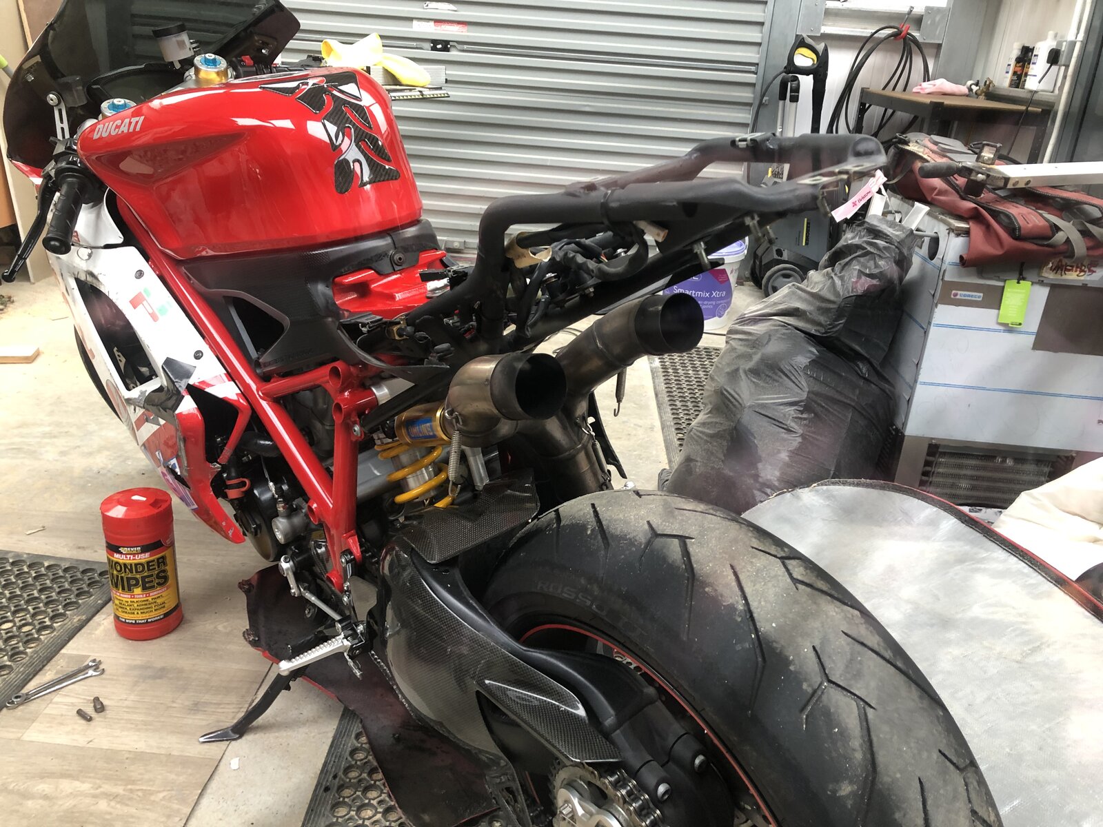

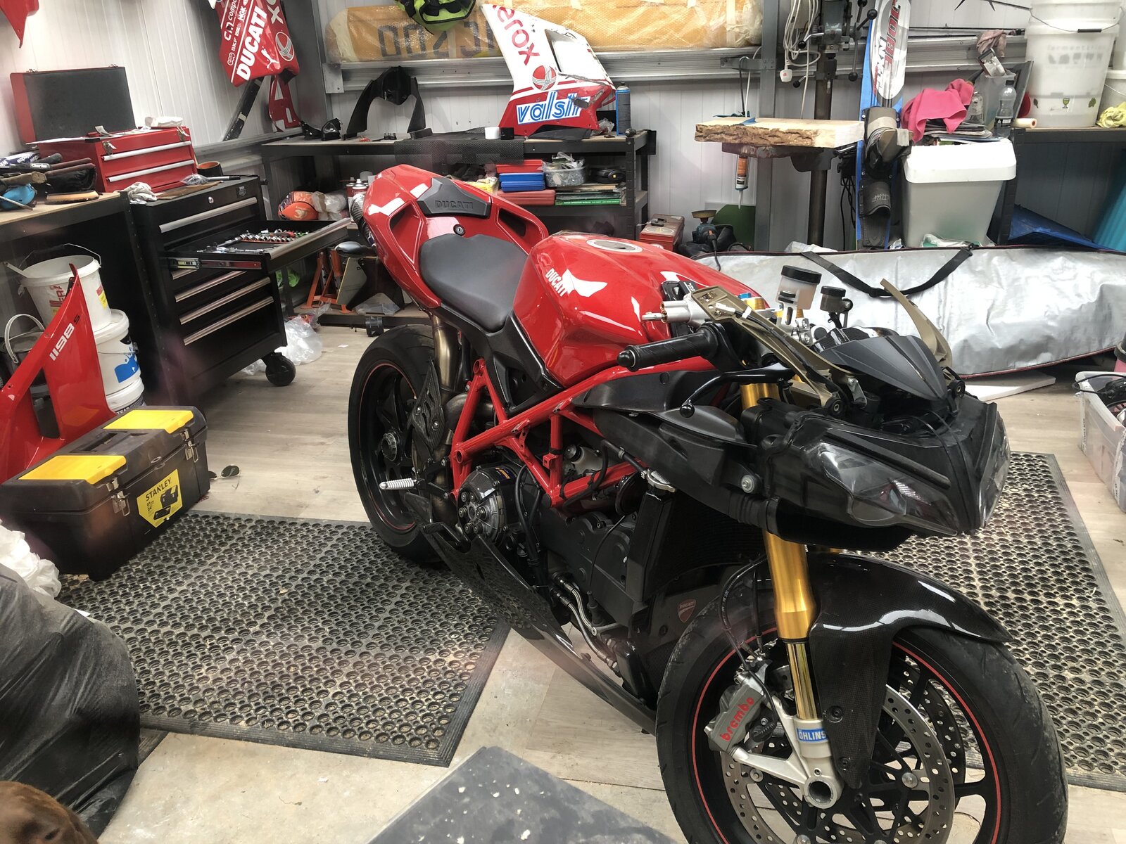

  16. So working on changing the 1198 into track mode....
    Ok so my first track day, on a bike.... in Portimao...
    in over my head, absolutely!
    So far fairings going pretty smoothly, DTC mounts purchased but some clearance issues with track seat fairing. All pictures taken on my broken phone, excuse weird quality!

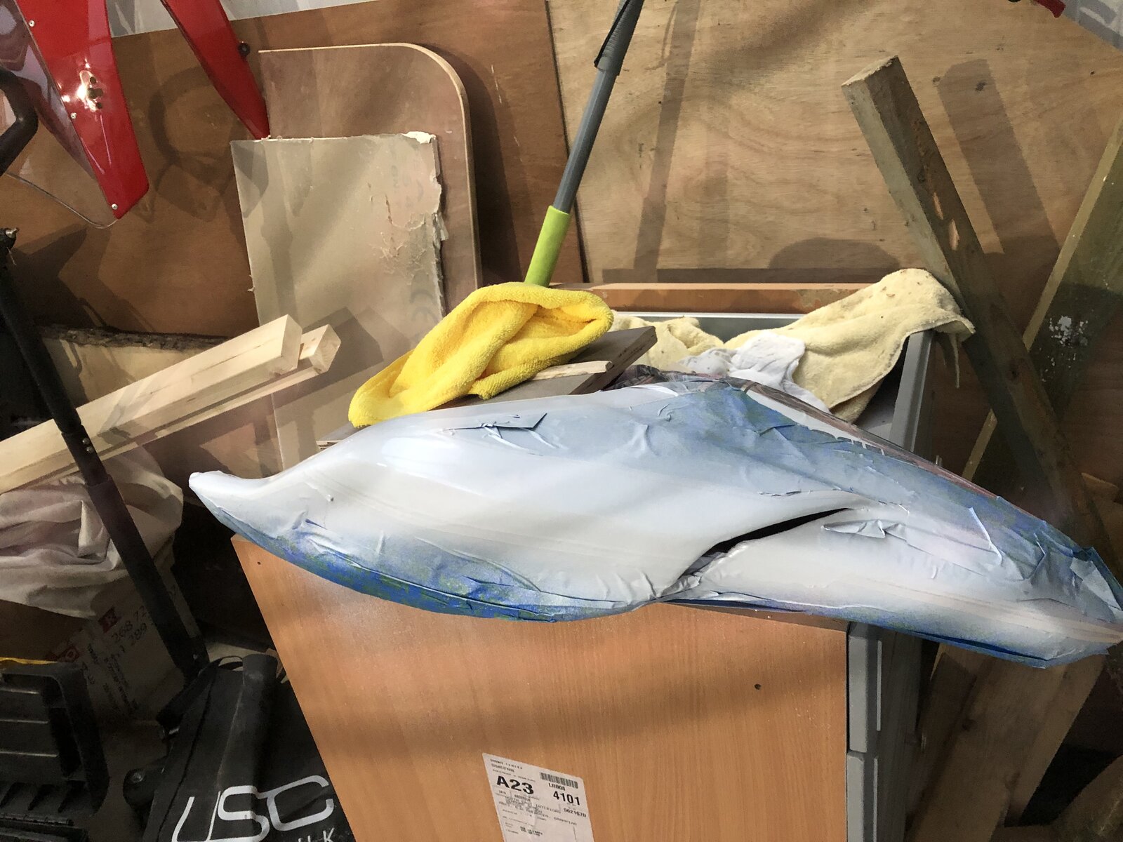

    One step ahead!! But many thanks, it’s still a bit tight, maybe the fairing or more likely the way I have mounted, if I could mount it below that would be ideal, but it gets close to exhaust....
  18. If that were me, I'd look to remove the 2 rubber mounts (they are quite tall) and mount the IMU onto the brackets with some shorter rubber fabrication of some sort. :thinkingface:
