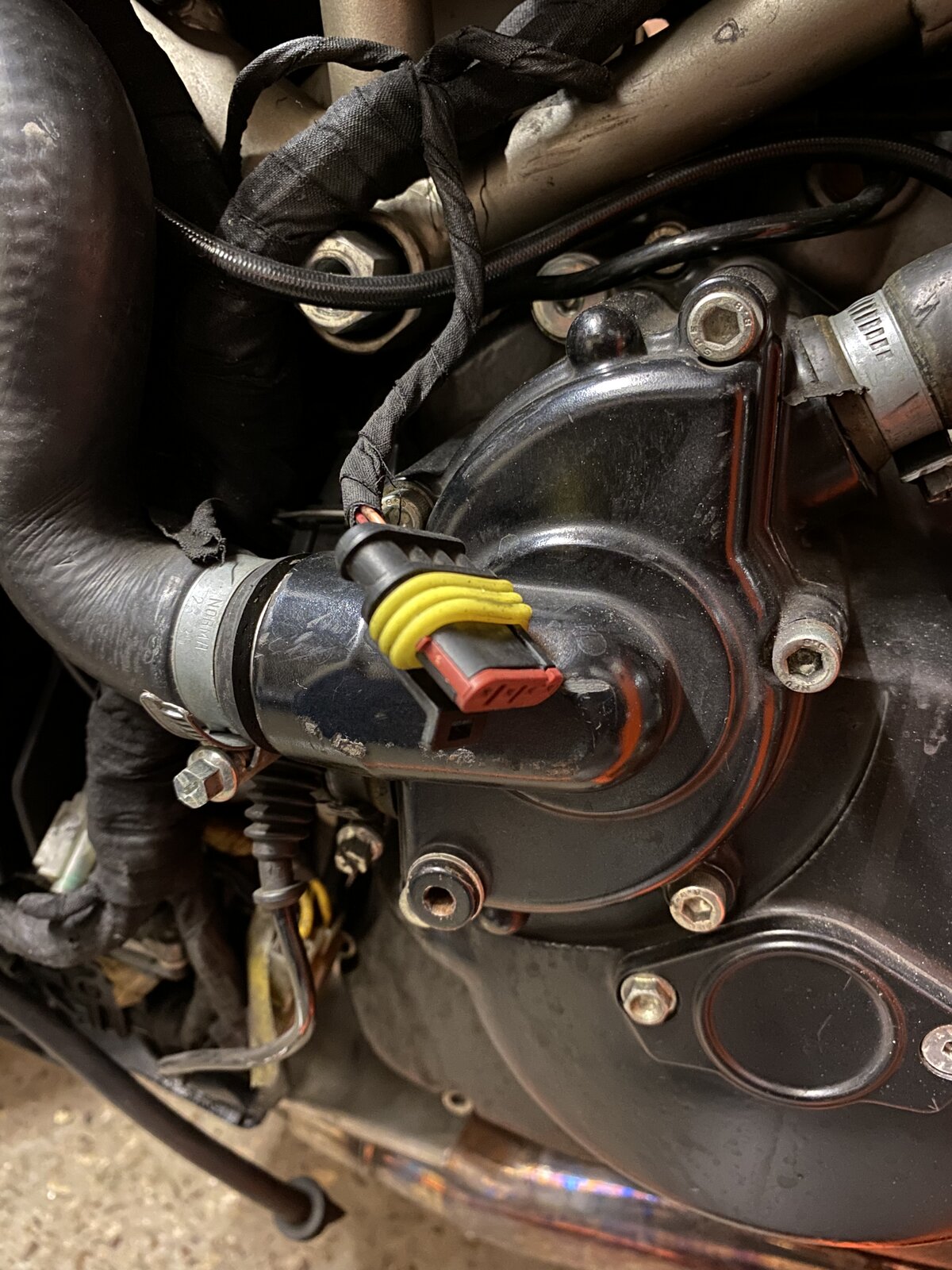

    also see the picture attached- the connector here- is this for my side stand or for the connector for the 2009 unit?

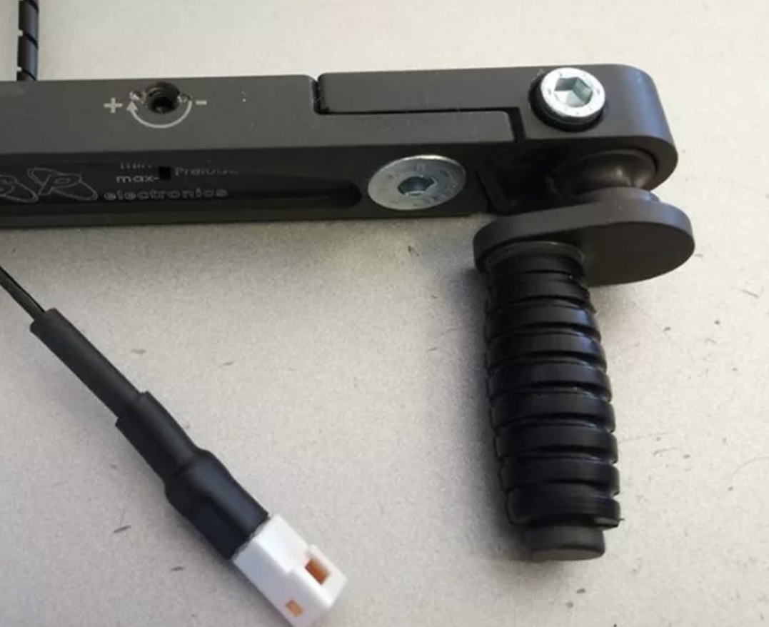

  12. Keep looking around the gear shift area for a white 2 pin connector. This is the shifter side of the connector.
