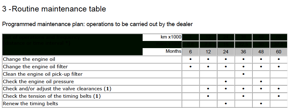

  1. My bike had a belt service with new oil/filter at 9500 miles just before i bought it last november, its just approaching 10K miles now , when would you lads get the belts changed next? ...its not due for a valve clearance biggy until 15K miles (i think) ,these were last done at 7450 miles in 2014, would you recommend getting these done or leave it till it hits the 15K?
  2. Belts are 2 years even if the bike hasn't done the miles.
    Valves are milage dependent. I'd leave them and save your money.
  3. Aren’t belts 3 years?
  4. The 1098 is 24 months, unless the 1198 is different.
  5. Well look at that! I’ve been working to 3 years! Oh well....obviously works fine as no issues...
