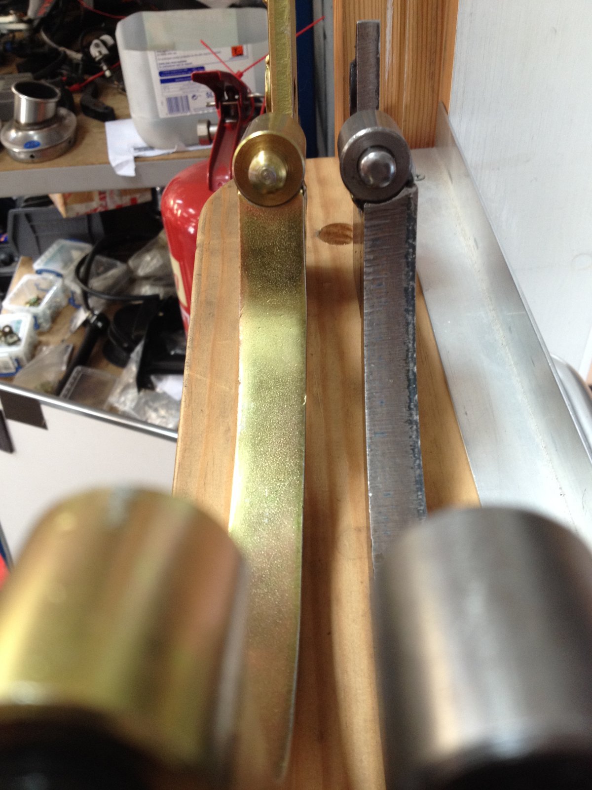

  14. Just a word of warning regards Laser flywheel holding tool. I got one and it wouldn't fit a 998. The tool offset is wrong compared to the ducati tool i was fortunate enough to borrow!
    Laser tool on left, genuine tool is more cranked.
