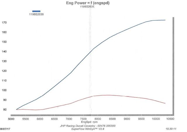

    So after a few weeks getting to know the bike, i found a myriad of issues. Hot starting was non existent...hence the recent new starter and battery i guessed.
    MPG was useless, 50 miles to a tank was becoming frustrating and i was worried about the damage that was causing.
    The bike was also unpredictable - the clutch was notchy, the power delivery had huge holes, it was basically impossible to use in anger.
    I started to investigate:
    It became pretty clear the fuelling was way out, so after a long chat with a few different companies, the bike was dropped at JHP ducati.
    A fair amount of investigation later, and we found the power commander 5 had been fitted with the additional 'autotune' kit, but with only a single lambda sensor (but individual cylinder fuel maps). The conclusion was the autotune kit was reading only one cylinder and having a small meltdown, wreaking havoc with the fuel map.
    JHP removed the autotune kit, added some lambda bosses and mapped the bike from scratch.
    Next problem however, we found my termis had cat converters within the silencers - we decided JHP would remove these and repack the cans, i guess it is now 'open pipe' as such, but it did the job, finally mapping up nicely.
    I also had a STM slipper fitted with the 48 tooth clutch, at this point i just wanted the bike to be right.
    The difference, was absolutely beyond my imagination. The bike was now super smooth, but utterly crushing in the midrange, i just didnt stop grinning for weeks. I finally found what the fuss and hype was all about with these bikes!
