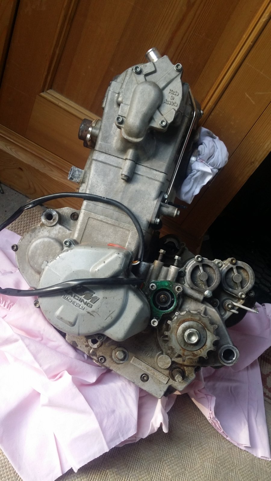

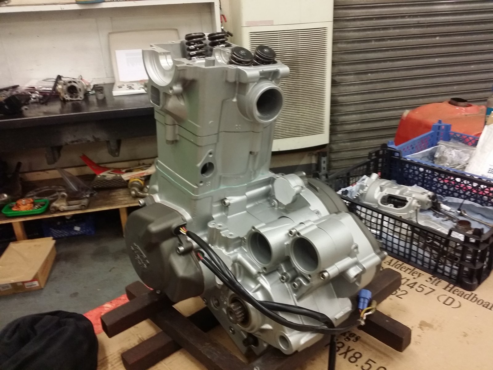

  4. If youre serious about keeping it and spending some serious coin then I recommend xylan. Youll have to have the motor stripped to the crankcases for it to be done....heres a before and after of my ktm motor....
    After
    Xylan is pretty well impervious to anything the place that does it is called Xylan Low Friction Coating - Sandwell UK the lad that actually does the coating is a sidecar racer so loves bikes. Not cheap, my engine cost about 550 quid to coat. Its not the cost of the coating but the masking off. But, once done, nothing will affect it that can be thrown at it. Essentially the coating is used on oil rigs. If they stick something to the leg of an oil rig this is what it gets coated in.
