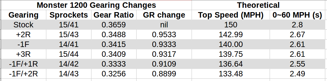

  3. GearingCommander is a good site.
    I made a quick reference sheet relative to stock.
    The 0~60 changes may not be realistic.
