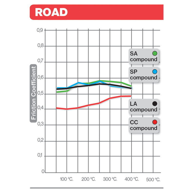

    I dont see the same pad type for the rear on the Brembo site.
    What do i get for the rear?
    These?
    Road - SP
    Product code: 07BB20.SP
    Rex

  4. I have heard the same. But. I have also heard that others like this type for the road. On the Brembo site there are listings that show the amount of friction across temperature. These seem to have the highest friction coefficient to start with and they stay high.
    Like anything else you need a lot of personal opinion before you make a decision and then gain your first hand experience. I dont want something too grabby, but others have said the EBC HH felt like wood. and yet others do recommend them.

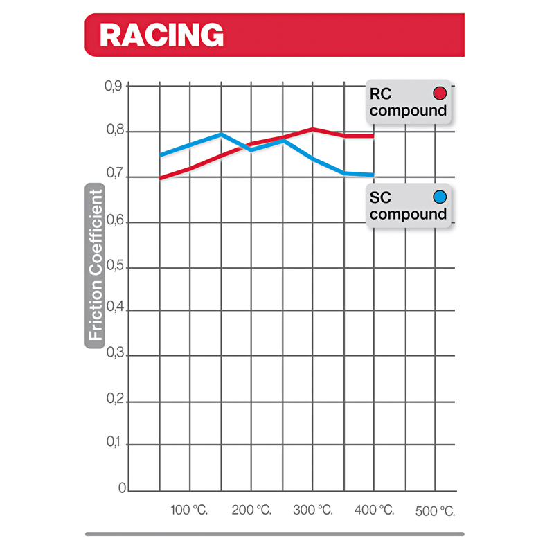

  5. Lets see if this works. Out of the 3 on the page I might want these racing ones seem the least raciest compared to the other Race ones. They start high and stay pretty high. Perhaps when people say they need heat to work when talking about racing pads they mean... to work at their best, but maybe they are still good at regular temps?
    Nothing is really stated about wear, but I imagine the racier they are that they dont last as long.
    All opinions are good opinions for this type of stuff.
    Racing - SC
    Product code: 07BB37.SC

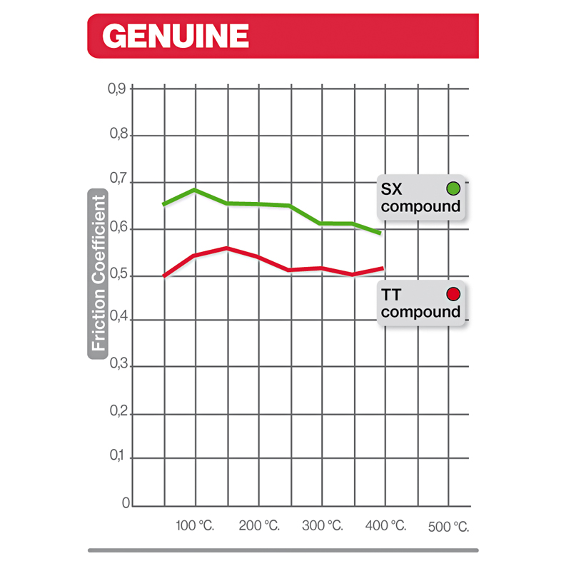

    This is what comes up as recommended but there are many others on the page. They dont state if the 93 (higher is more friction) is the SX or TT?? So they might be nearly the same as the SA above
    Genuine - Sinter ( 93 )
    Product code: 07BB37.93

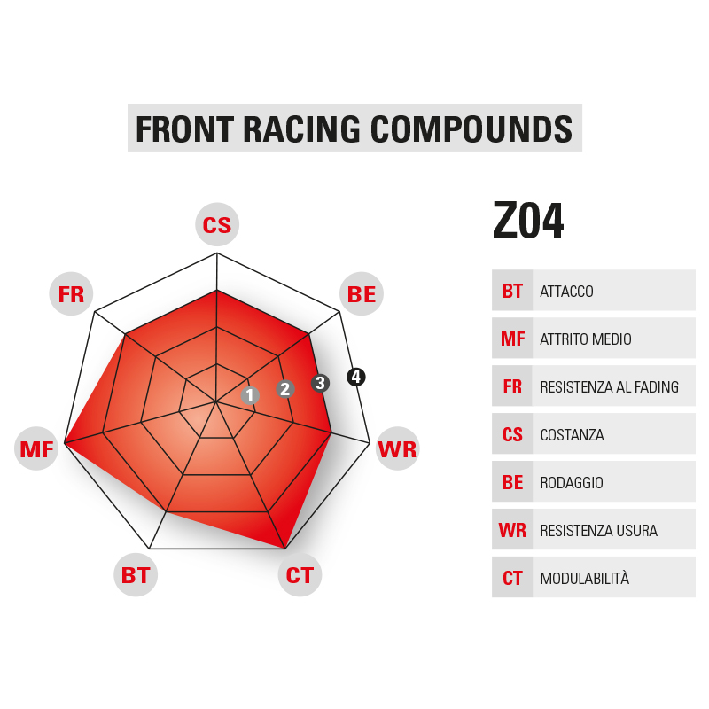

    his is one of the truly race compounds...
    and this picture does not help at all
    Brembo Racing Z04
    Product code: M497Z04
    Rex
