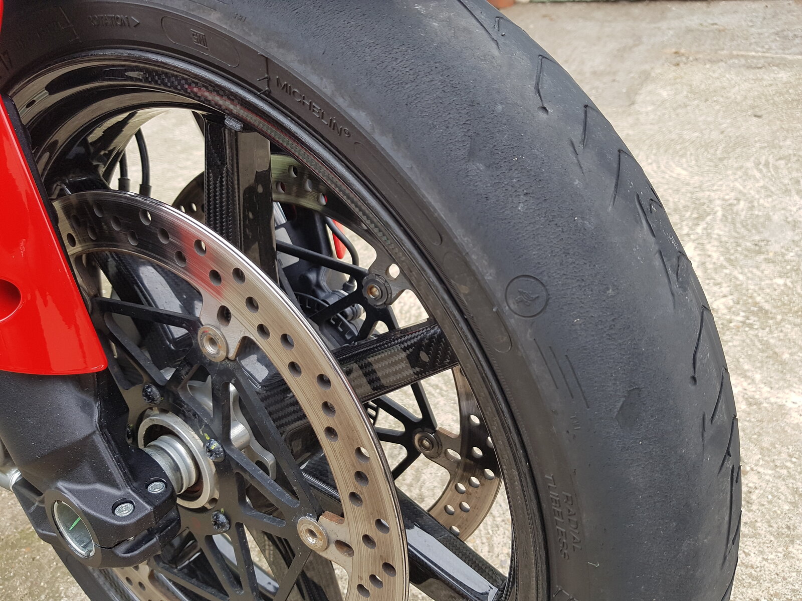

  1. Multi 1200s , 2013, 42k miles
    After 5k miles I noticed the ride side, front tyre, is worn more than the left - could say worn down twice on the right than left. The rear tyre seems to be worn down evenly. Also rear is not worn down as the front (both replaced at the same time) - it looks like it will be two fronts for one rear.
    Also notice the scalloping, rubber is lifting off- see arrow on photo.
    Is this normal for the Road 5? I expected more even wear and over 9-10k for the front, that's what i got from the 4s and 3s.
    Or is there something wrong with the bike. It feels ok riding, handlebar is straight and no vibration.
    Please note there are a lot of roundabouts in Milton Keynes :grinning: but did not get so much wear on previous tyres.
    Any ideas or what to check?

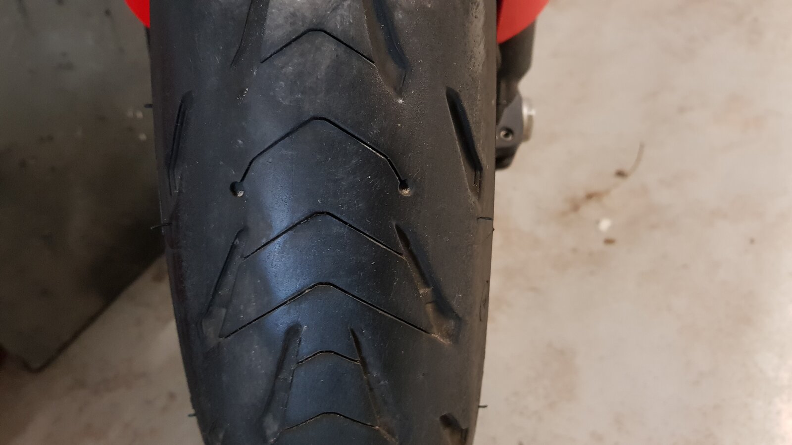

  2. This is my front & rear 4500 miles. 1200 s DVT 2017. The rear is starting to flat off a bit but front looks fine.

  4. Well as you can see mine have no uneven wearing. Just normal rear flatting off. The blurb was that the 5 was supposed to be a lot better wear wise than previous. Not sure about that front right side feathering. I have just asked my daughter to check at bike tyres Leeds to see if they have had any issues. Will report back when I get a reply.

  11. I am mostly concerned with the wear on the right side - unless is something wrong with the bike (? ) it could be just down to too many roundabouts and road camber.
    But it seems that I will be replacing the front twice, usually is two rear for one front.

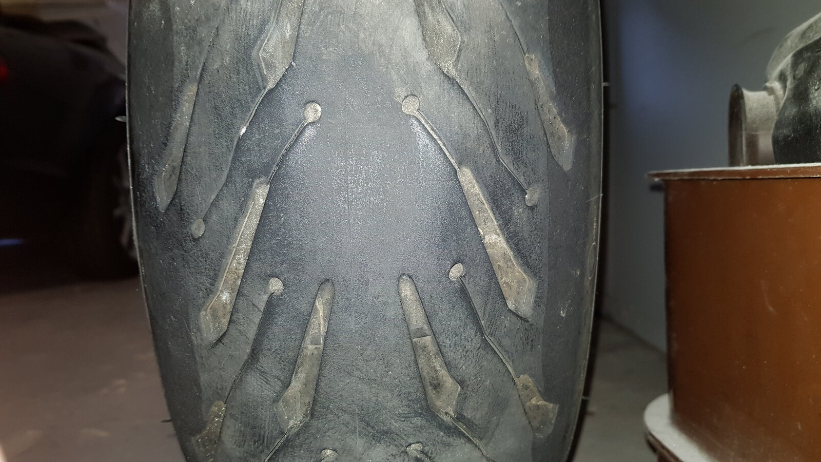

    Although @kartman gets a low mileage is still 2 rear for 1 front ( my rear looks quite healthy although cannot get rid the chicken strip - no strips on the Pirelli GT or Road 4s :))
    Rear
