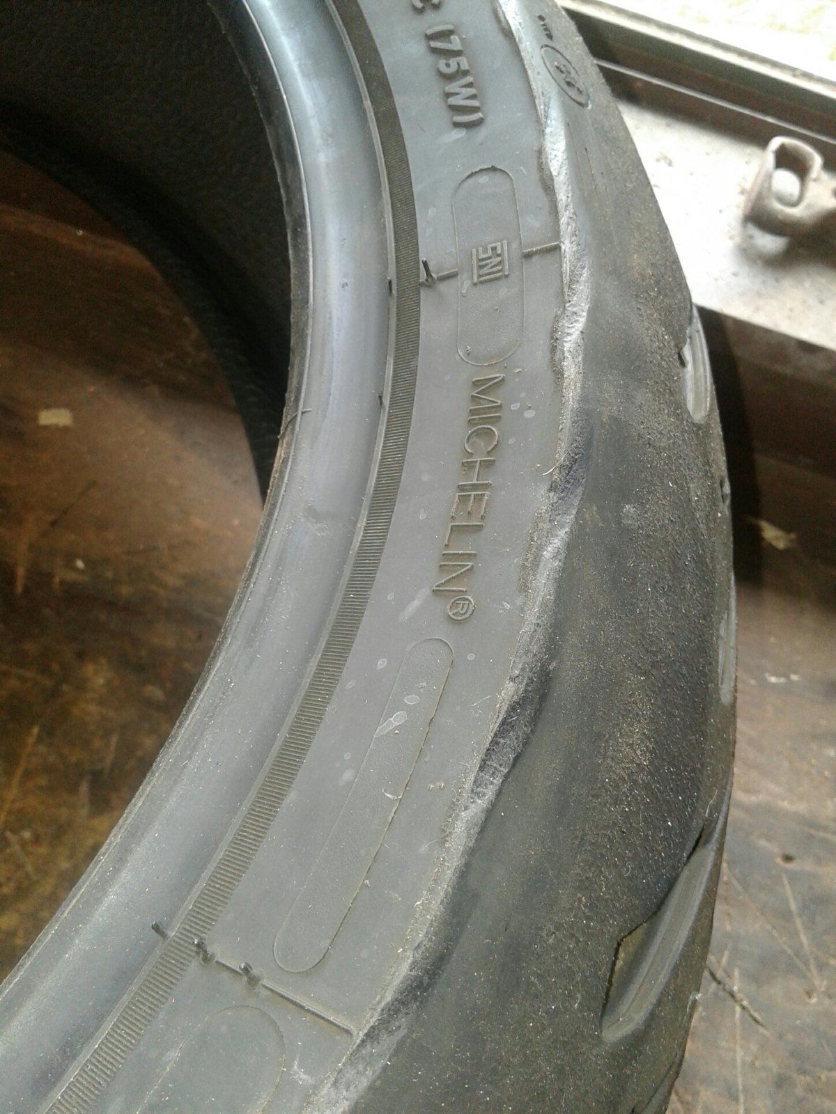

  1. I recently noticed some pretty nasty gauging out of the side of my rear tyre.
    I'm guessing under hard right hand cornering the tyre is flexing enough to allow the chain to nibble away at the side of the entire tyre.

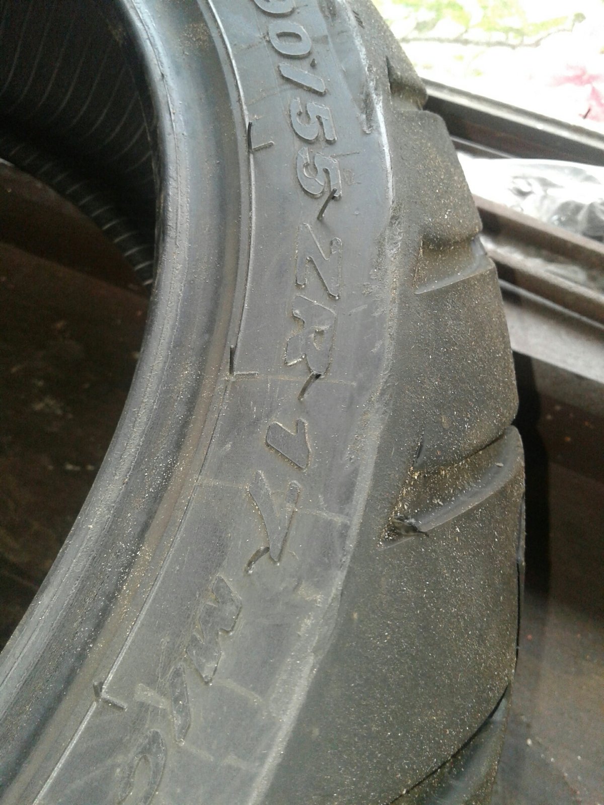

    I'm currently running PR 5 (STD 190 55) which actually measure up about 4mm wider than the OEM scorpion 2, which I fortunately kept and after checking it closely noticed the same marks but not as bad
    Before anyone ask, I'm running 38 psi and always keep my chain adjustment in spec
    I'm wondering if the 1260 owners could check and advice if they are having the same problems

  2. Many thanks for posting that.
    Yes, I've just been a looked at my Scorpion (second set) and have the same shaped marks, they are very feint and I wouldn't have noticed them had you not pointed it out.
  3. I would be surprised if that was the chain causing the issue
    Check your dirt deflector is fitted correctly and isn’t loose or flexing and catching the tyre under certain loads

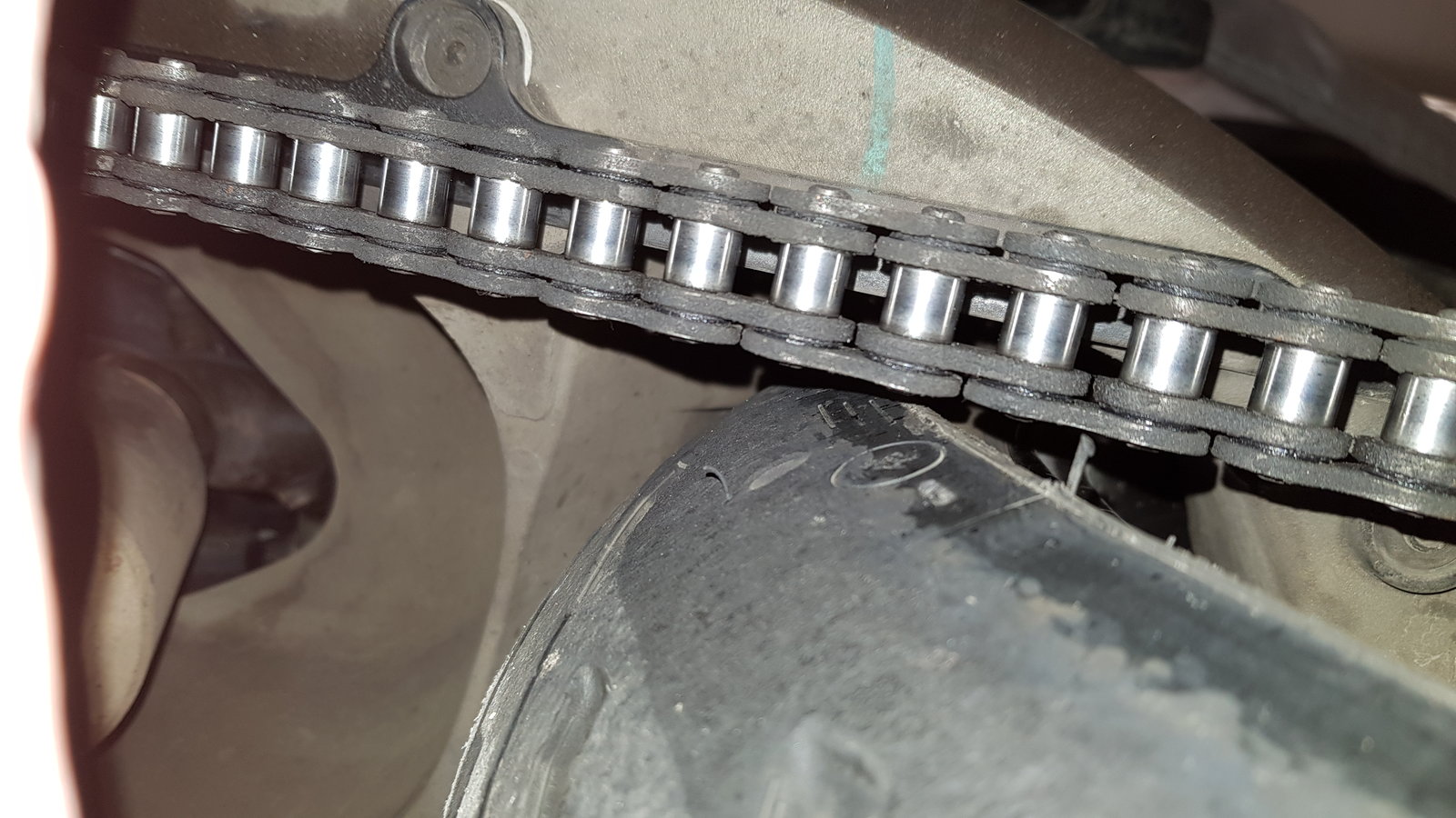

  9. Thanks for your replies. Veetwin has told me what I needed to ask (and didn't) the clearance on his at 8mm. It's glaringly obvious my 3mm clearance is definitely wrong. I'm guessing something has been left off during assembly

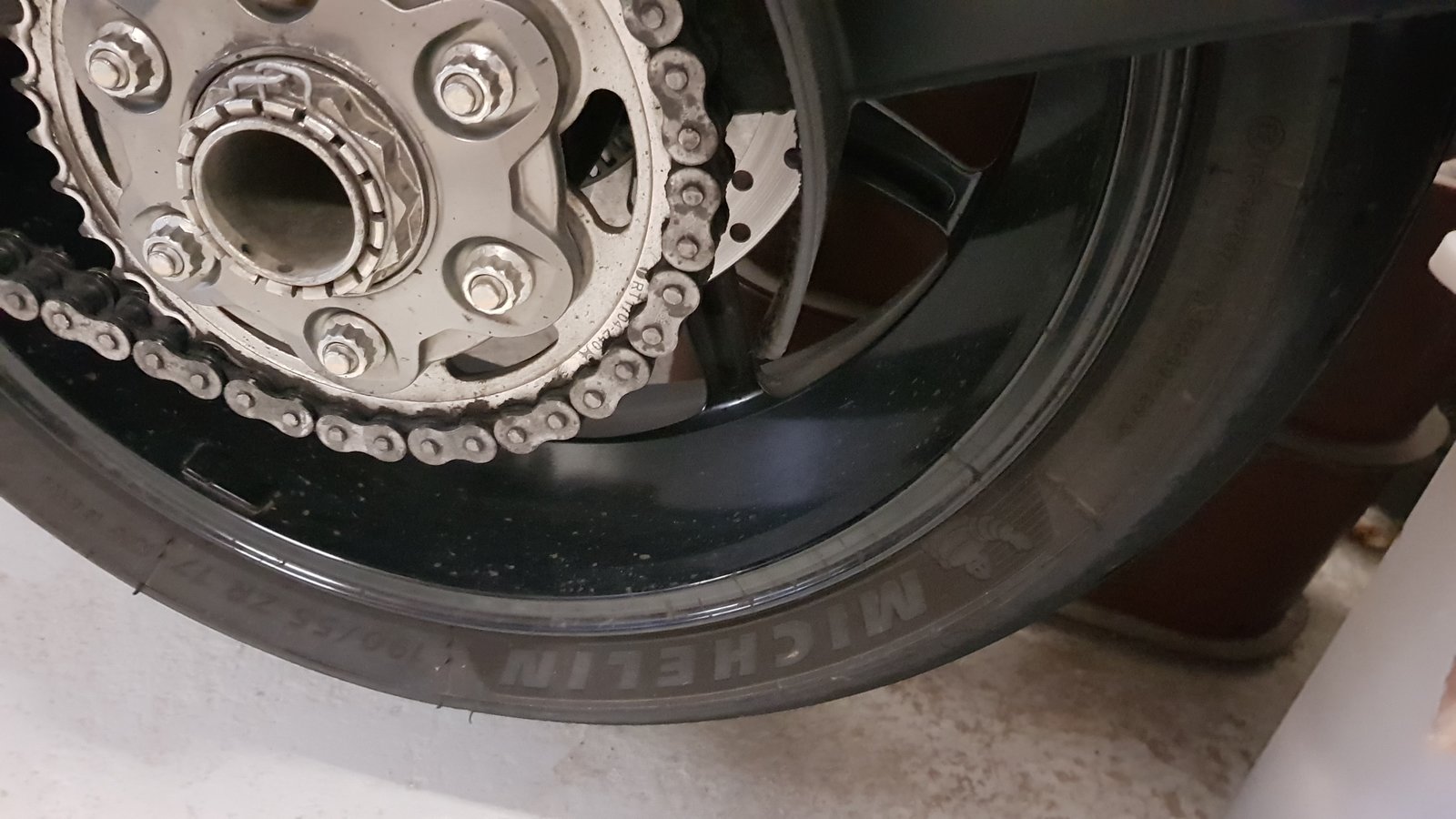

  14. Just looked at mine PR5 on 1200s 2017 no catching but yes the chain is very close & could guess if worn or loose would cause the problem.
  15. I had road 5's on my 15 (same as your 17) and had no clearance issues, which is why I was very surprised to have the issue on my 18
  16. I reckon the gap is about 3-4mm. I have looked closely at the tyre & I think there is just a slight mark where it has touched.
