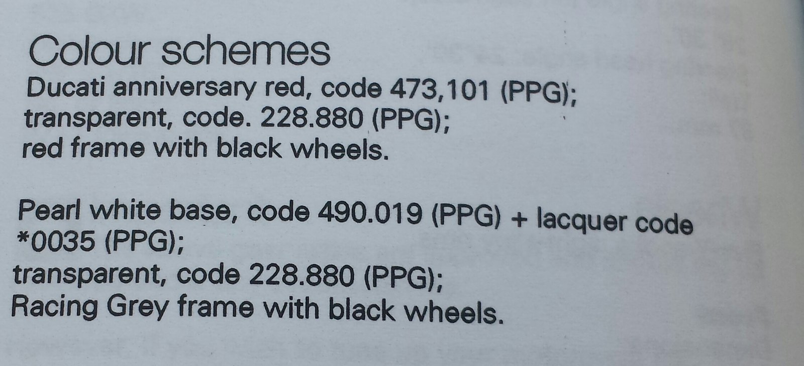

    Thinking about it, aren't the paint codes in the back of the manuals ?
    I have a feeling I was wrong above, and the panels should be clear coated, but the frame and wheels aren't.
  14. I found this, this are 848 codes but I would expect them to be the same.
  15. There is lot more than one red Ducati paint colour.
  16. I appreciate that Duke, but the above gives the clear coat code for the current gen bikes.
    Whether they should all have a clear coat, or which models do and which dont, I have no idea.
