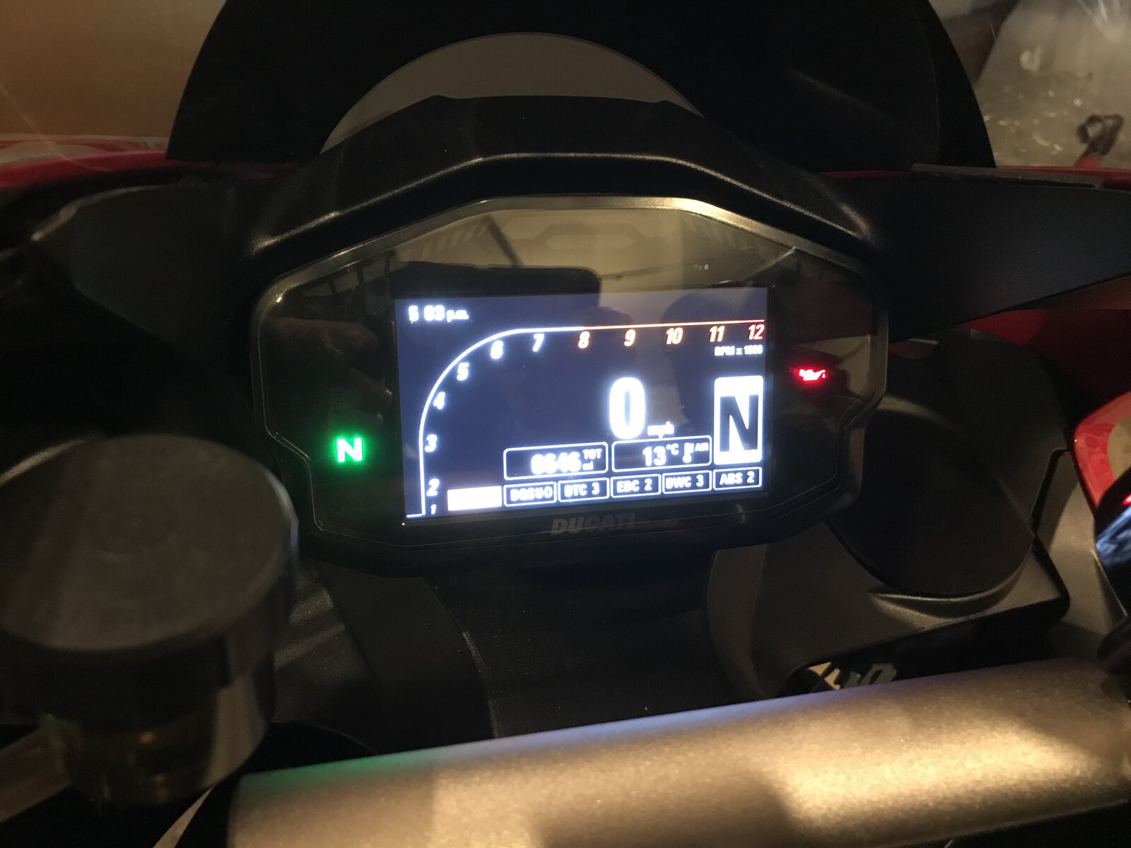

  1. Probably a pointless mod but was bored and after speaking to various people and being told it couldn’t be done, I thought I’d give it a go as that’s the way I am! Being a bit thick and stubborn can sometimes pay off...
    Started off with a 1299 dash. Plugged it in and got the normal error and Unknown Device lights on the screen. Neither the abs or traction lights flashing.
    Then bought the BBS off the same bike as this makes things a bit easier. The mileage is stored both in the dash and BBS. If you don’t use the matched pair, you’ll just get the ____ displayed where the mileage should be. A Texa can sync them but only to the higher stored mileage of the two.
    Then I managed to get the 1299 main wiring harness, abs pump and IMU for an absolute steal from the states. Proper cheap, the whole lot came to about £250 which wouldn’t even get you an abs pump over here.
    Unplugged the abs off the 959 and fitted the 1299 pump with the dash and bbs. Most of the errors then disappeared. This meant the BBS and ABS are the brains of the bike. At this stage I still had the rider mode flashing as it wasn’t seeing all the sensors, the inertial sensor error as I hadn’t fitted it yet and still had the Unknown device as I was using the 959 ecu.
    Fitted the 1299 wiring loom last weekend as well as the IMU, it’s mounting bracket and the 1299 ecu turned up this morning. Just finished it all off and a all working as it should, I suppose as a 1299 should.
    I did all this instead of just buying a 1299 because I think the 959 is a perfect engine for fast road riding and the 1299 would just be over kill in my case.
    As a result I have a nicer dash, auto blipper, cornering abs and a few other bits.

  2. Bike starts and runs but rough. Obviously as both the timing and fuelling are miles out. . Hoping to get the bike re mapped sometime soon.

  5. Totally agree with the 959 being in the sweet spot.... And far better with a nicer dash to look at! Along with a few extras:upyeah: Nice work
