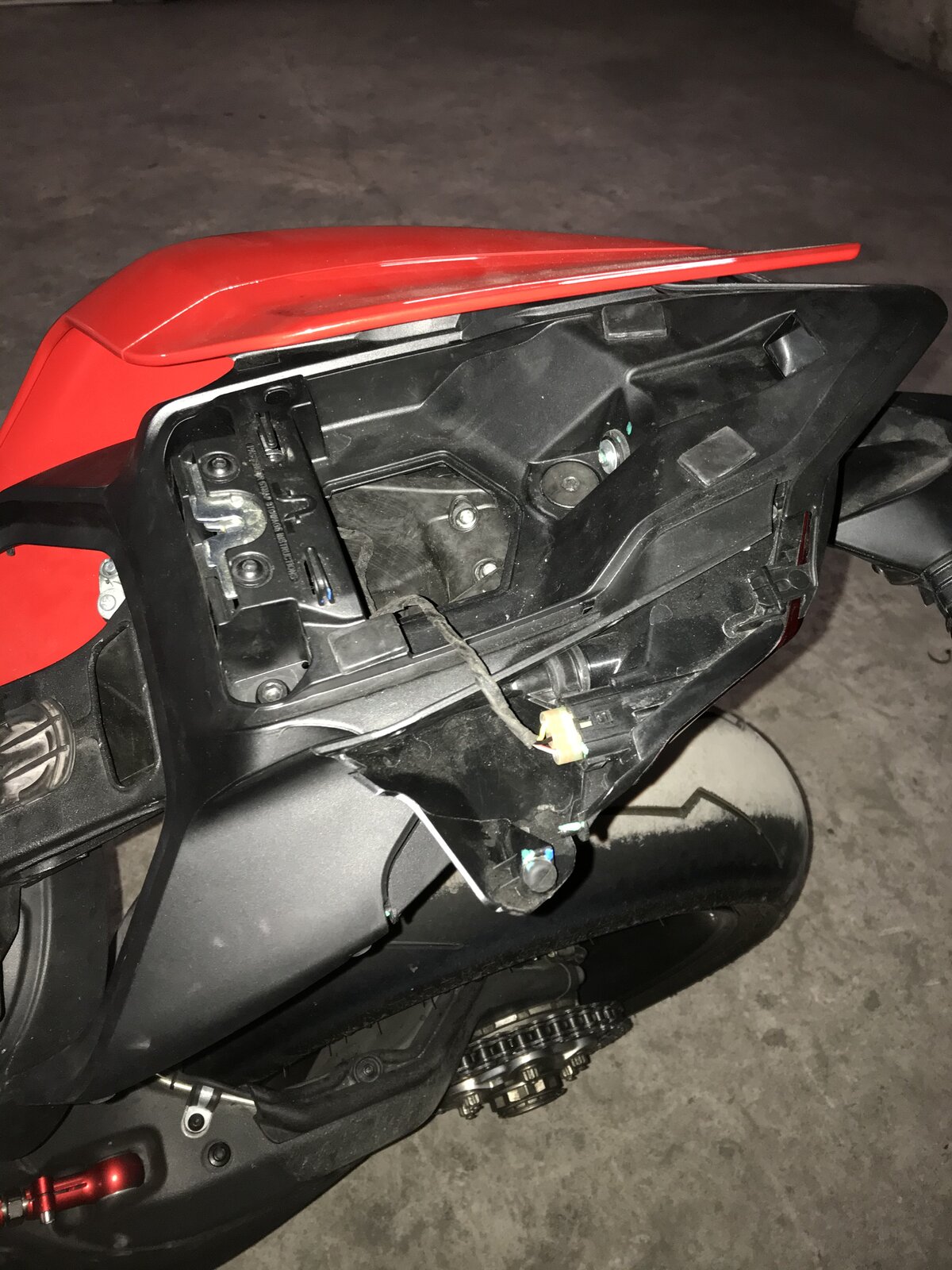

  1. A7F47002-B74B-4FE5-984F-6F3FFCE37165.jpeg Hi all, sorry for the silly question, but can anyone tell me how this wire is supposed to be routed? The way its sitting in the photo prevents the little tail fairing from finding its place, and there’s no other way I can see to route it apart from “through” the subframe, but even then I get stuck at the back...? Any help appreciated A7F47002-B74B-4FE5-984F-6F3FFCE37165.jpeg

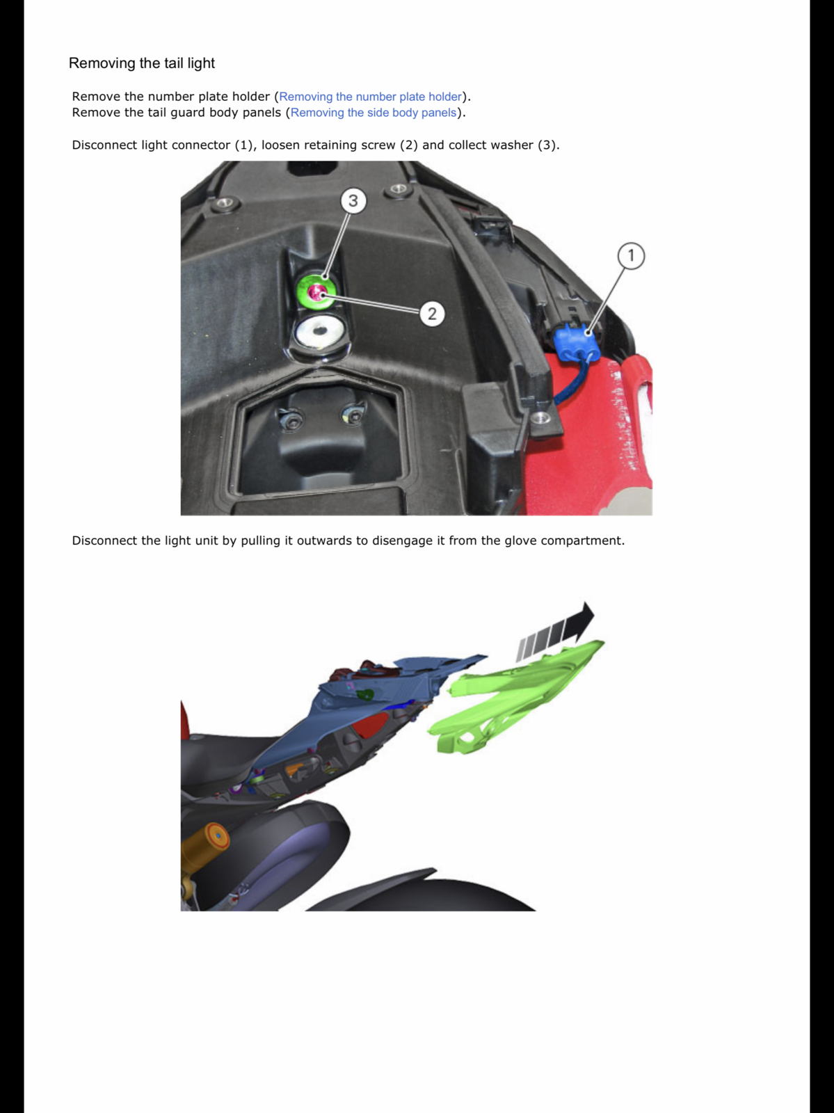

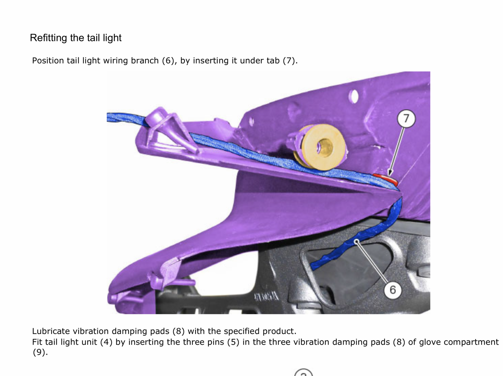

    It goes out of the hole in the subframe. You will probably need to remove the tail light, pass the cable through then refit.
  3. Awesome, exactly what I was looking for. Thanks a bunch!
