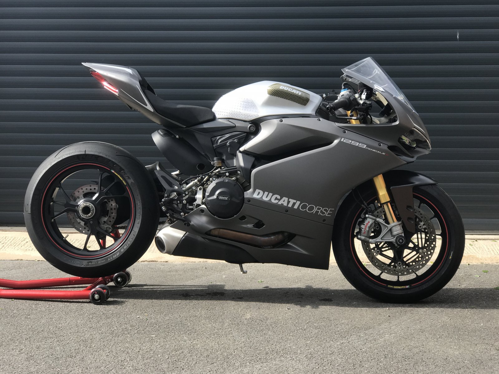

    to save money on paint jobs, I had mine wrapped for £250:

  8. Eurotint did mine. Mine were not painted. I did have a couple of bubbles appear by the exhaust, however painting wouldn’t have changed that. I had mine 2 years without any unsticking issues. If they are done properly you should be fine. It is worth spraying the inside of the panel in black just so you can’t see the natural white of the plastic anywhere.
