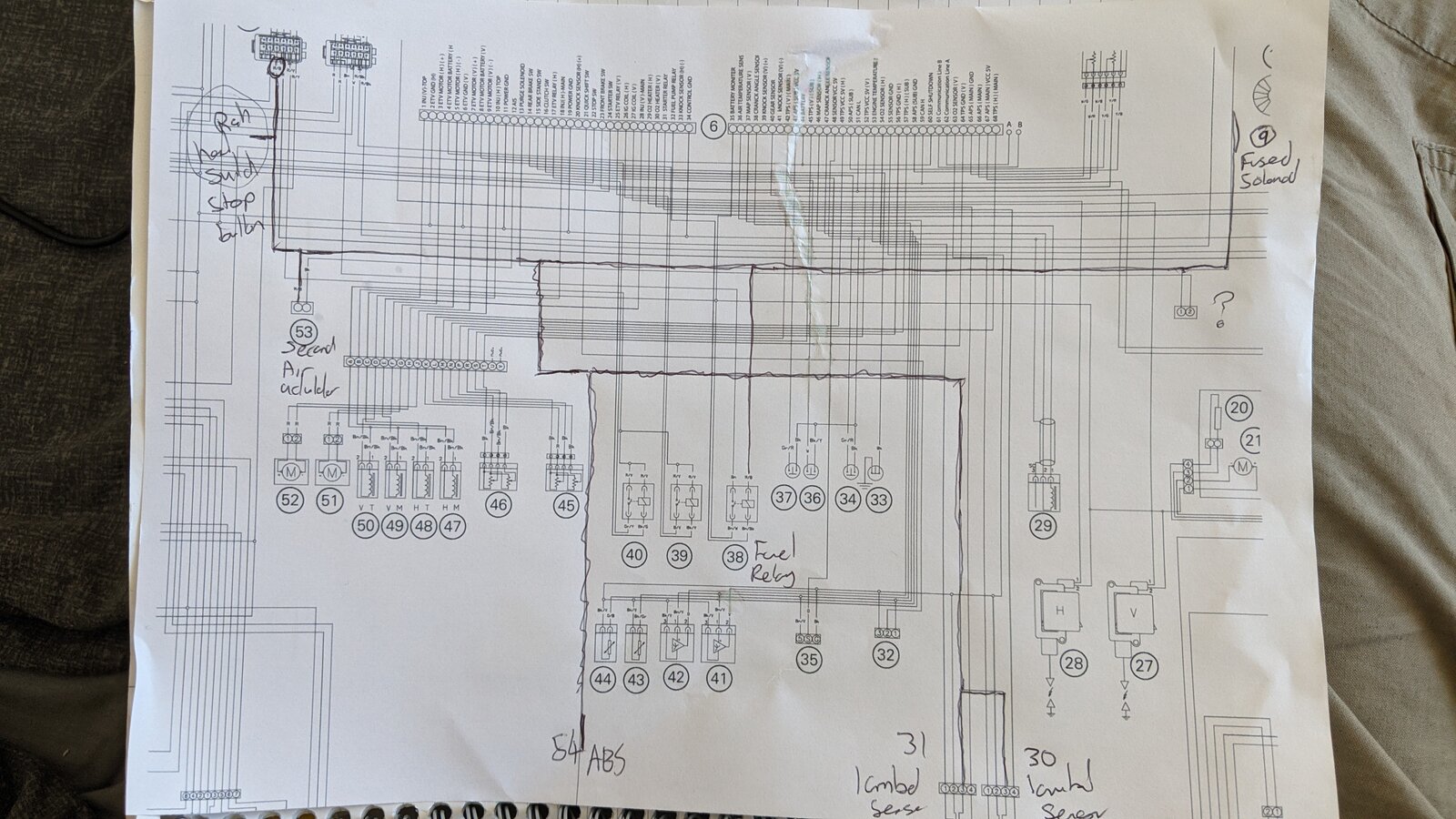

    So mapped out wiring diagram for red blue line
    Connect to
    1.Right hand control start stop (I have messed with this and is jet prime)
    2.secindaery air actuator (I have messed with this deleted due to slip one)
    3.abs
    4.fuel relay
    5.horizontal O2 sensor
    6.vertical O2 sensor (messed with this when changing carbon shield)
    7.fused solinoid (think that's starter solenoid)
    8. Oh mystery unlabeled sensor is purge solonoid, that evap?? If so that's deleted
    So will start with the bits I messed with as likely them, maybe jetprime rh control as they are on the throttle so I would have yanked that when accelerating and it cut out out.
    Stupid printer wouldn't scale diagram

  8. does deleted still mean connected but just mapped out?
    if poss, i would just have a handful of fuses and disconnect a component at a time until fuse stop blowing. if they dont i guess you have a short in the wiring or + to ground.

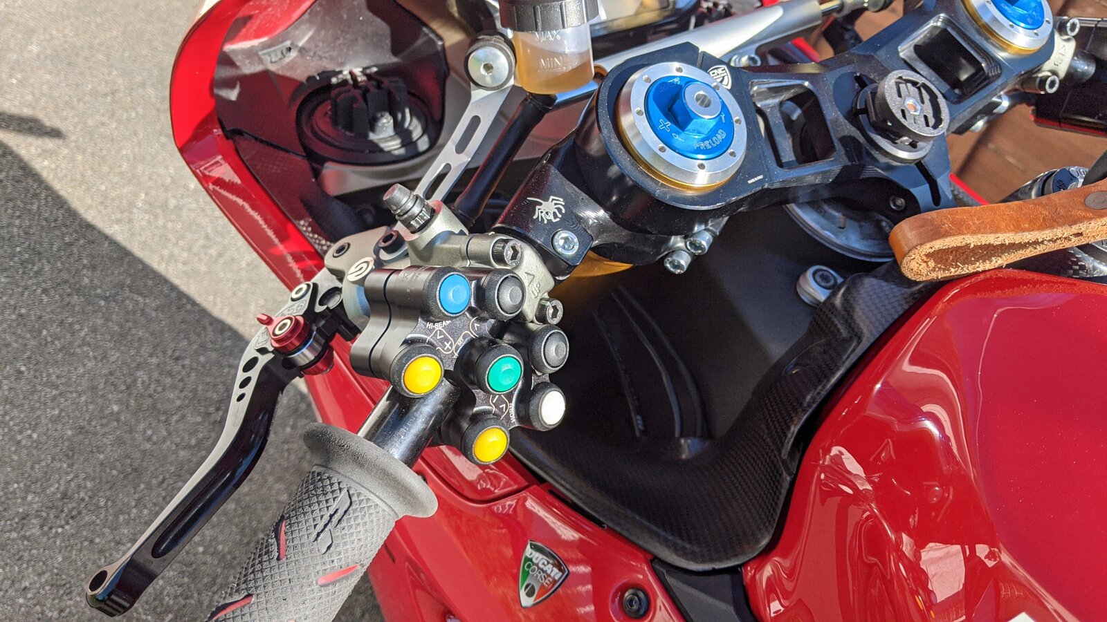

    Oh and as side reward I fitted a fancy bikesport developments lh control :cool:

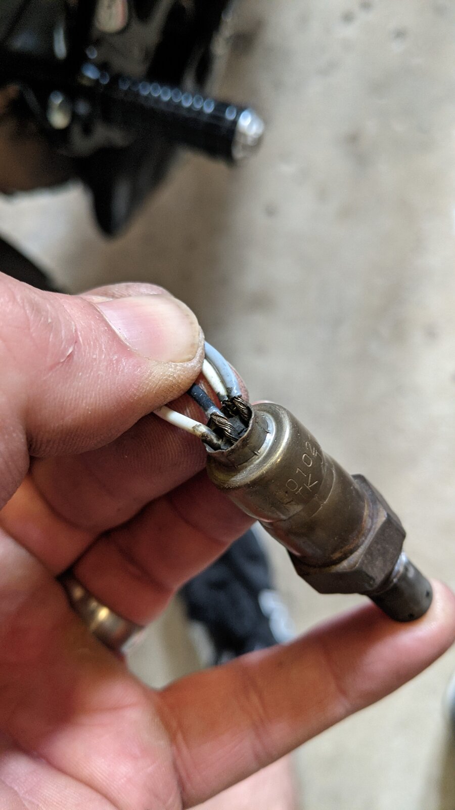

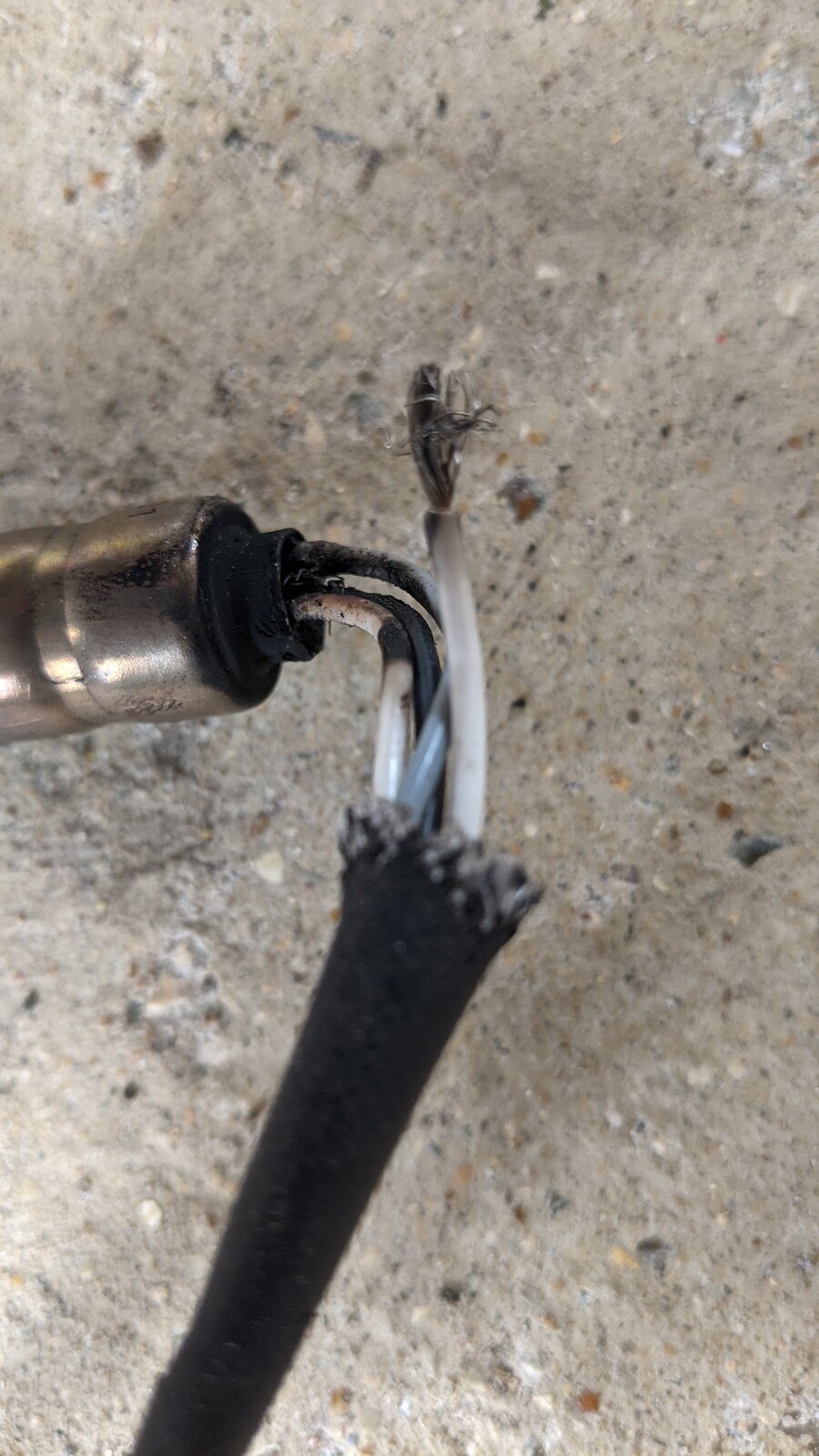

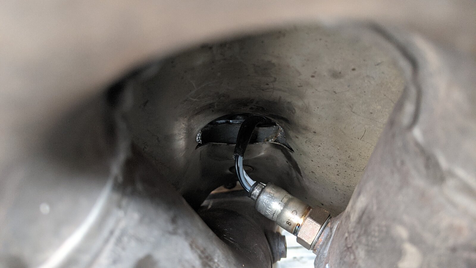

  11. Well my 1299s hates the O2 delete crusing in 5th at 80 bogs down with any throttle. Will get map at some point to delete them as part of other work, tried clearing temp fuel tables but that just made it worse.
    So went to look closer for the actual issue so can put o2 back on and cable looked fine so pulled the sensor and it's mashed, was not in exhaust very tight and seems the plastic / epoxy that separates the wires is gone and wires have been pulled so all bare and shorting on sensor body and each other.
    You can see front of sensor is how it should look.
    Glad to find the 100% cause as nothing worse than fixing an electrical issue accidentally as you wait for it to come back

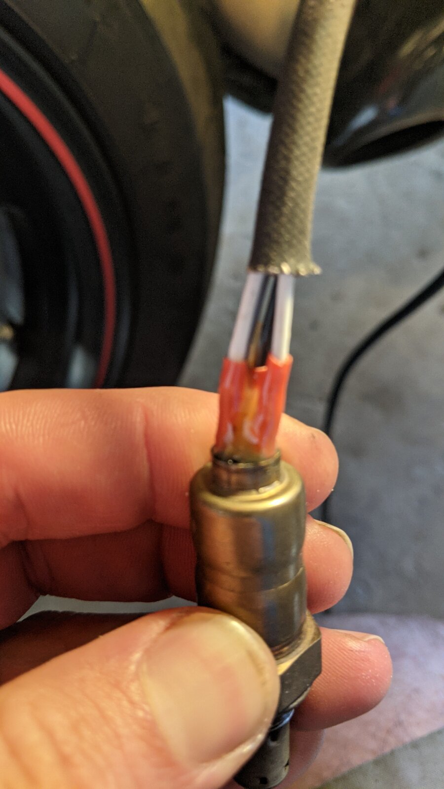

  16. Cheers chaps it Gauls me to put a bike into a shop but I'll be honest I hate electrical gremlins so the temptation to get AA to drop.it off at the shop was real haha, but much more rewarding and cheaper
    at 200 squid plus for a new O2 I just split and slid on some wire insulation and then used 2 part epoxy to seal and lock it all inplace and as an extra layer of insulation.
    Just did 85 miles of pretty full on fast paced B road riding with a friendly CBR up my chuff for 20 miles of it and she was faultless.
    Happy days
  17. Well I got 200 miles out of it before the epoxy burnt and a wire burnt clean off.
    Sometimes you have to bite the bullet :worried::joy:
