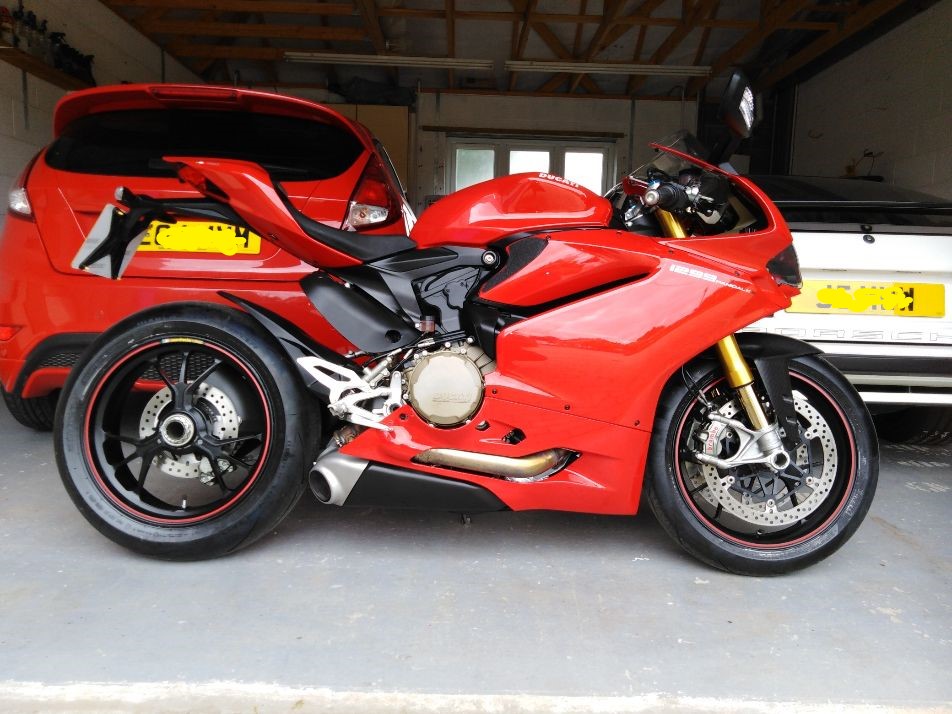

  1. Took my new to me, 1299S for a first ride today and tbh I was a bit underwhelmed. Coming from a BMW S1000RR I was a bit surprised the Panigale has less go under 12991.jpg 6k revs. Was I expecting too much?

  9. It's in race mode/high power. I've never ridden a Ducati before, so maybe I'm doing it wrong.

  10. check to make sure the DTC and Wheelie control aren't turned up, as it may cause the hesitation/ lack of get up and go in the lower revs

  12. It's a function of the bike's design. Big pistons/wide bore and a relatively low mean piston speed. You can't really compare the two.
    Plus the transverse four makes twice as many power strokes as the twin for every 720° rotation of the crank (4 stroke cycle).
    Improve the mapping/fuelling as described and adapt or go back to fours.
    And on that subject, V fours will definitely give you the best of both worlds.
