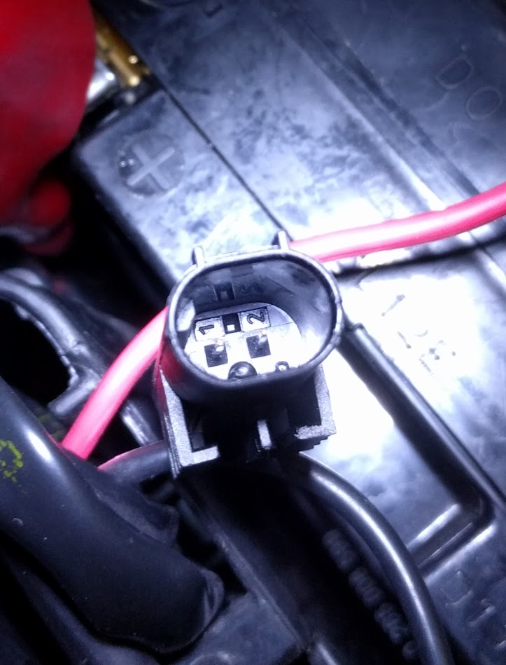

    I unclipped both the front and rear ABS sensors and tested the resistance on both of them at the connection. There's a picture of the connection below. Now, I'll be the first to admit I know very little about electrics... But my process was this.
    1. Set the multimeter to 2000 Ω
    2. Put the negative probe on the terminal post #2 in the picture below, put the positive probe on the terminal post #1 in the picture below.
    3. Swear and carry on whilst trying to hold the probes on the tiny little contacts and get a reading...
    On the front sensor I was able to consistently get a reading of ~ 820 Ω, on the rear the resistance read >1 on every scale. Now with my limited understanding this would seem to mean that probably the sensor wire is indeed snapped and the thus the circuit is not continuous. I wondered if anyone could perhaps confirm this thought process for me? Assuming that is indeed the case I might even go ahead and buy a new sensor and hope the plug and play fixes it all.
    Fingers crossed this is the issue, it'd be a cheap(ish) and easy(ish) fix compared to some...
    Any more help would be appreciated!

  11. As fas as I know these sensors are hall-effect, not inductive, and I have never managed to get a resistance reading from one. I had a similar problem to messes above and the fault also turned out to be a break in the loom near the steering head. Further, if the rear sensor is faulty you will not get a speed reading in the dash. So I think the sensor fault is more likely to be with the front one.
    It's possible the failure to turn off fault is stuck contacts in the hands free relay but more likely it is the LH switch, which has one set of contacts for "Unlock"and another set for "Engine stop"
    The ABS, DTC and speed sensor error and the inability to switch off may be unrelated. So you could have two faults which just happened to occur simultaneously.

  15. Well, it's fixed!
    I did try to find the damaged part of the old cable, but I'm very pressed for time at the moment, so rather than fiddle around for hours I bit the bullet and bought a new one. Ducati were great. I ordered it at 9am today and it was shipped to my local dealer from the Sydney factory by 4pm. Fitted it by 6pm and it's back in action!
    I had a moment of despair when I first hooked up the new sensor and turned the bike on. First thing to come up was "Error - ABS, Error - Speed Sensor". I was pretty gutted until I realised the front wheel sensor was still unplugged from when I had been testing it's resistance! Plugged that back in and all the errors disappeared. Bike electrics turning off/on as normal with the RH switch too. I'm still confused as to how a faulty sensor stops a seemingly unrelated switch from operating correctly, but I'll try to ignore that and hope it never happens again!
