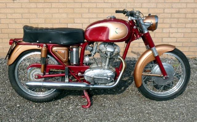

  10. This is what the tank looks like (if I've managed to add the photo correctly). I was doing a bit more reading and it does seem unlikely it could be a TS from 1957, although many bits could have been swapped by now. I'll check the numbers when I go to see it. upload_2017-6-5_19-49-40.png
  11. Had a look at the weekend, and decided to have it. It's got DM prefix engine and frame numbers, but I think probably 1960-ish rather than 1957. All in bits, but I reckon I've seen all the main parts in various boxes. Just need to decide how to tackle it - restore or recommission, 12V conversion etc.
