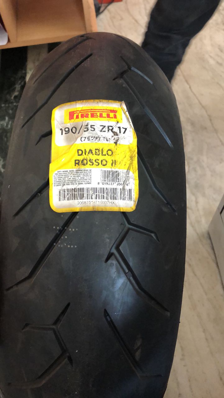

  5. I just ordered a 190/55 Rosso II for my 899, will get back with the results. I doubt I’ll notice anything, as I’m not at all an aggressive rider.

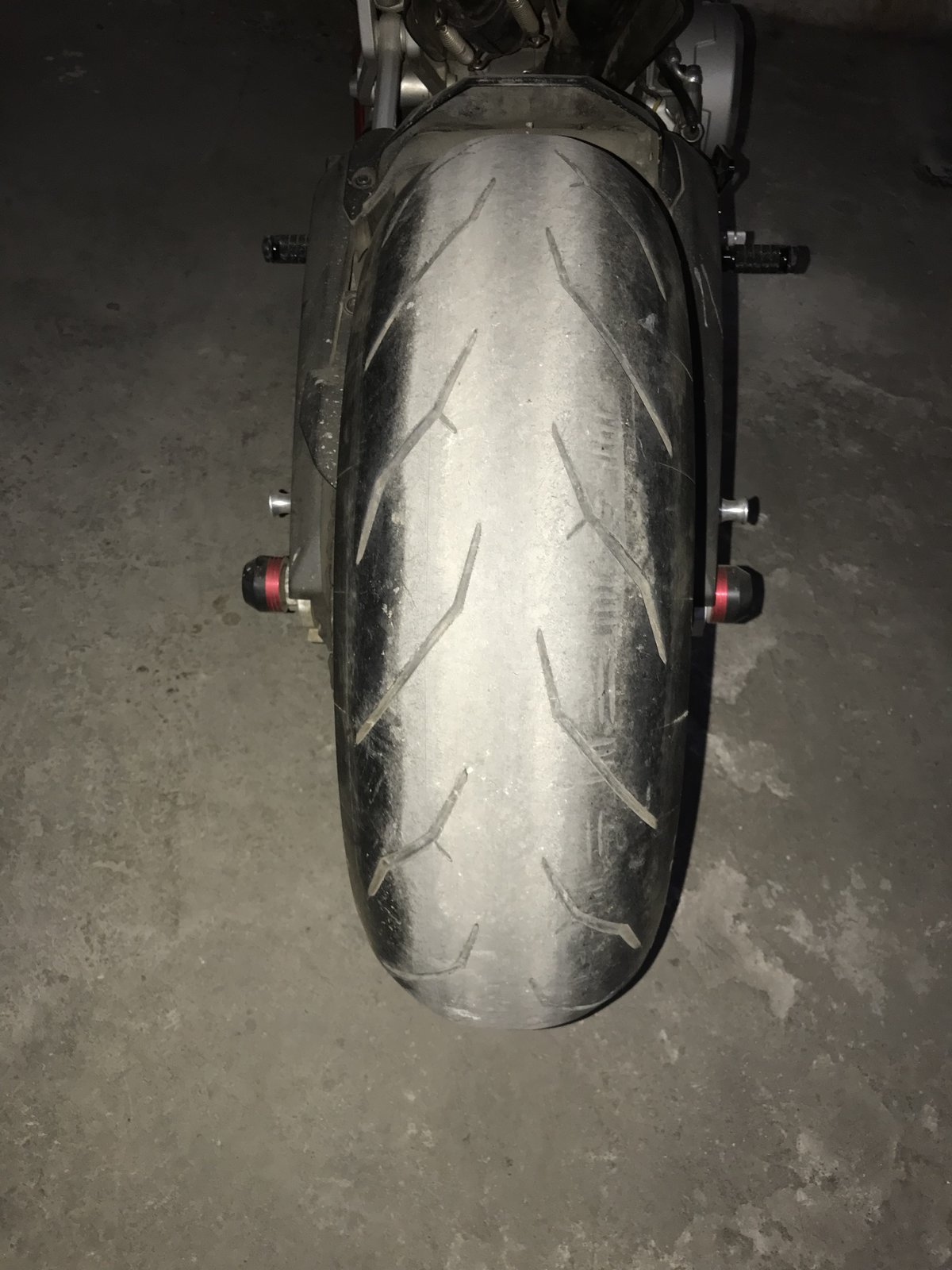

  7. Current tyre
    New tyre...
