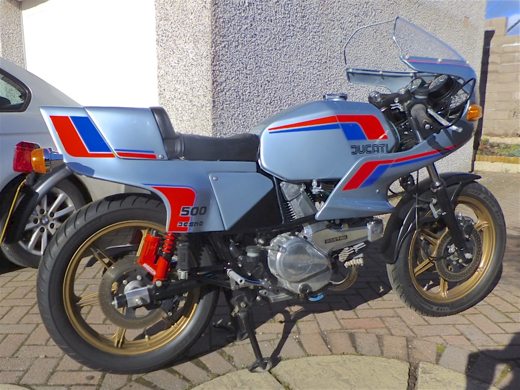

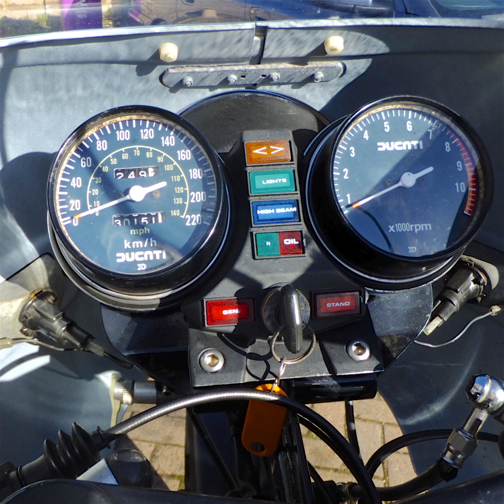

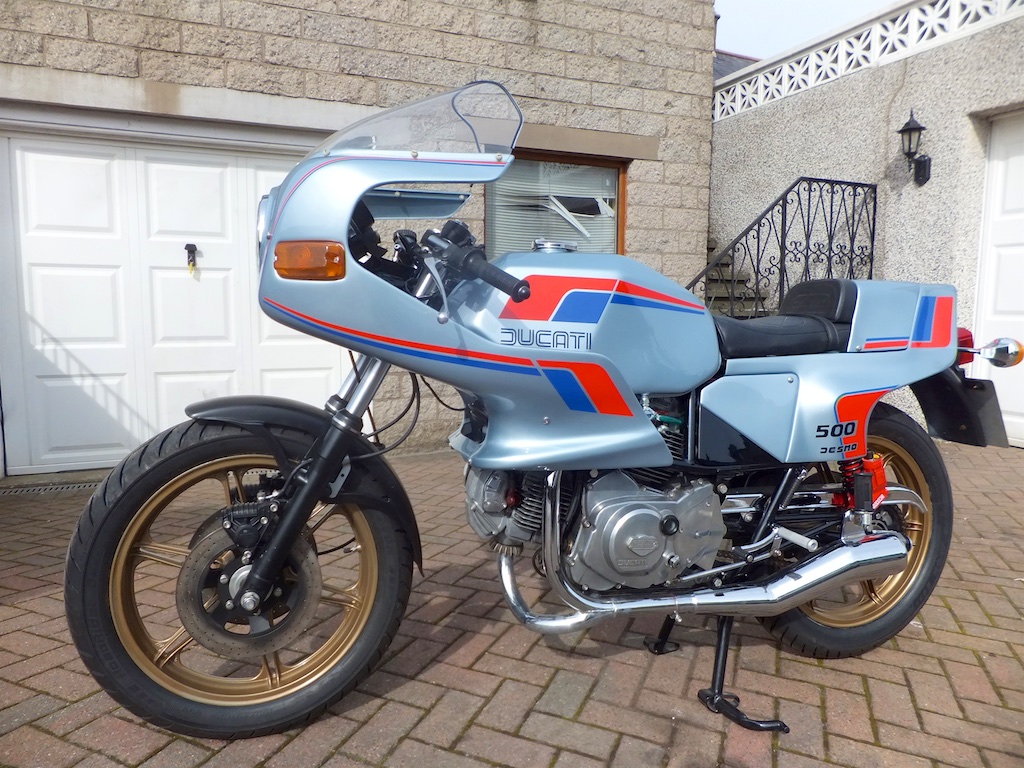

  1. I have decided to sell my Pantah 500SL. It is recently restored and is in immaculate condition. Current mileage is 30,151 km ( 18,735 Miles)

    The bike has had 2 previous owners. The first owner bought the bike new and stripped it down in 1987 with the intention of refurbishing it but 27 years later it was still in bits which he sold to the 2nd owner. However the 2nd owner came to realise that the rebuild was a bit beyond his capabilities so the bike came to me in March 2016 in various boxes of bits.

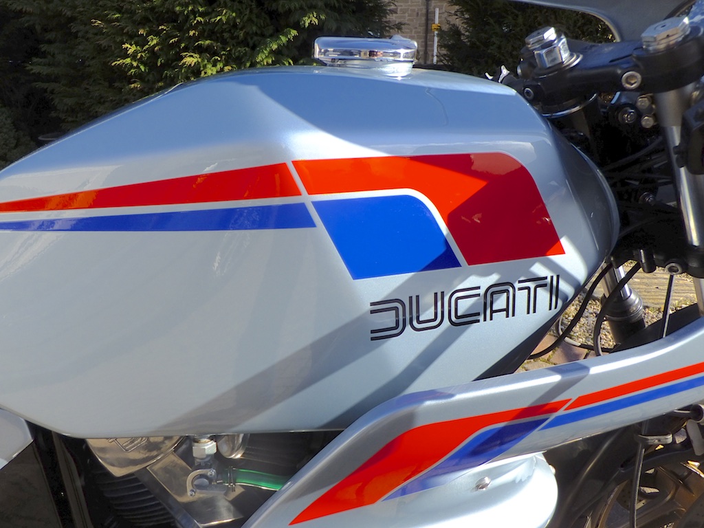

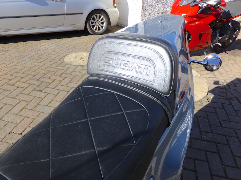

    The frame, swinging arm, instrument/fairing support bracket and centre stand were stripped back to bare metal, primed and powder coated. The tank, seat, fairing and side panels were professionally painted to a very high standard with graphics supplied by Imageworks.
    The chainguard, brake and gearchange levers, rear indicator stem & nuts, brake pull rod, front fairing brackets have all been re-chromed.

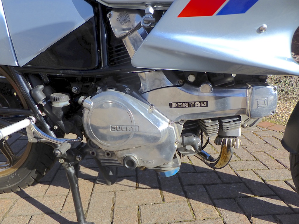

    The heads were removed and the bores inspected, fortunately they were in good order. While the heads were off they were cleaned, rebuilt with new valve stem seals and re-shimmed. New cam belts were fitted and the faulty neutral switch replaced.
    The clutch was inspected and a new crankshaft oil seal fitted. The starter motor was stripped and refurbished.

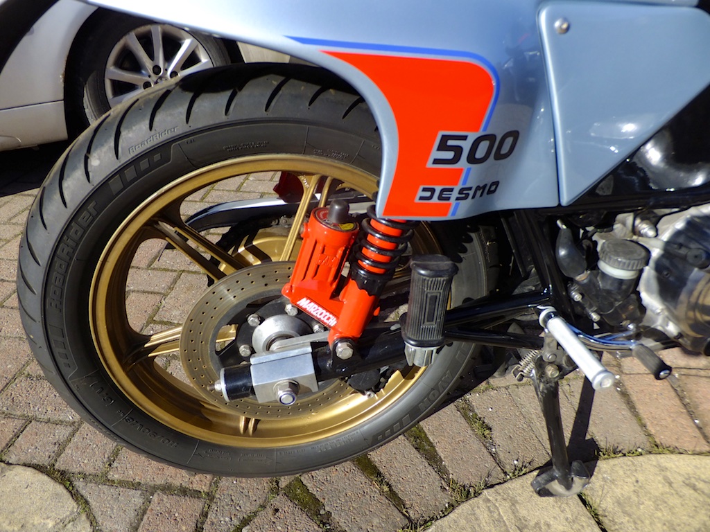

    All brake calipers were rebuilt with new pistons and seals throughout and Goodridge stainless braided hoses fitted. New brake pads fitted all round..
    Forks were checked and new fluid installed. A pair of good used Marzocchi Strada rear shocks have been fitted. These have been repainted and fitted with new bushes.
    Wheels have been repainted gold and fitted with new Avon Roadrider AM23 tyres
    A new fuse box was fitted with blade fuses and the wiring modified with an ignition switched relay to provide a direct feed for the ignition modules. The wiring to the ignition pickups was found to be disintegrating and was completely replaced. A modern charge warning light device has been fitted replacing the non-working Motoplat device.

    The tank securing rubbers, brake and gear lever rubbers and handlebar grips were all replaced. New fuel taps fitted.
    The bike is fitted with a period Conti 2-1 exhaust that came with it. Stainless fasteners have been used throughout.
    The bike was finally finished by autumn 2016 and back on the road for the first time in 30 years in May 2017. Since then it has only been ridden approx. 500 kms. Every thing is fully functional with no problems.
