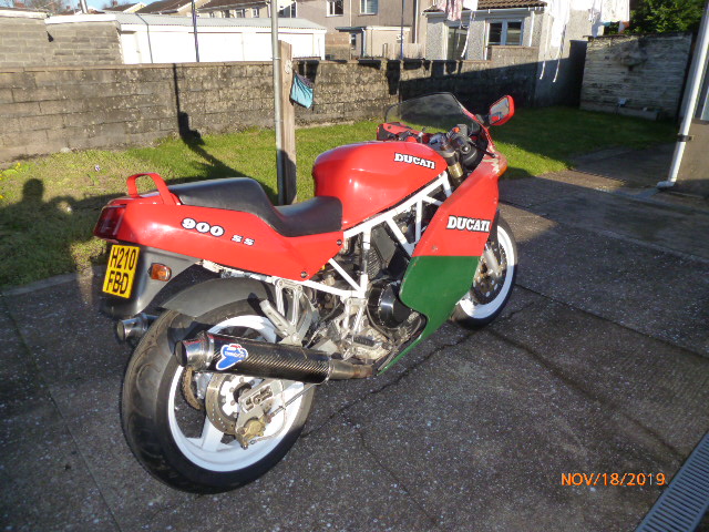

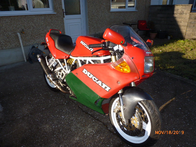

  1. Right lets make a start, the bike as arrived yesterday.

  6. Tear it down completely to the frame and start again with refreshing the engine and then repaint all the fairings including dipping the fastners.
  7. It will not be a mega buck refurb, as i ain't got the funds, but plenty o elbow grease. Snicked an hour on it just now, after another day of shit sifting back into the sewer, bloody near a rubble sack full of wet wipes and the like removed. Stinking.
    I removed the front and side fairings, headlight assy, instrument cluster. I have to fit front brake lines everything missing between master cyl and calipers. ( i have purchased a second hand complete set ).
    No battery with it, plus front tank holder busted so that needs replacing, on the plus side the tank at first glance seems in excellent condition, and in general the frame and cycle parts paintwork are bloody good. Its just the engine that's minging.

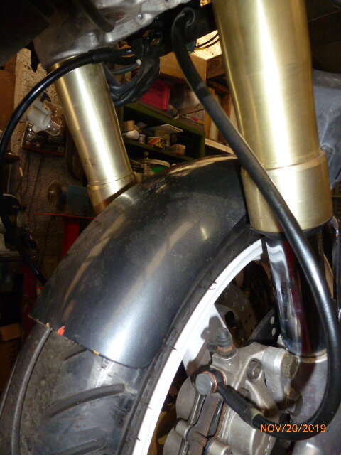

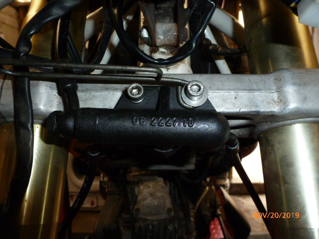

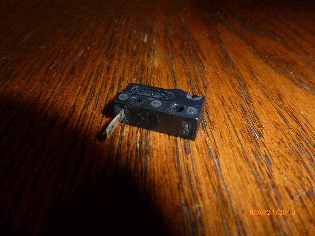

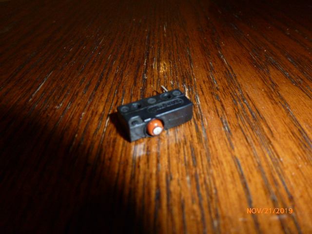

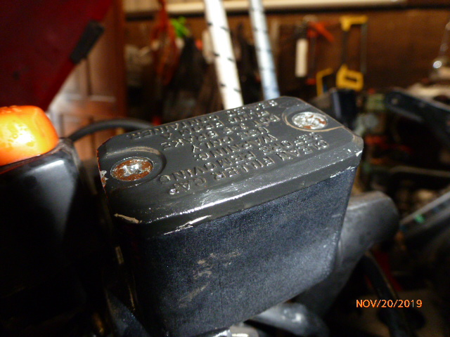

    I got the bike up on to stand, and paid attention to the front brakes. I fitted a second hand brake line set Fren (Black) it came complete with a splitter inc a brake switch for which i can't find any wiring other than the the front brake lever switch, which btw has a busted terminal so will have to source one of them. Not sure if they look right. Plus i got one stubborn cross head own brake reservoir. Tried gentle tapping no go at the moment.

  15. Not seen that splitter on the brake lines before, however there were differences on the earlier models, mines a 93 and my mate has a 92 and there's several differences. Can't confirm battery as I have an Odessey 680 in mine.
  16. YB16 AL-A2
  17. the splitter is ok for the year, early 851 had the same/same location also complete with hydraulic stop light switch. Maybe a later master cylinder has been fitted with provision for mechanical switch or maybe provision was there as std but just redundant. There are other features like this certainly on the engines of around that era. Battery as above stated by c.n.f.
  18. The wiring for the front lever switch has tiny spade connectors, i think i will snip them and fit the bigger ones for the splitter switch. Yes the battery numbers are ones to watch the vary in size of battery according to the lettering it seems. YB16-B is wider than YB16-AL, cheers lads.
  19. After much tapping away at the one stubborn cross head on the brake reservoir it broke free, and was able to bleed the system through. The lever is a tad spongy but all the air is out. The inline brake switch on the splitter proved faulty ( thanks Chris) so i will replace the microswitch on the brake lever as it's busted. Cheapest on listed on Fleabay £20, rip off.
    After a bit of research i located these £7.20 for ten. Can be used for 2 or 3 pin. Waiting for the right battery to turn up .
