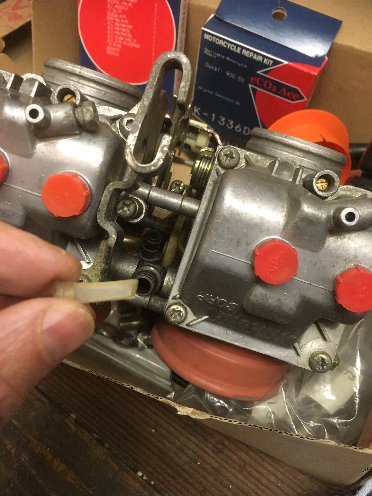

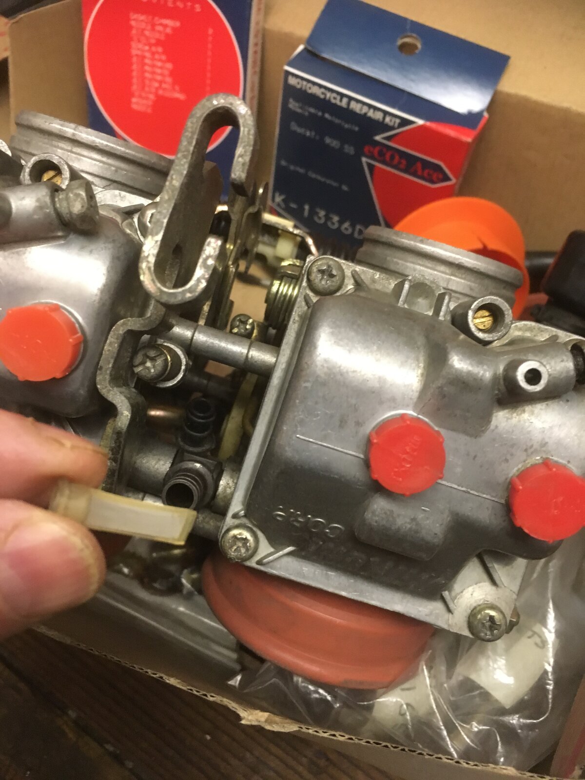

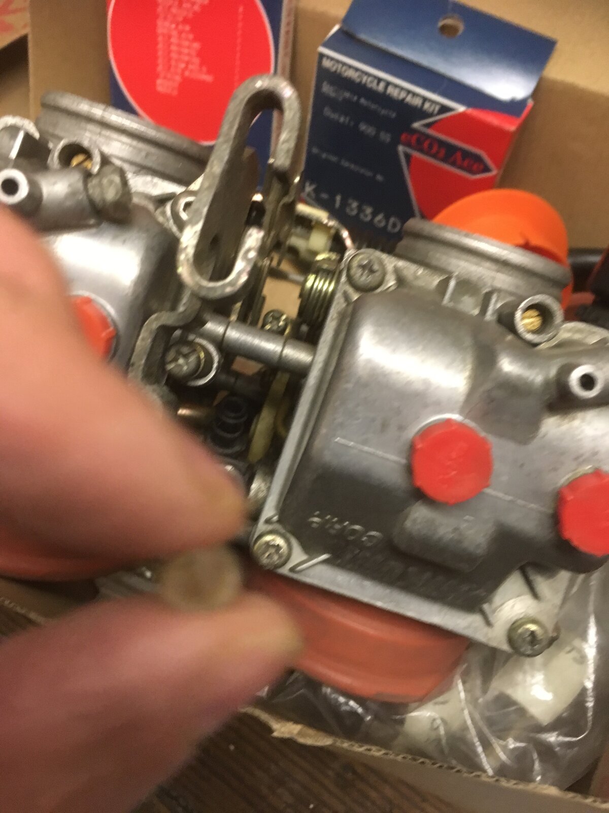

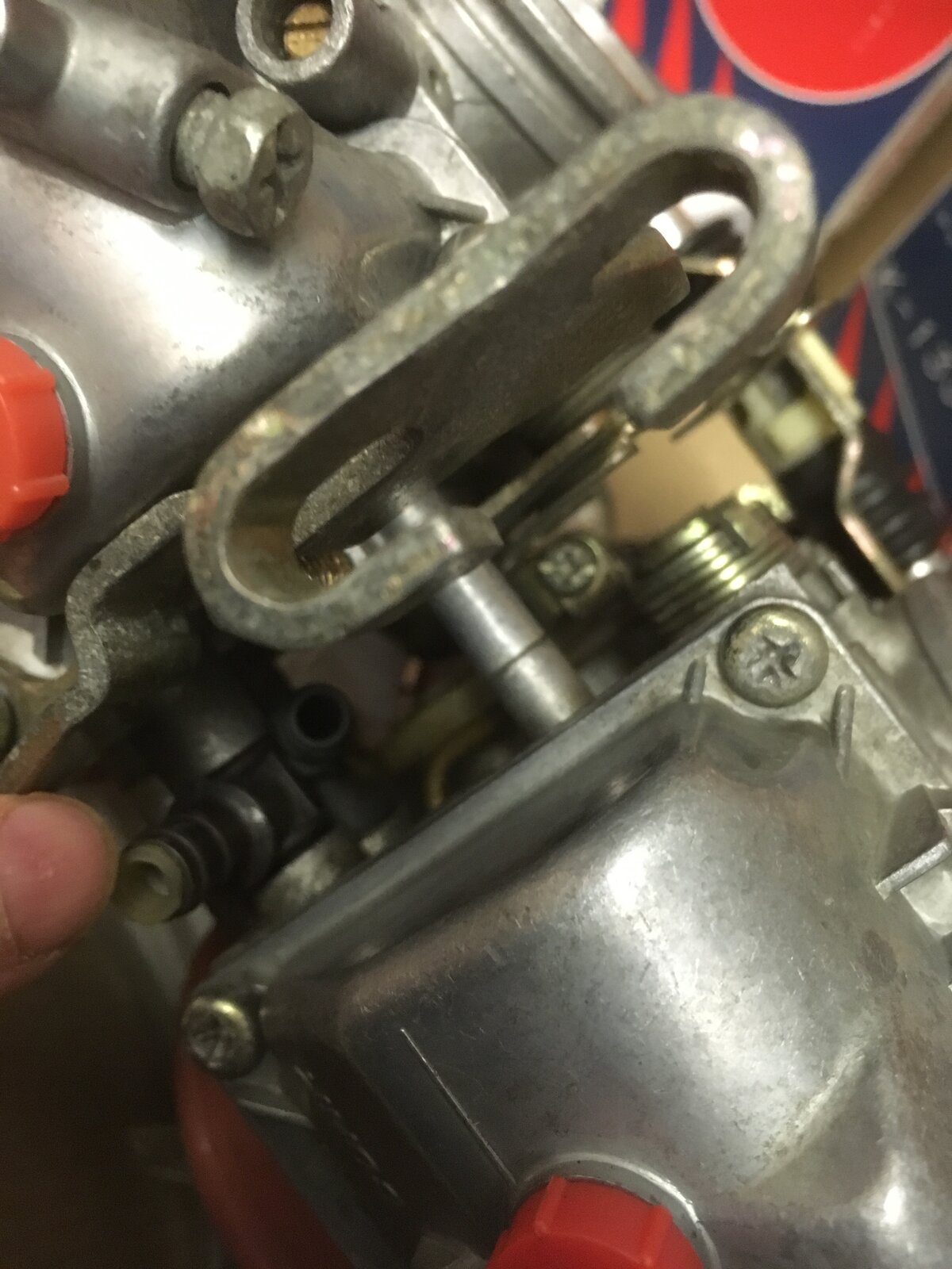

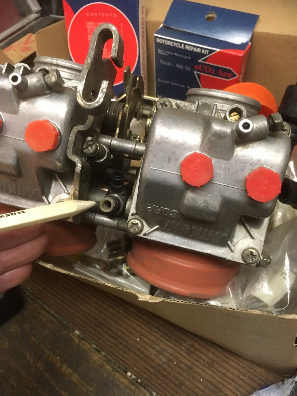

  8. BE8917FE-8D55-4D00-971A-909050EE3D55.jpeg 4C2EB13A-66FF-47A7-9114-C3F4A874C637.jpeg E33E1696-CBDA-496D-959E-701B02BFE393.jpeg 7475483F-F425-4208-9DB7-4EED7A7EE483.jpeg 7D4FF08A-47FF-44C6-B476-6D4EFD1A9C61.jpeg Hi Ed, if you still have your carbs off the bike you should be able to check for any blockage in the fuel feed lines as there is a small filter in the feed line at the carb inlet, or there should be unless it’s already been removed, it’s a small sock type filter that just sits inside the carb inlet tee joint,

    I'd previously cleaned the small filter during the first disassembly and have checked it at each of the subsequent tear-downs. I've not picked up much or anything at that filter.
    Ed
