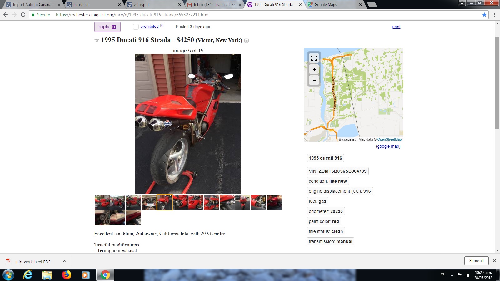

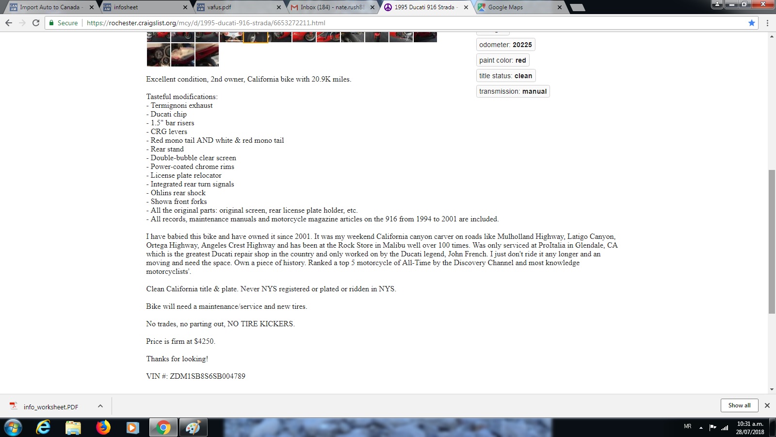

    Fast foward to now, and I'm browsing Craigslist, when a very clean 95 Strada comes up (listed that day) with an asking price of only $US4250. Checked location: 5 hours drive away? Boom, in like Flynn!

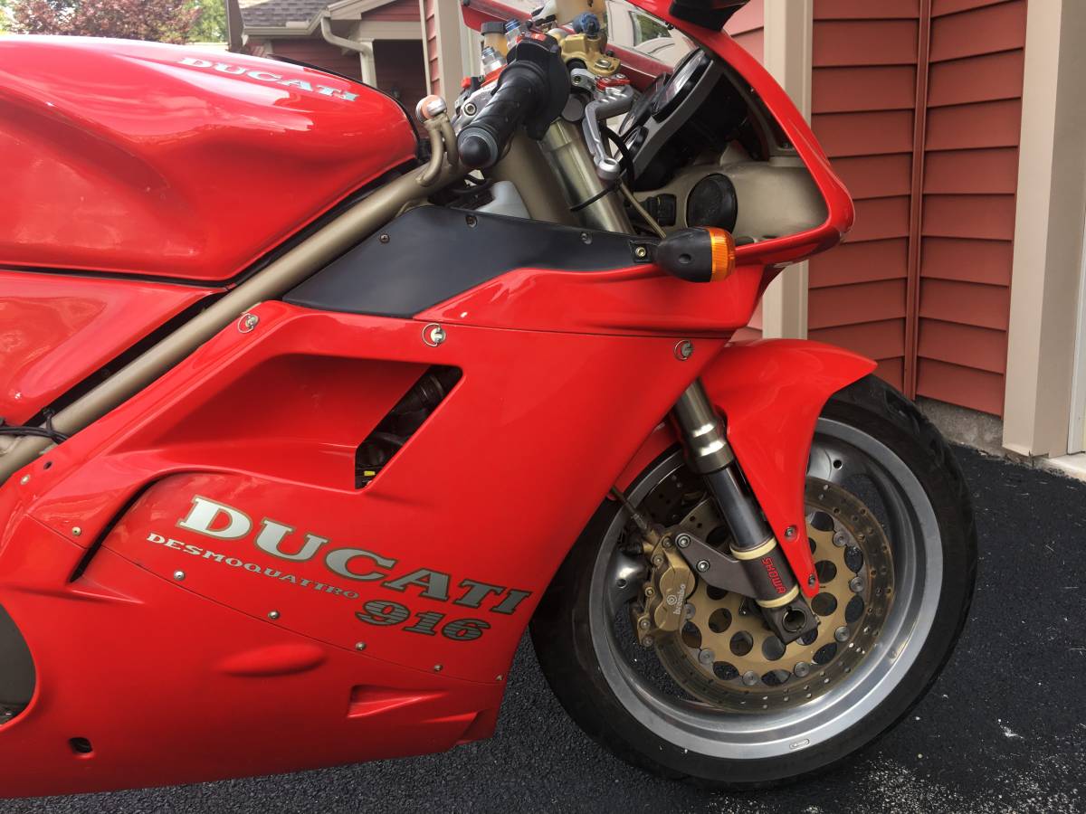

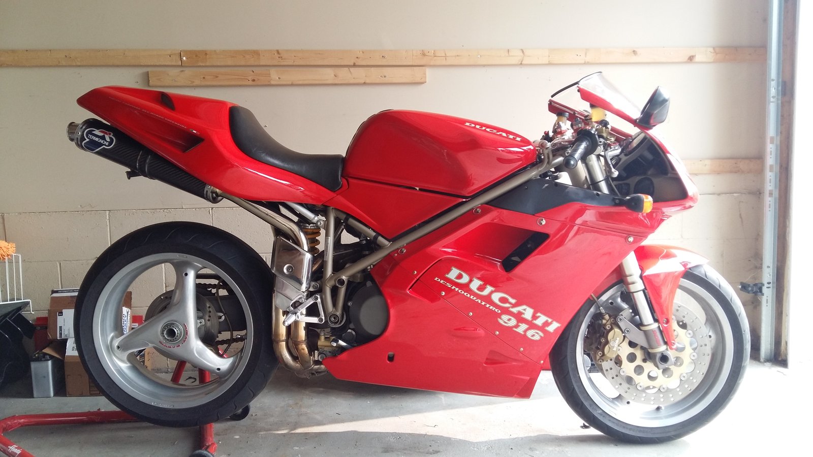

    Had forgotten how compact the design was. The Termi's looked legit, as did the rear Öhlins.
    Notable downside was that it's been a garage queen since 2007. Hasn't even been started, let alone ridden, in the time since...

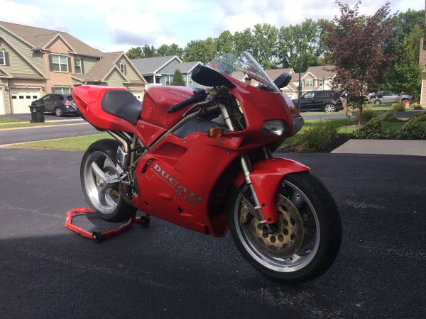

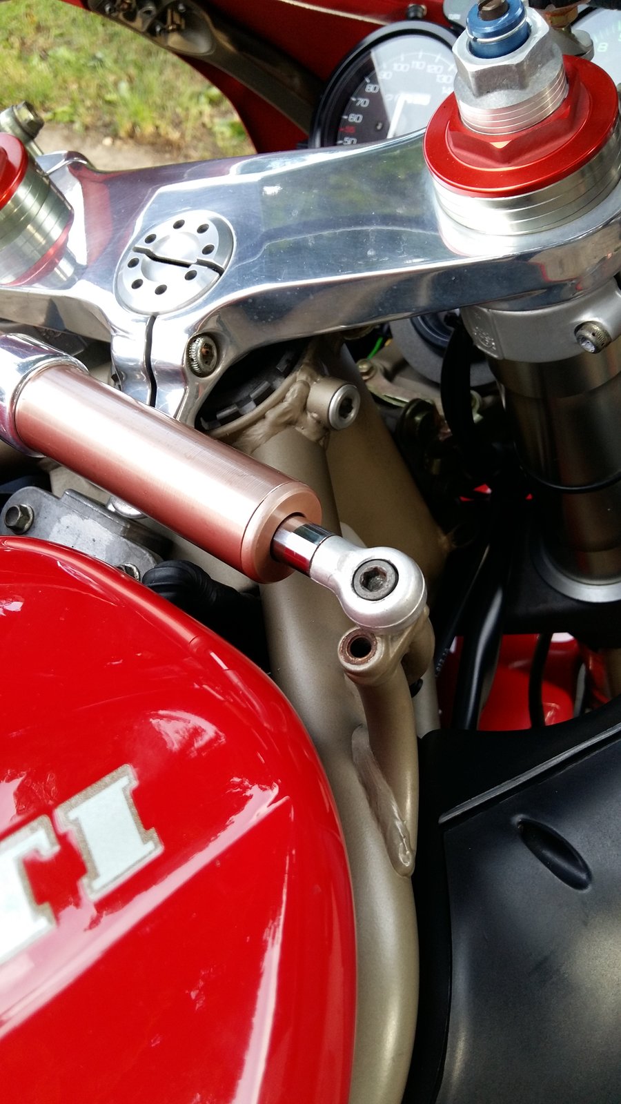

  4. So straight away there are, of course, some essentials like fluids & filters, belts & brakes, but one thing I hadn't planned on, but was required, was modifying chassis geometry.
    When I went to lock the steering the first night, no dice. The ignition position was clearly in 'lock', but the bars moved freely. Then I saw the steering damper frame location:
    I remember seeing something in the Haynes about it, and sure enough the front mount and therefore entire steering head angle is set-up for track-use.
    A quick peruse of the service history showed an order for a rake adjustment in 1999. Has it been like that ever since?
    My Haynes bible indicated the factory reset task as 5-spanners on the difficulty scale. Fantastic option first up.

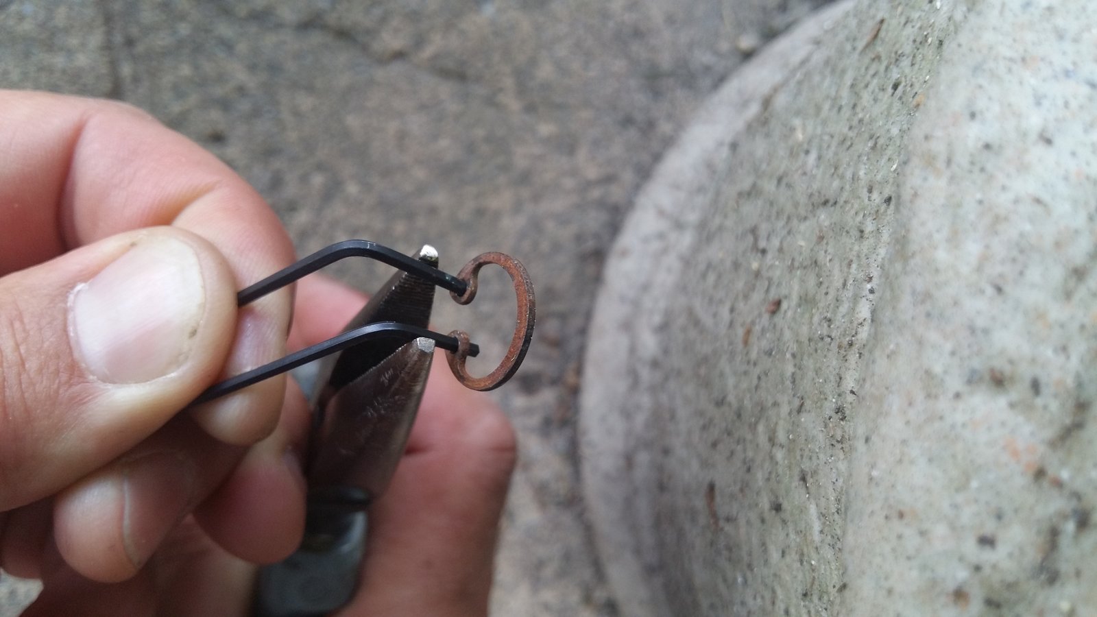

    First step: remove circlips from the clamp bolts. Getting internal circlips out is never fun, especially when you don't have the specialist pliers.
    Fortunately, #8 wire is good tech.
    I grabbed two tiny allen keys and slotted them into the holes, then got my needle-nose pliers into the act. Easy.
    #4 TNR, Aug 31, 2018

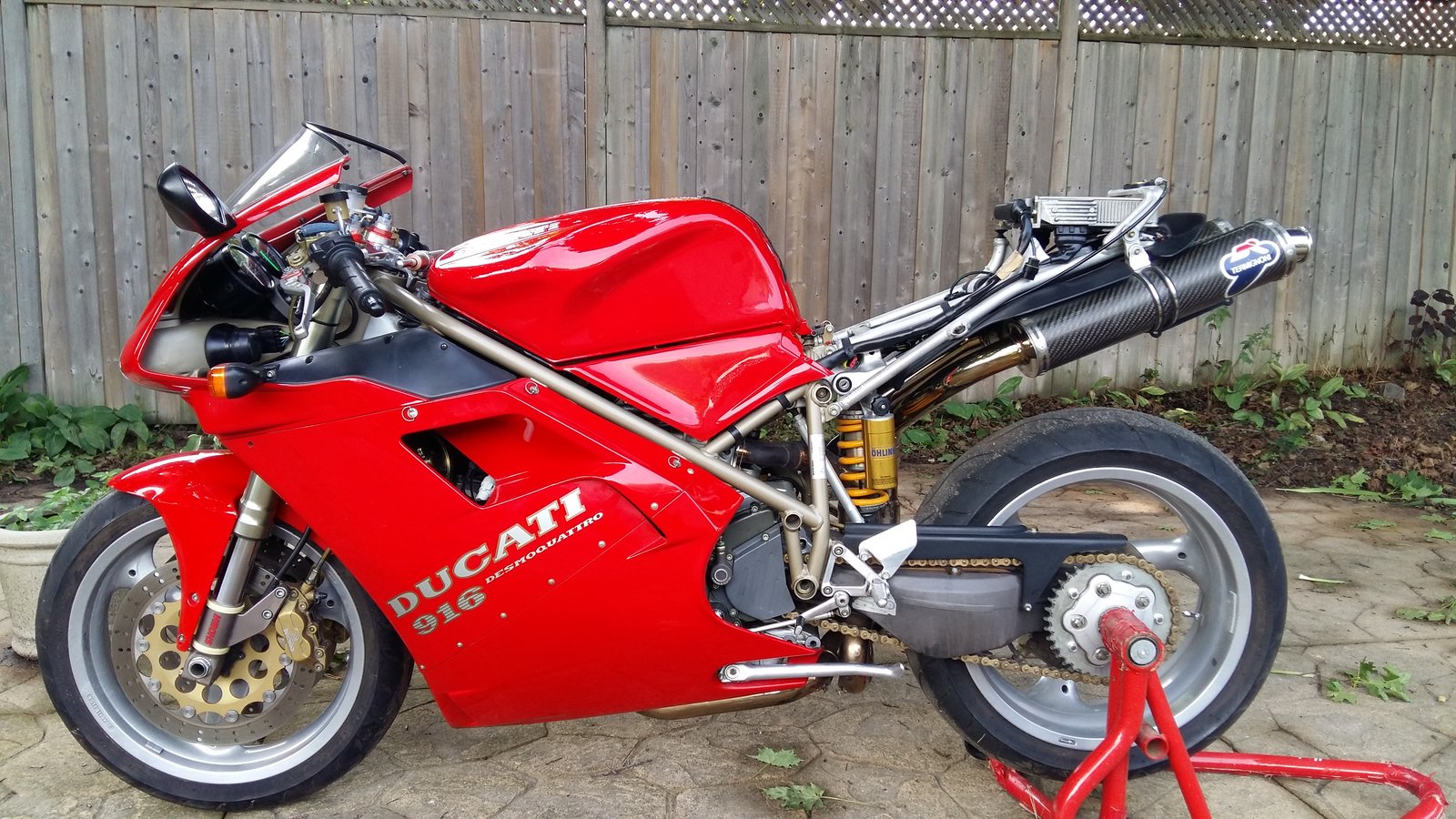

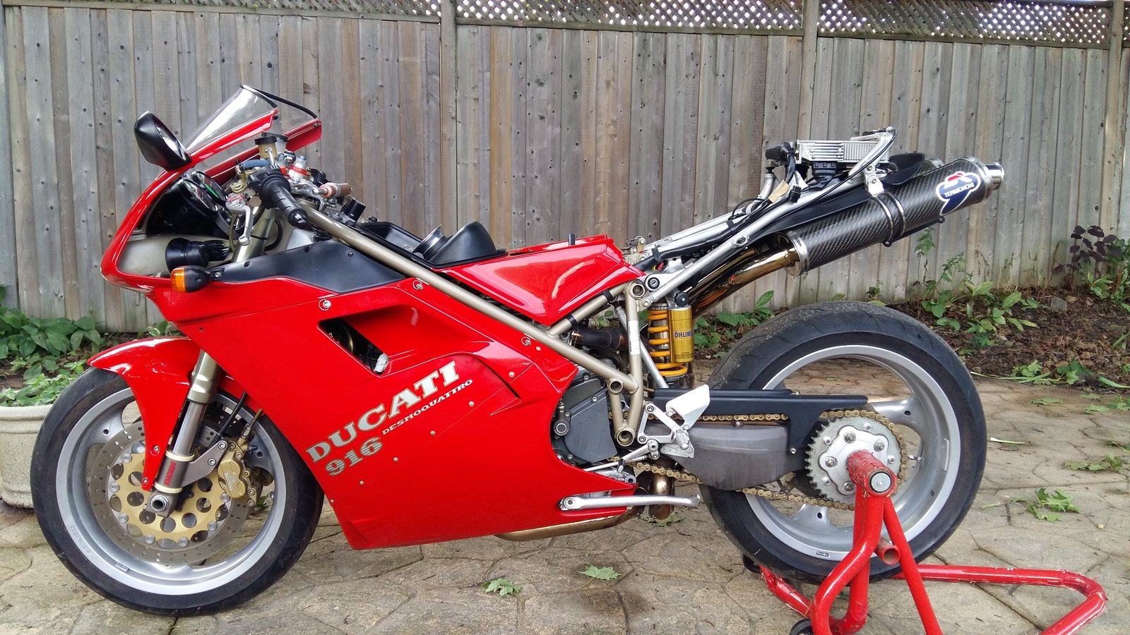

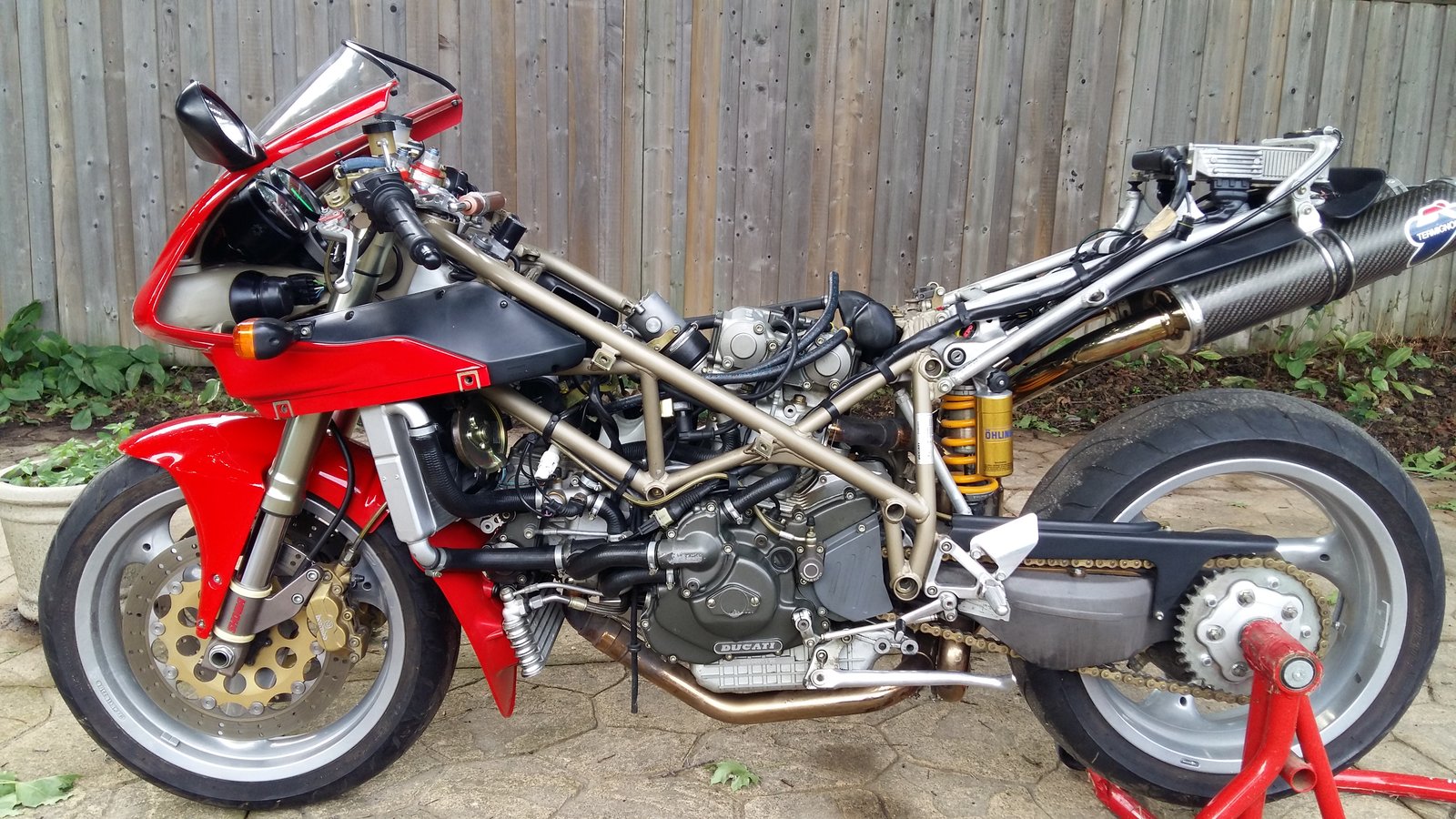

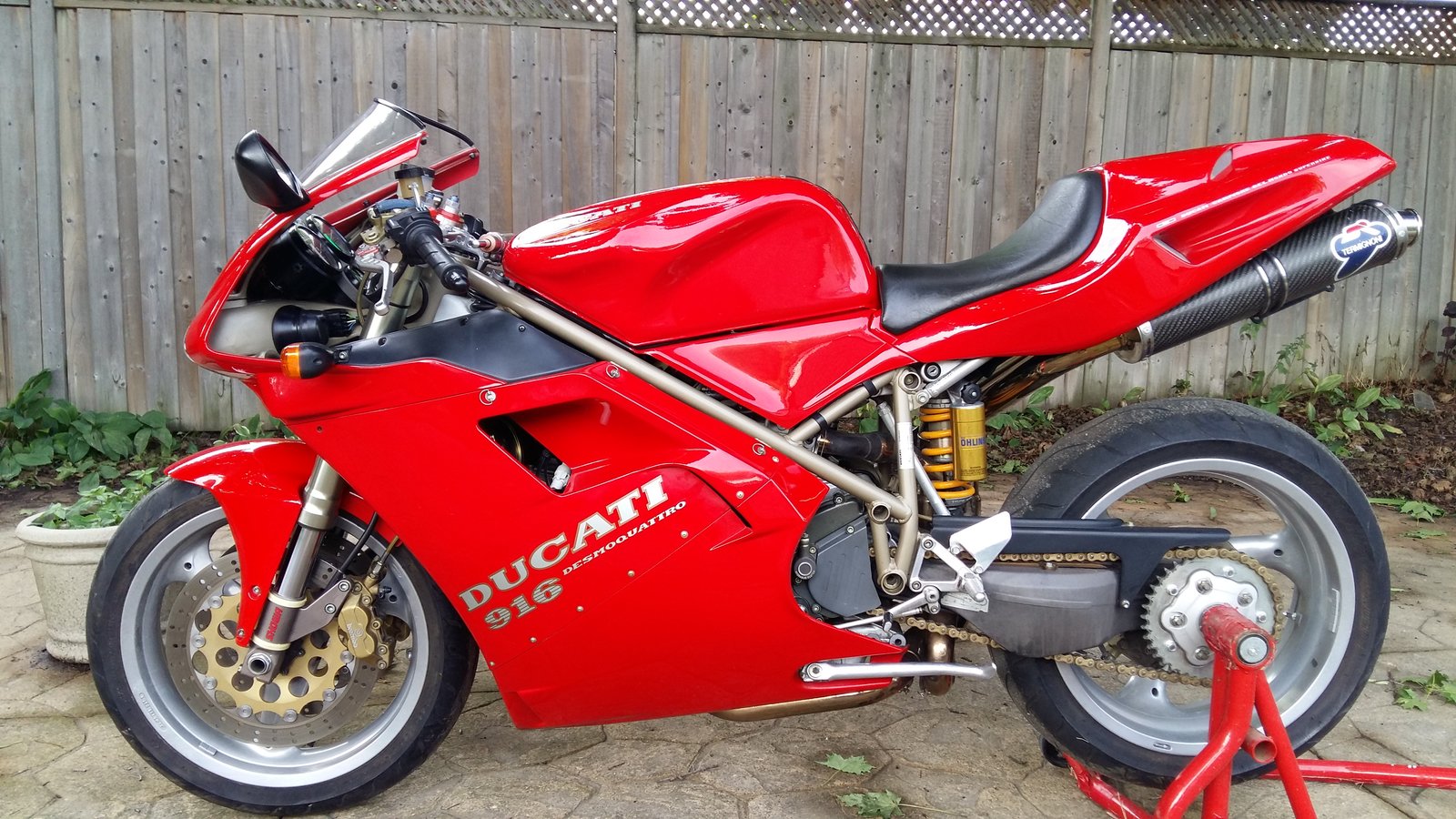

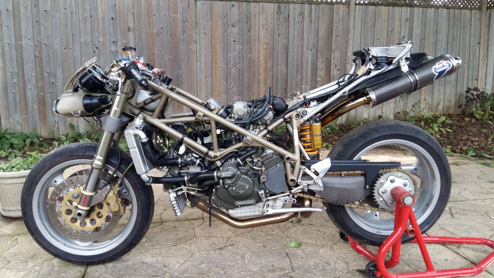

  5. Finding a c-spanner to rotate the adjuster tube in the steering head wasn't proving easy, so removed all bodywork while I waited:
    #5 TNR, Aug 31, 2018

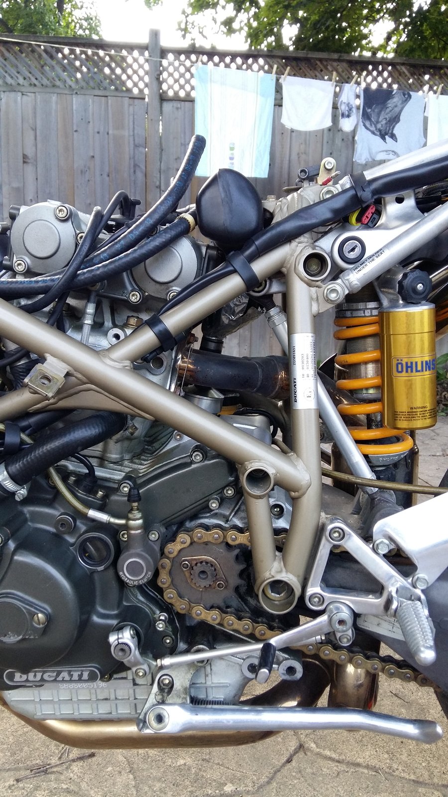

  6. @TNR is that an sp mate?? It's got the same ecu and rear sub frame as my 996sps :thinkingface:
  7. Nah, it's deffo a Strada (aka Monoposto).
    '4V DOHC' visible on heads, unlike SP's.
    P8 ecu was shared on a few models, and aluminium sub-frame was standard on single-seat bikes (I think).
    #8 TNR, Aug 31, 2018
  8. You could always email Ducati. they are quite helpful on clarification
  9. How did you take this photo?
  10. He is the only man on the planet earth who has three hands:thinkingface:or a Alien;)
  11. Camera was on a timer. Positioned on my knee.

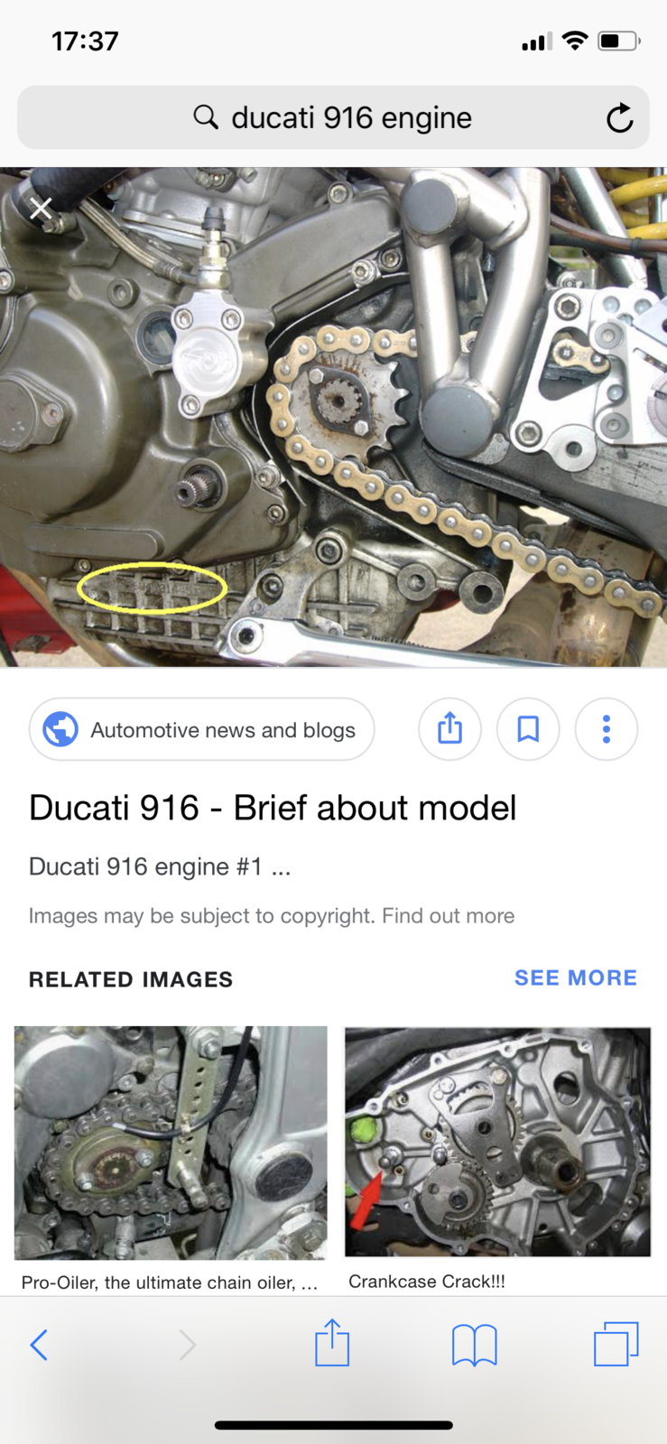

  12. Must admit, saw that ECU and twin ignition pickups myself....
  13. Twin ignition pickups.... help me out here, do you mean twin injectors?

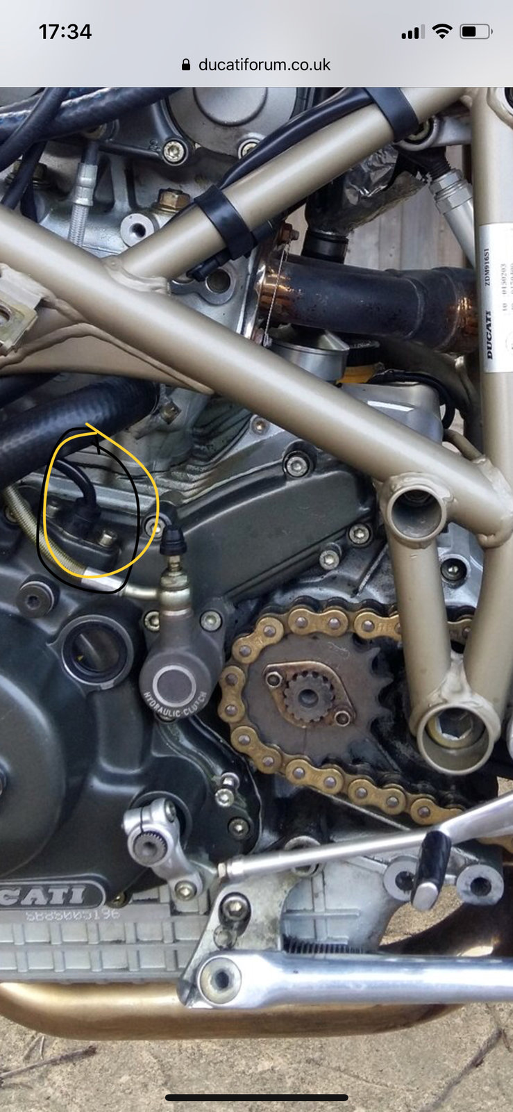

  14. As per attached this circled and then another further around the front of the motor..
    It’s unusual as if you just google images of a 916 engine you will see that the circled item isn’t there it’s just blanked off. The 98 SPS has it, but that is a 996 engine running the same huge ecu as yours has. I didn’t realise that some of the early 916 had this setup too
  15. Thanks for the info. I know that US-spec '95s got the Ohlins shock as standard (according to Falloon), but don't know much about the ignition pickups. Do I need to keep them in mind for anything?
  16. I believe early 916 Strada all had P8 ecu which requires twin pick ups for ignition.
