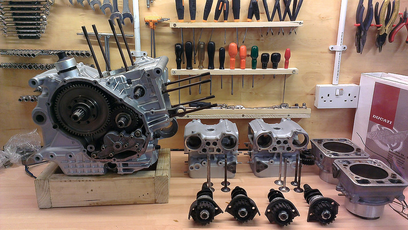

    Cases cleaned & painted
    New mains and gearbox bearings fitted
    Ready for reassembly
    Checking end-float and shimming
    Bottom end buttoned up. New big end shells fitted.

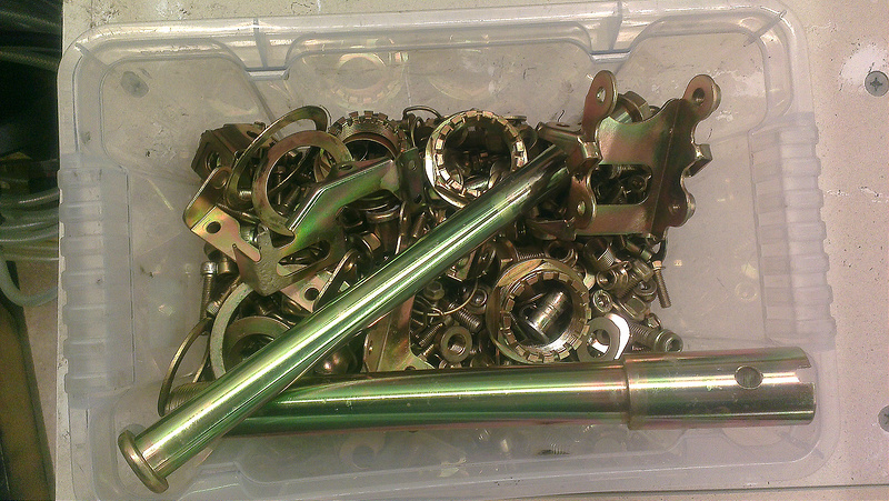

    Fasteners back from the platers
    Getting ready to do the top end
    Selecting the best set of rockers
    Checking shims and cam timing
    Frame & swingarm on
    It's tough remembering how it all goes together after 7 years in boxes!
