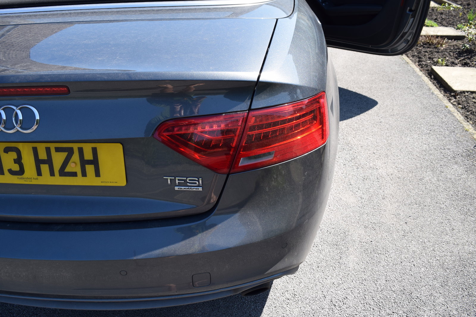

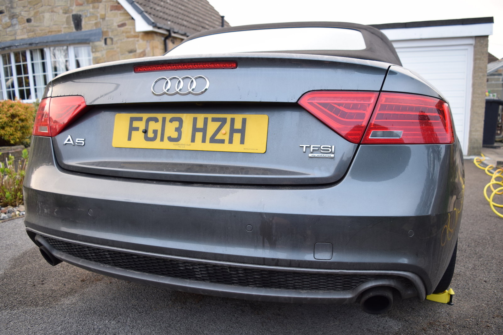

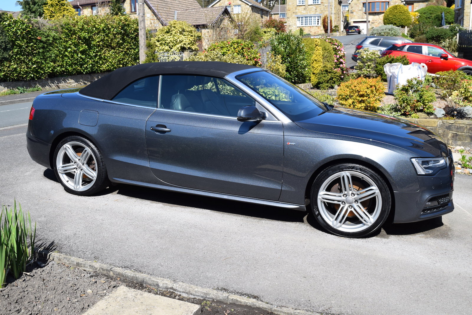

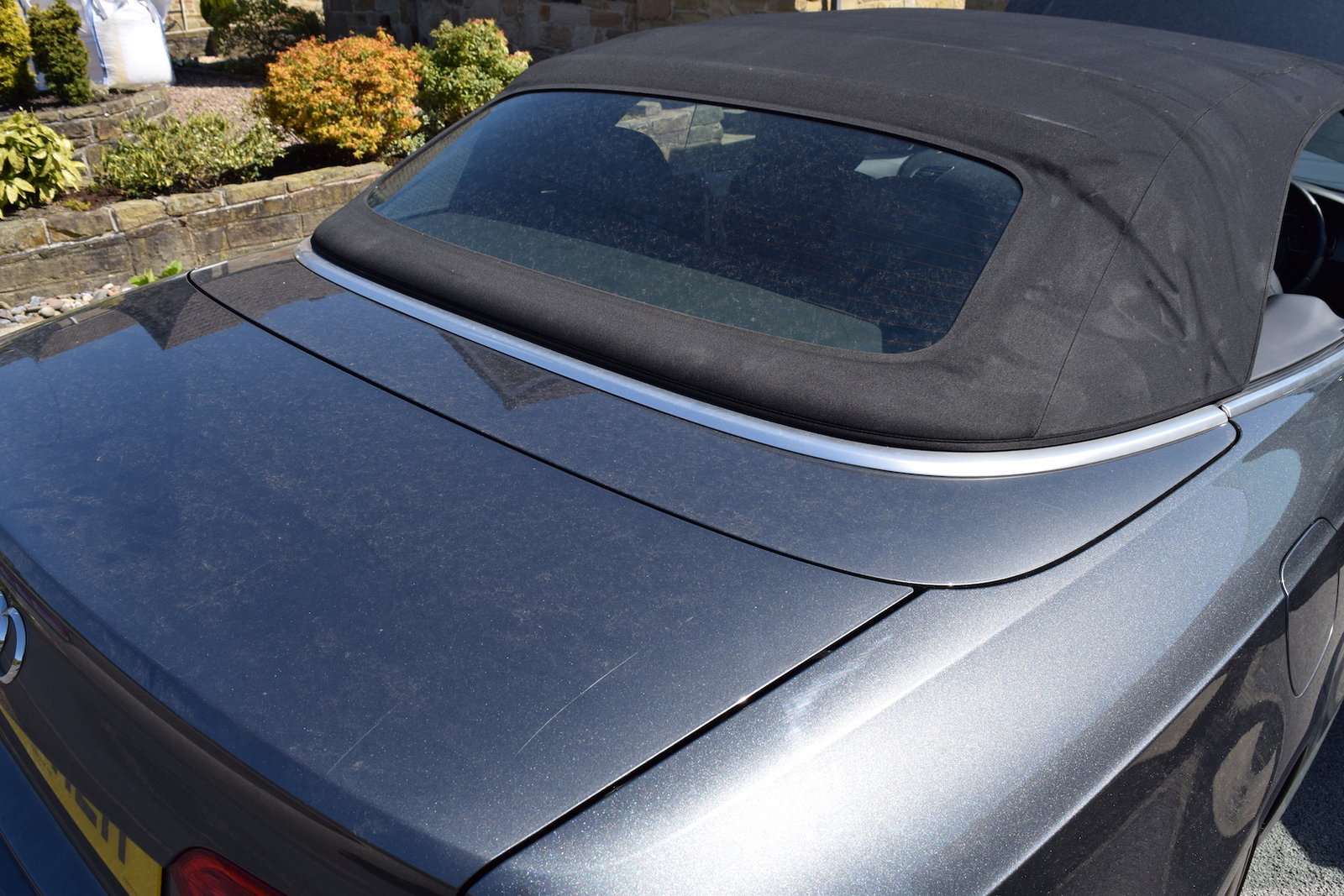

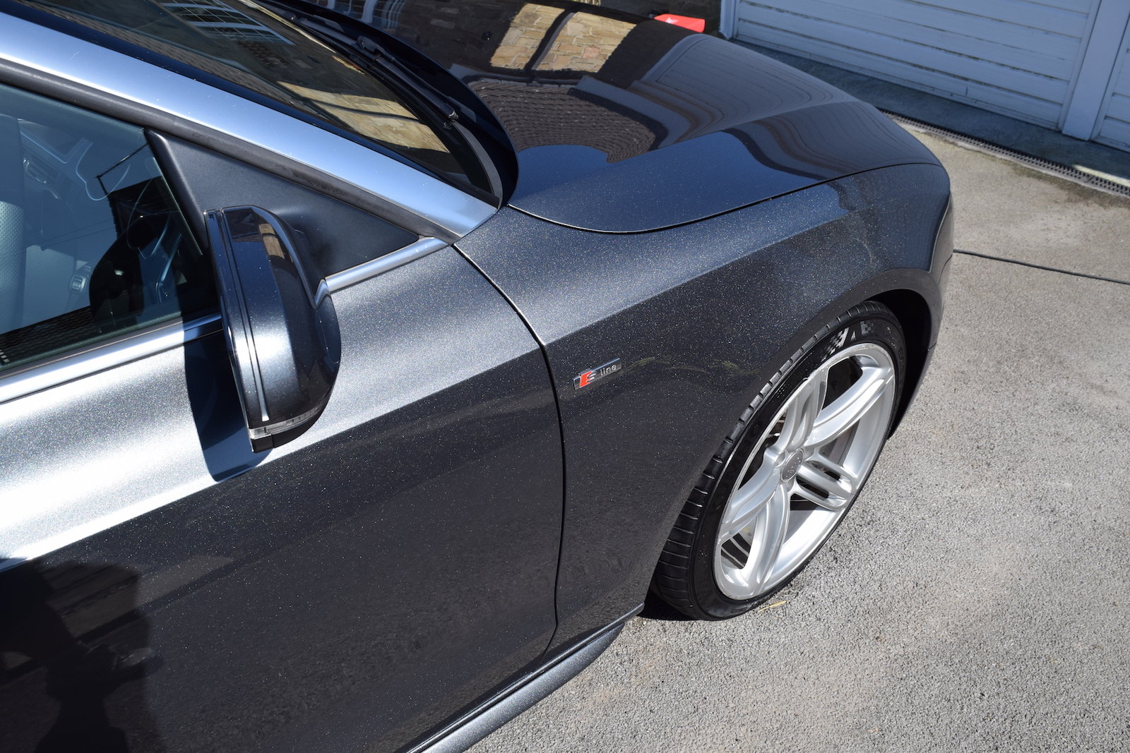

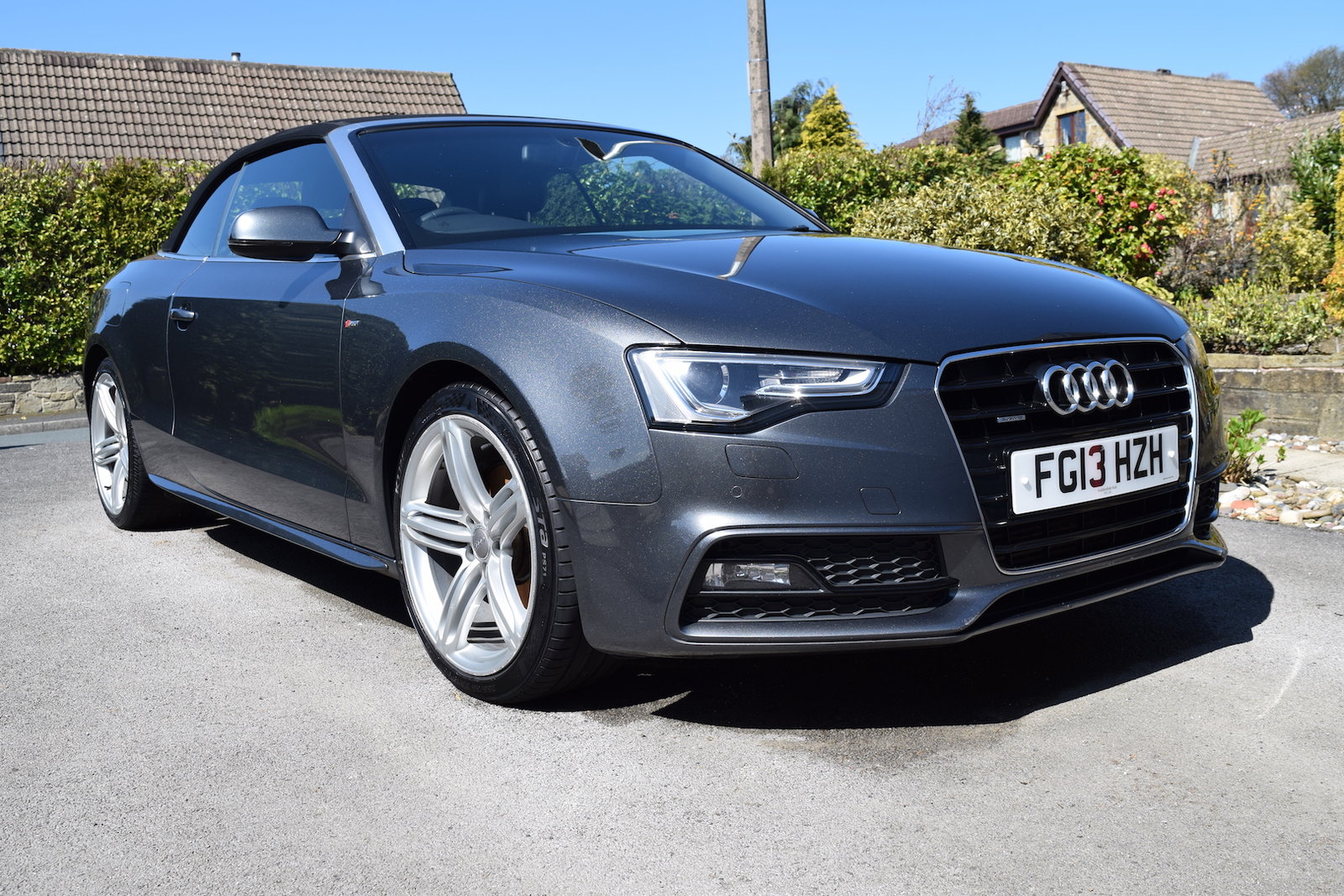

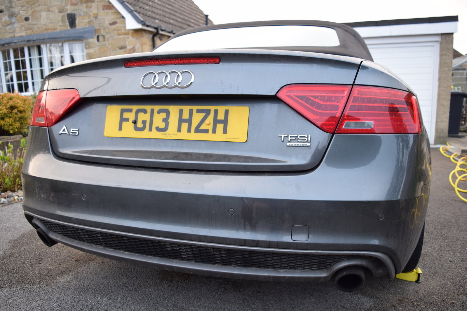

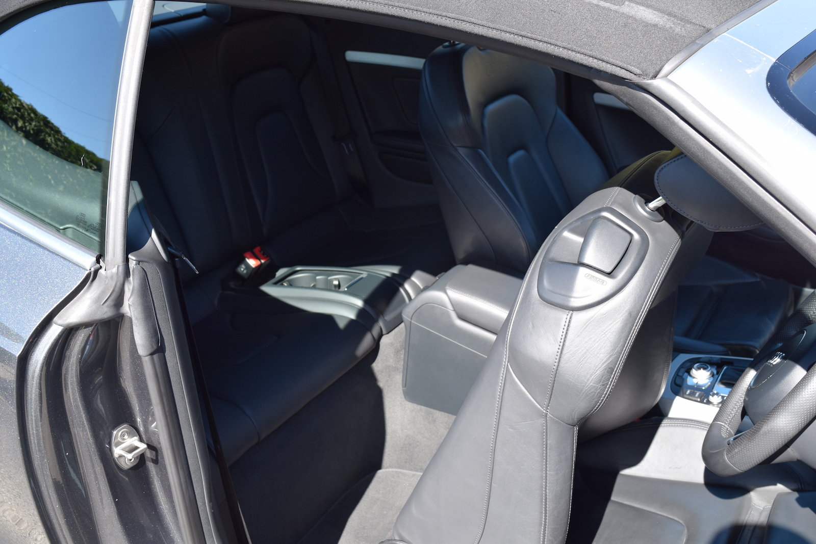

  1. Vehicle is an Audi 2.0 quattro Special Edition Cabriolet.....Well folks this has to be the worst condition vehicle I have had the pleasure to get my hands on. This was a pre-sale detail for a client. Both sides of vehicle heavily...and I mean heavily scratched and marred. Vehicle had no love for over 5 years and it showed

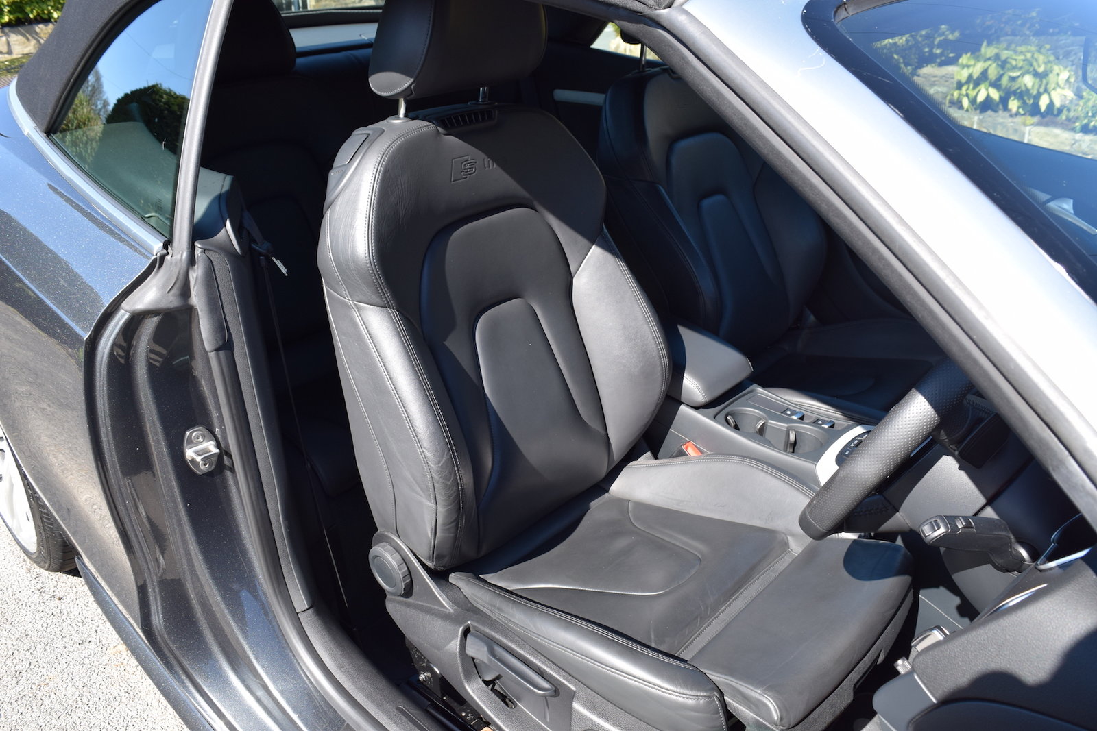

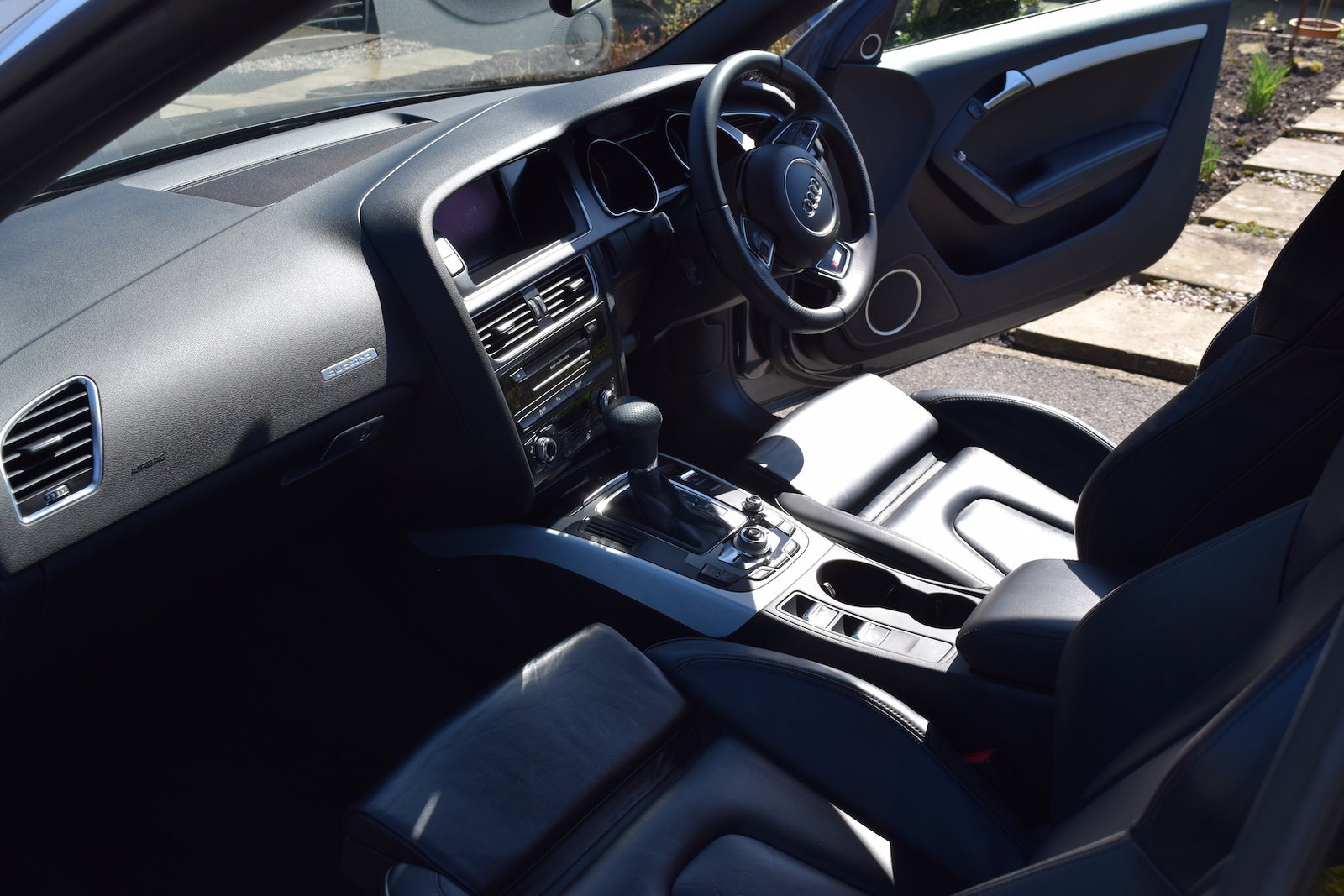

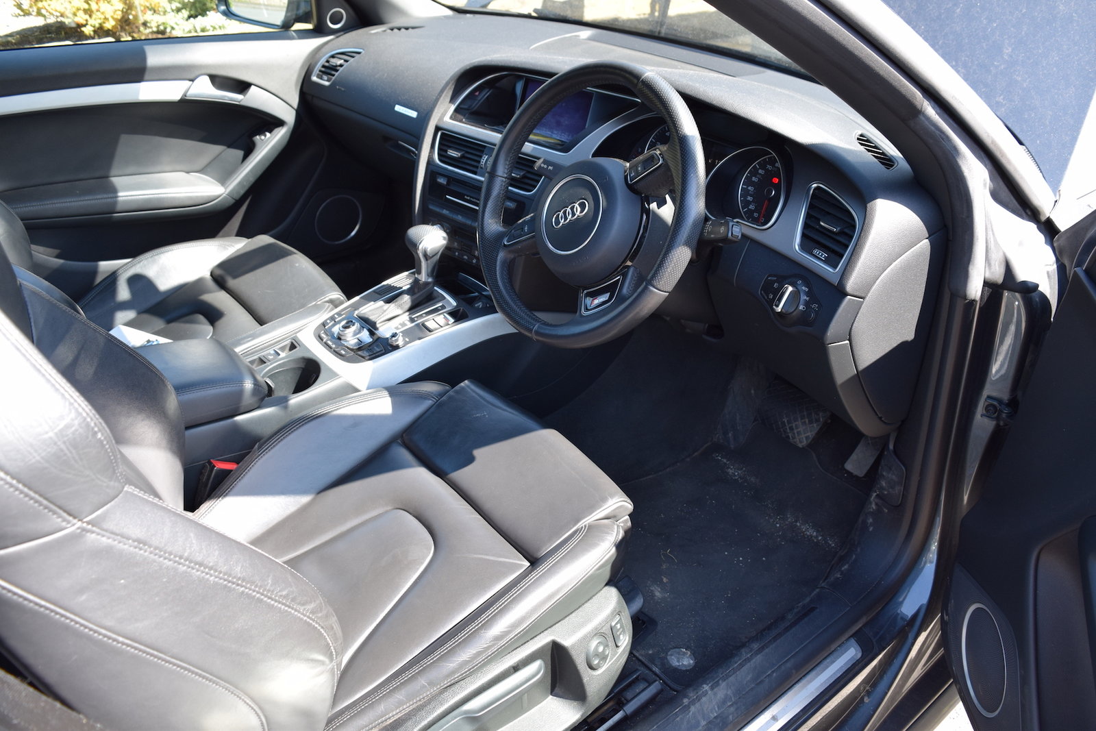

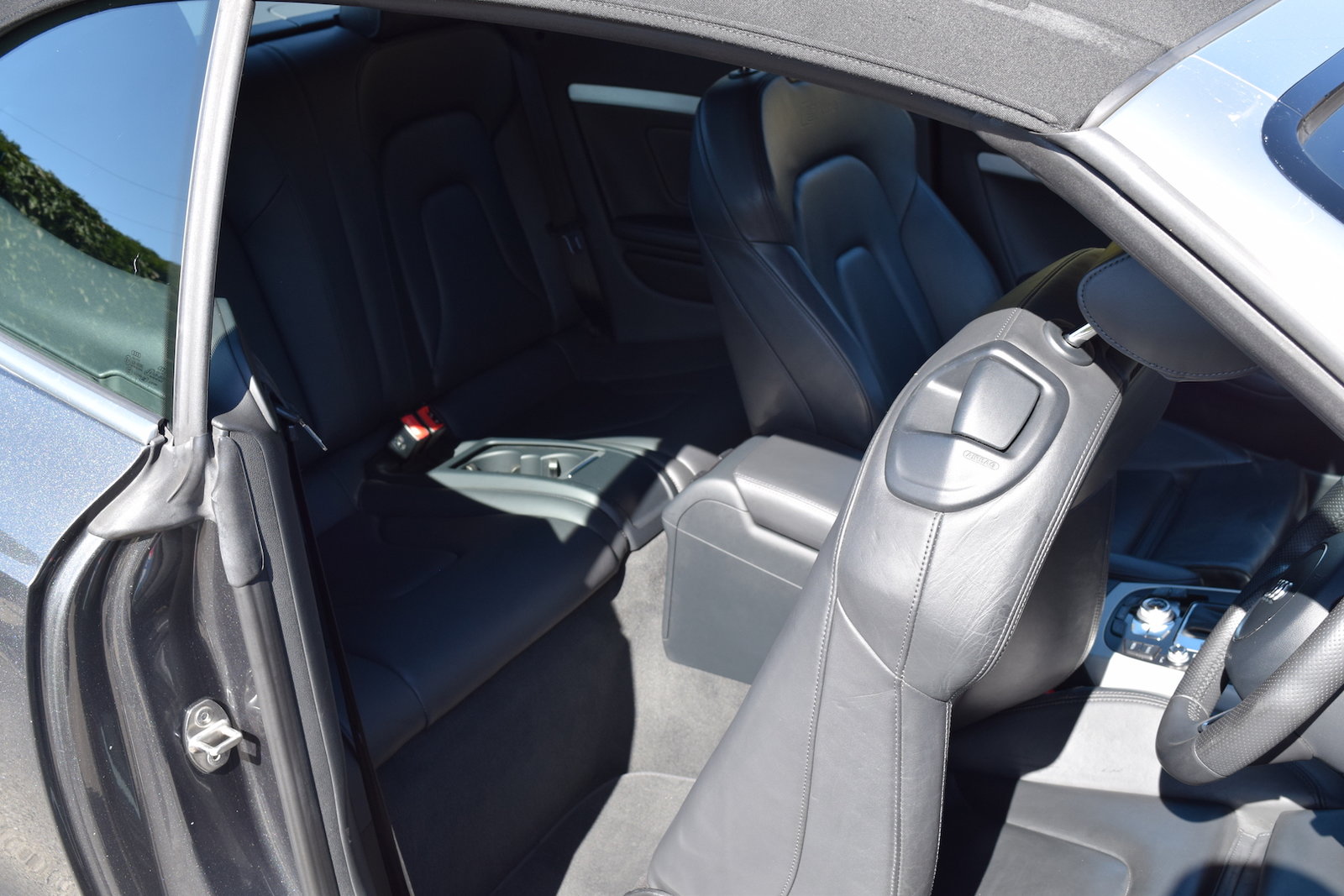

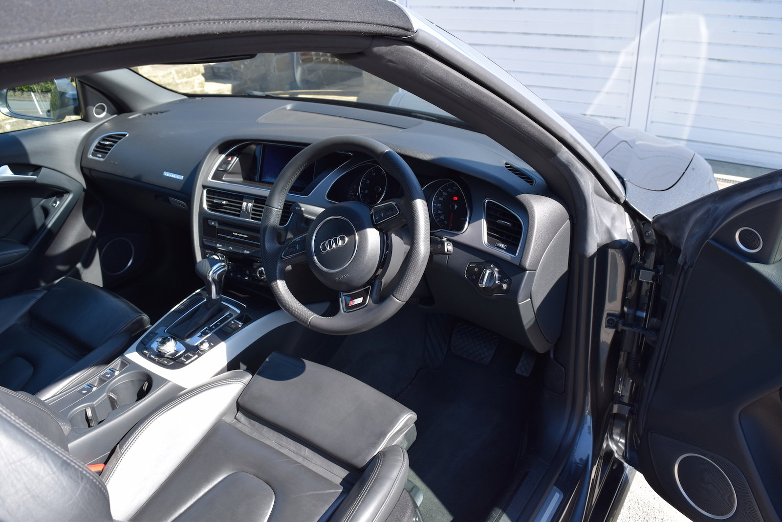

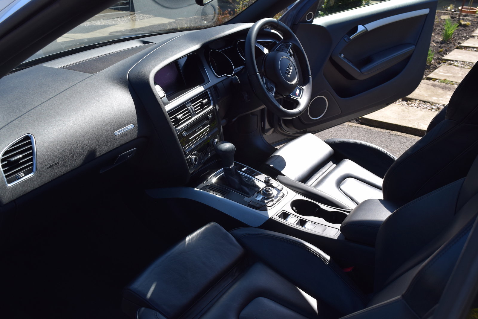

    .....wheels were really needing a refurb as they were very bad.....anyways interior first.....whole interior steam cleaned and addition of Gtechniq biocote* Triclean to get every surface back to factory.
    Seats were glossy so much was the ingrained dirt and grime. Interior obviously vacuumed and all mats were cleaned with a Karcher Puzzi 100/1 extraction machine.
    Glass cleaned with Angelwax vision and all surfaces dressed with 303 Areospace protectant.

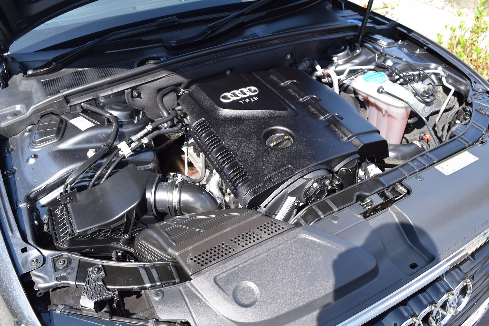

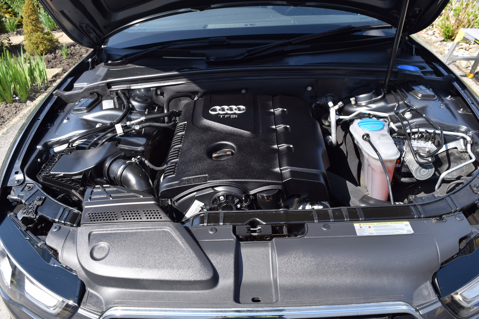

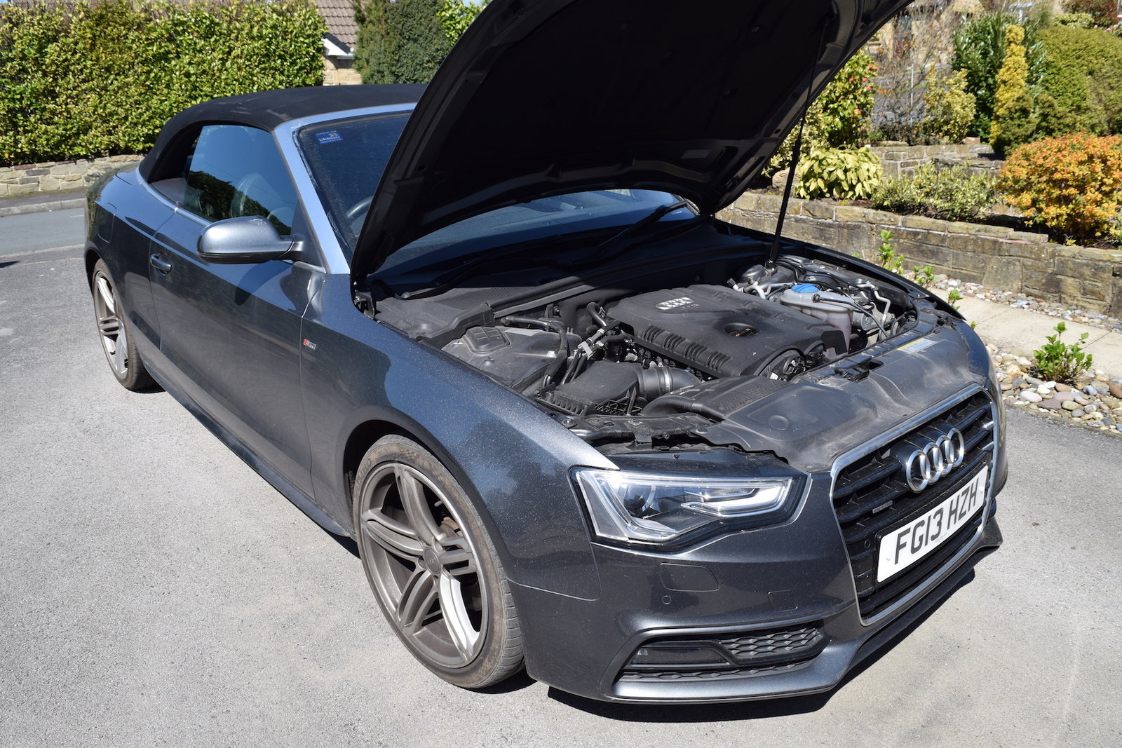

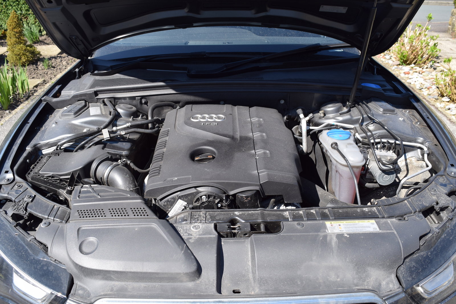

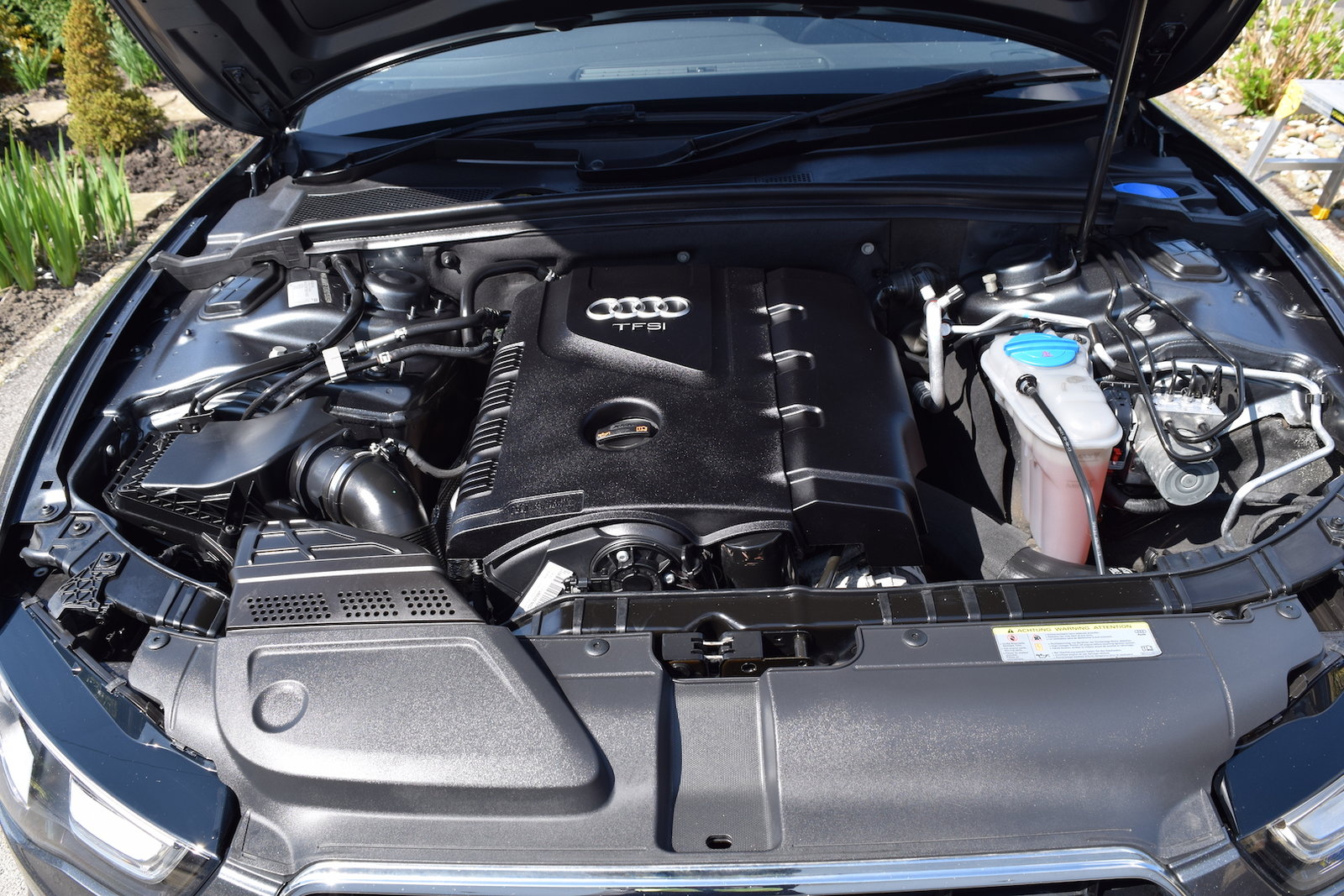

    Engine bay next up with bonnet....thoroughly pressure washed ( on low pressure ) and treated to Britemax Grimeout at 4:1....agitated with a multitude of brushes and rinsed...then all areas force air dried with filtered high powered air then all areas dressed with Aerospace 303 protectant. GREAT TIP HERE: aerospace 303 was atomised over whole engine bay once dried....spray liberally all over then close bonnet, wait for 6 hours and tah dah....engine bay looks brand new!!!

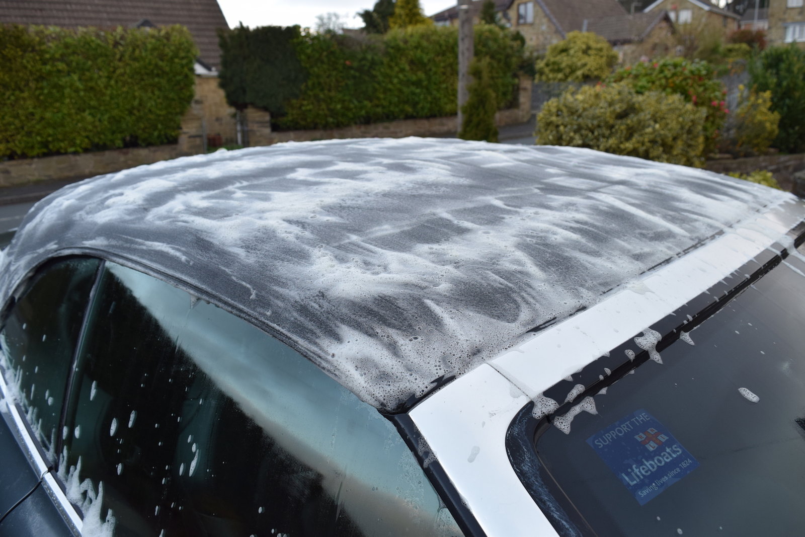

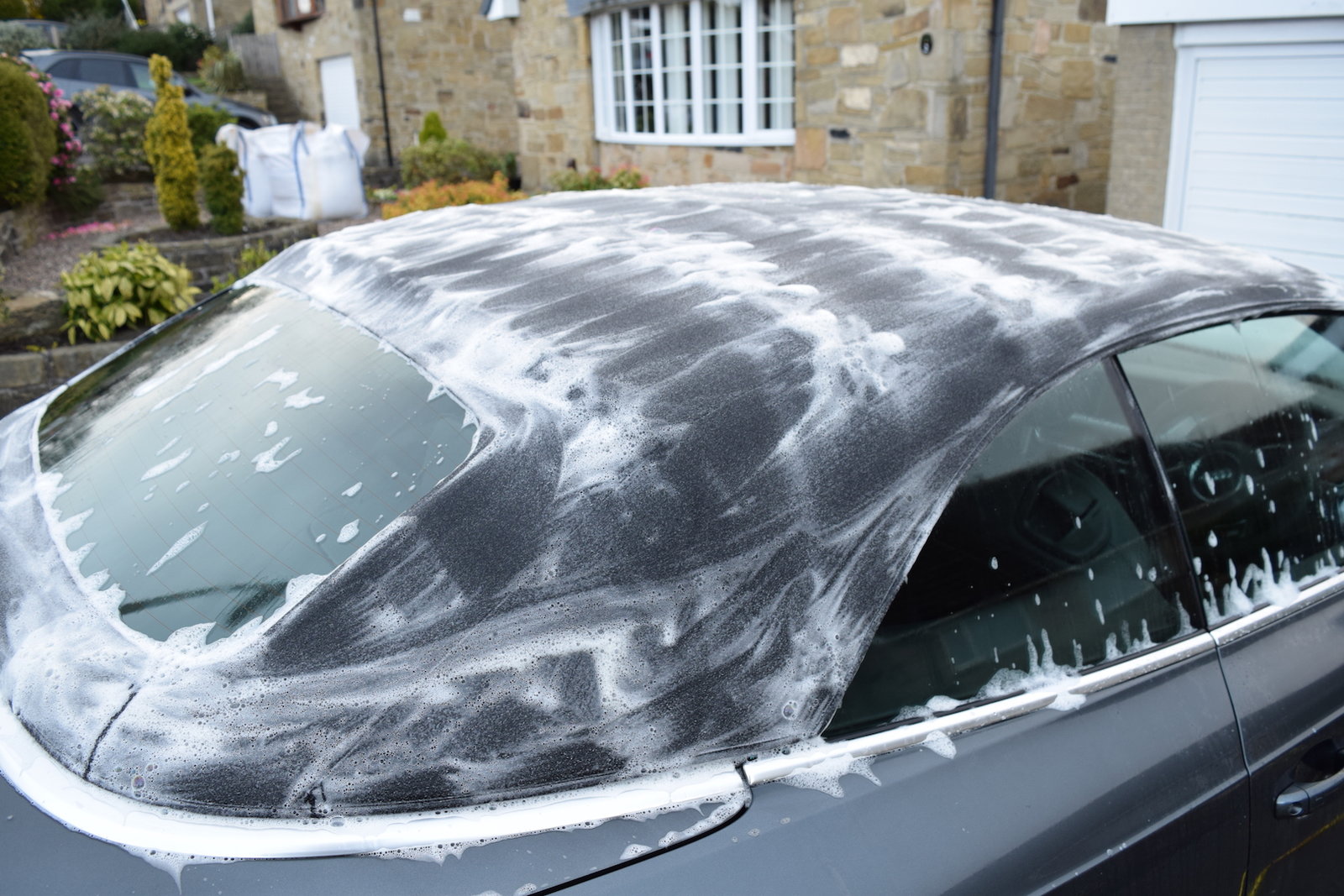

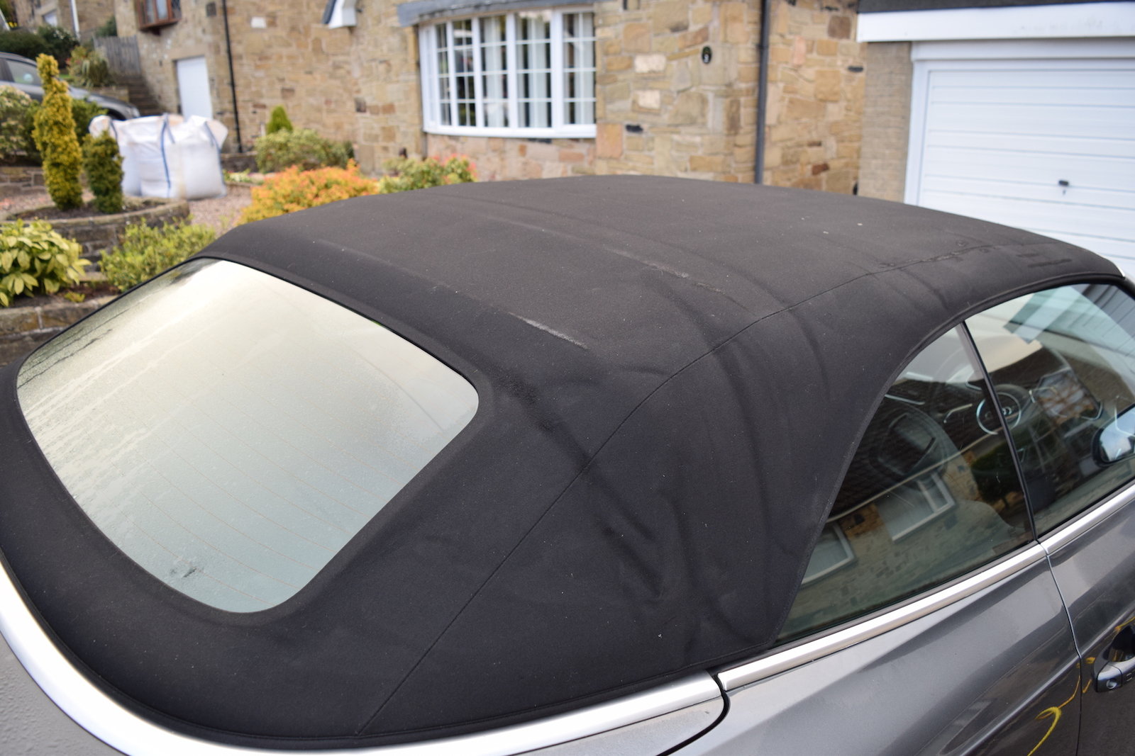

    Next was the hood which was full of mildew....6 times cleaned / scrubbed by hand and rinsed.... Britemax Citrus Magic is magical on soft-tops & is also anti-fungal so mildew will not come back....stopped when rinse water was running clear.

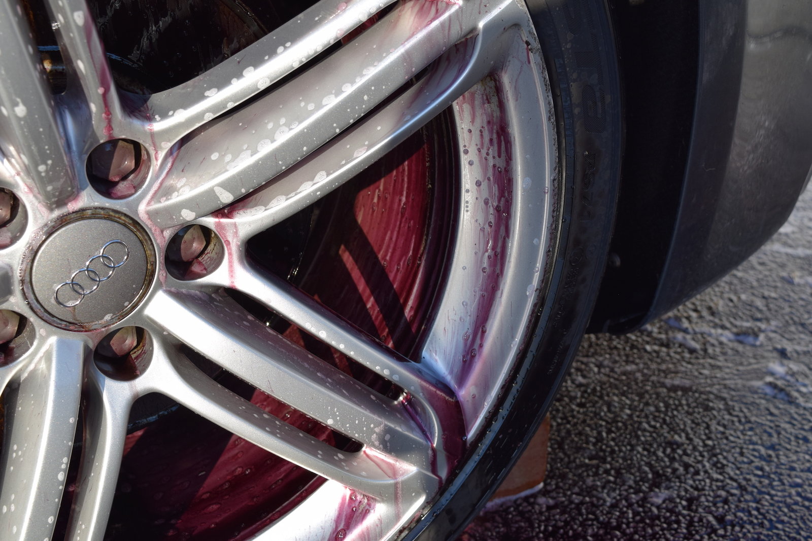

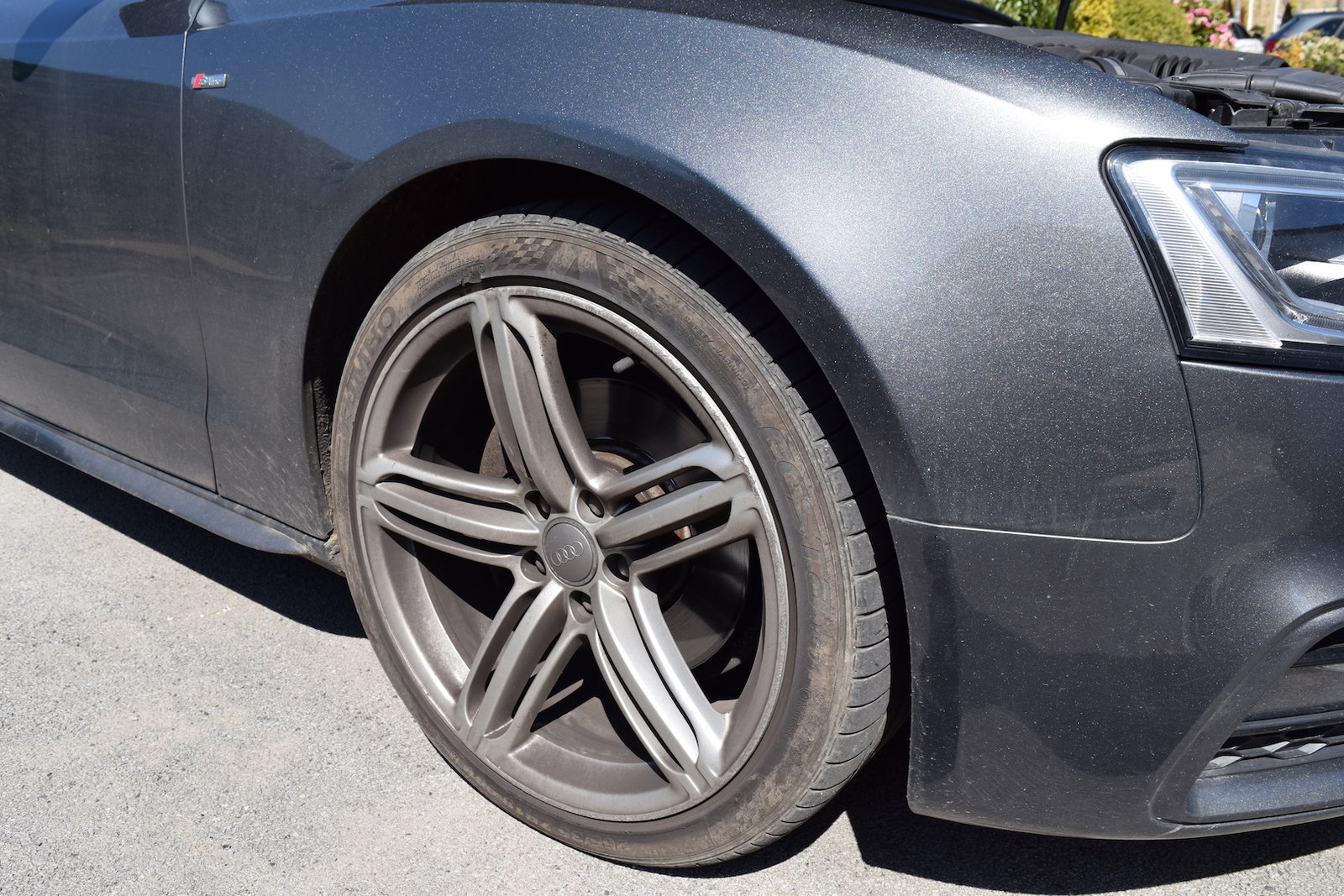

    Next onto the wheels.....3 hours to get the wheels something like presentable...there comes a point of diminishing returns when the only option is to have the wheels refurbed.....twice hit with acidic cleaner and twice hit with Bilt Hamber Auto wheels iron remover

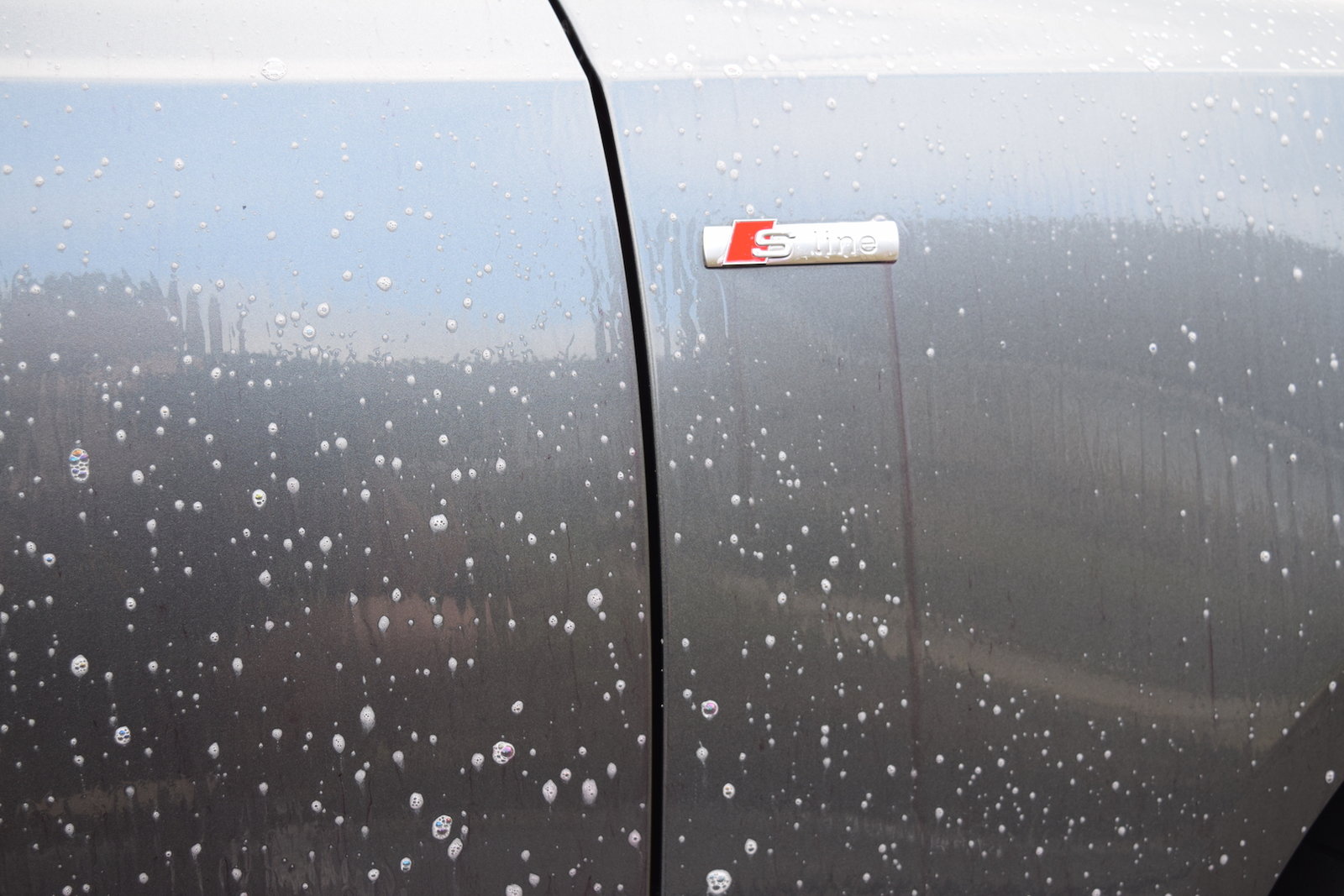

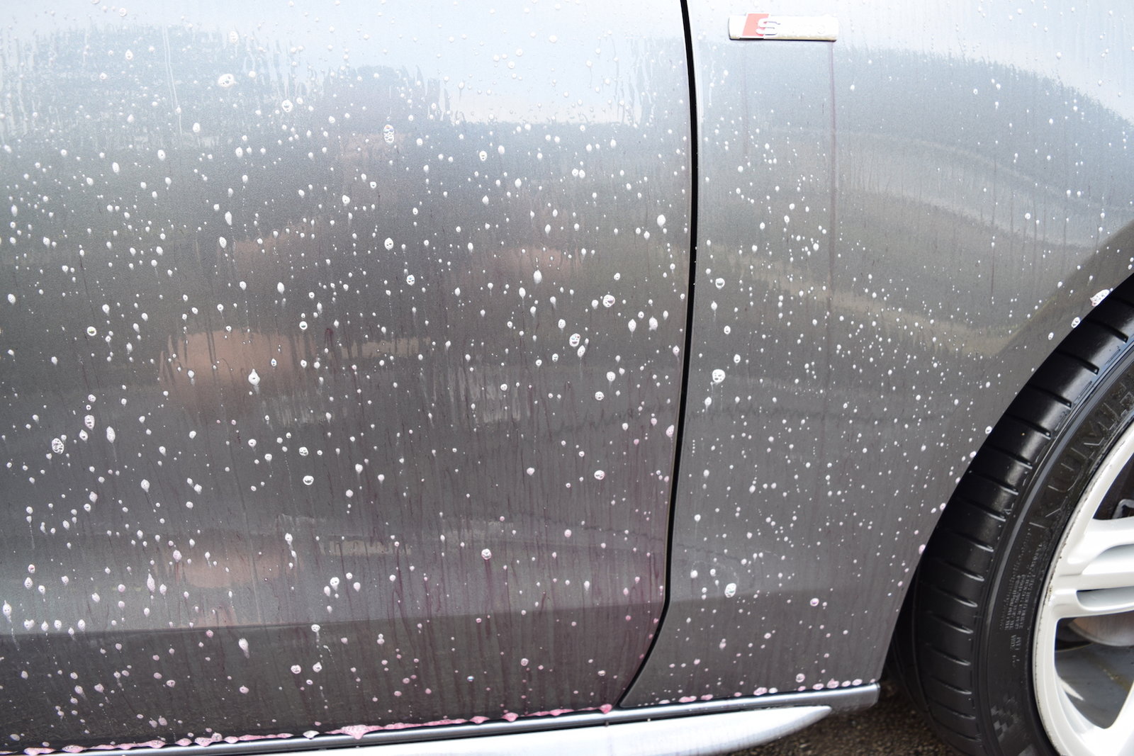

    Getting tired now...lol....vehicle pre-washed with Bilt Hamber Auto Foam ( the very best foam currently available IMHO ), and allowed to dwell for 10 mins before being pressure washed off. Two bucket method with dual gitguards and fabulous Dooka pure lambswool wash pads......for shampoo ( Gyeon Essence ).
    Vehicle then treated to chemical decontamination...Gyeon Tar first followed by Bilt Hamber Korrosol iron remover and there was a huge amount of iron. Vehicle then treated to yet another Bilt Hamber snow foam bath to remove all chemicals.
    Tac systems clay cloth with Gyeon clay lube to clay whole vehicle of remaining bonded contaminants including all glass.

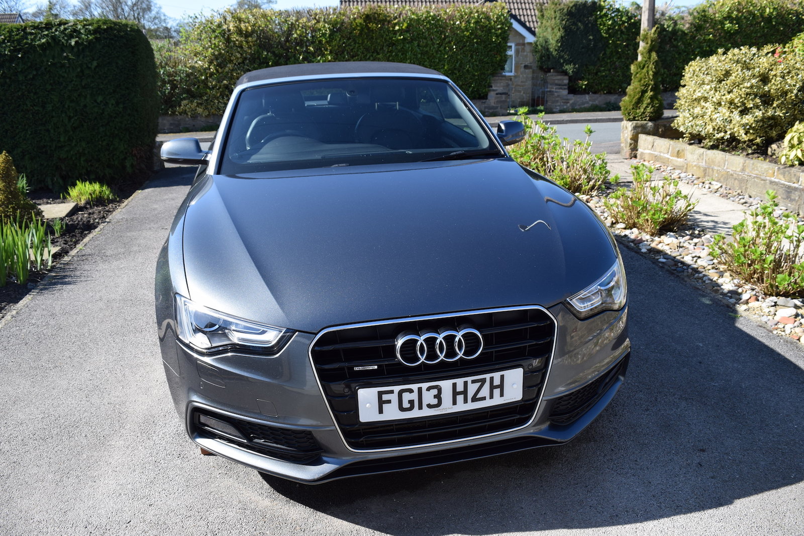

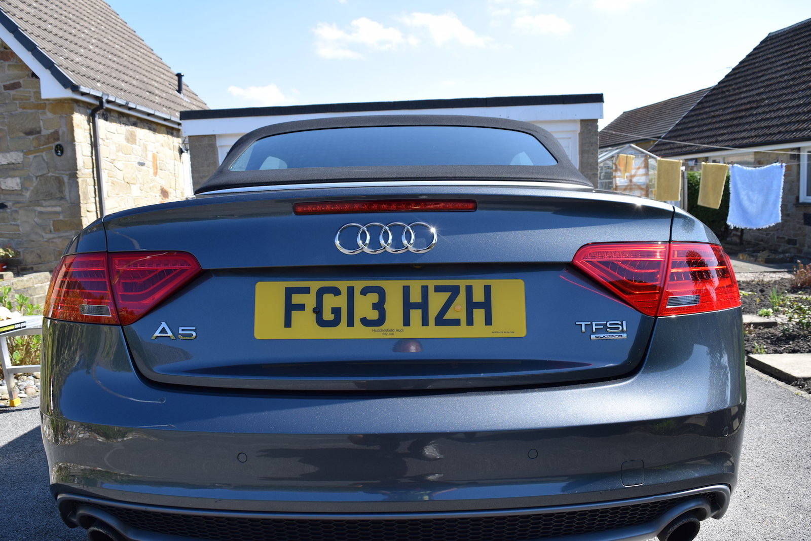

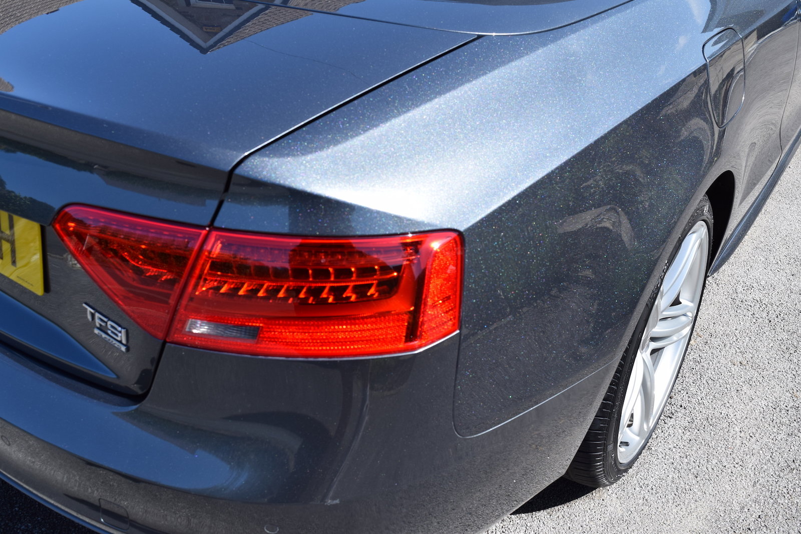

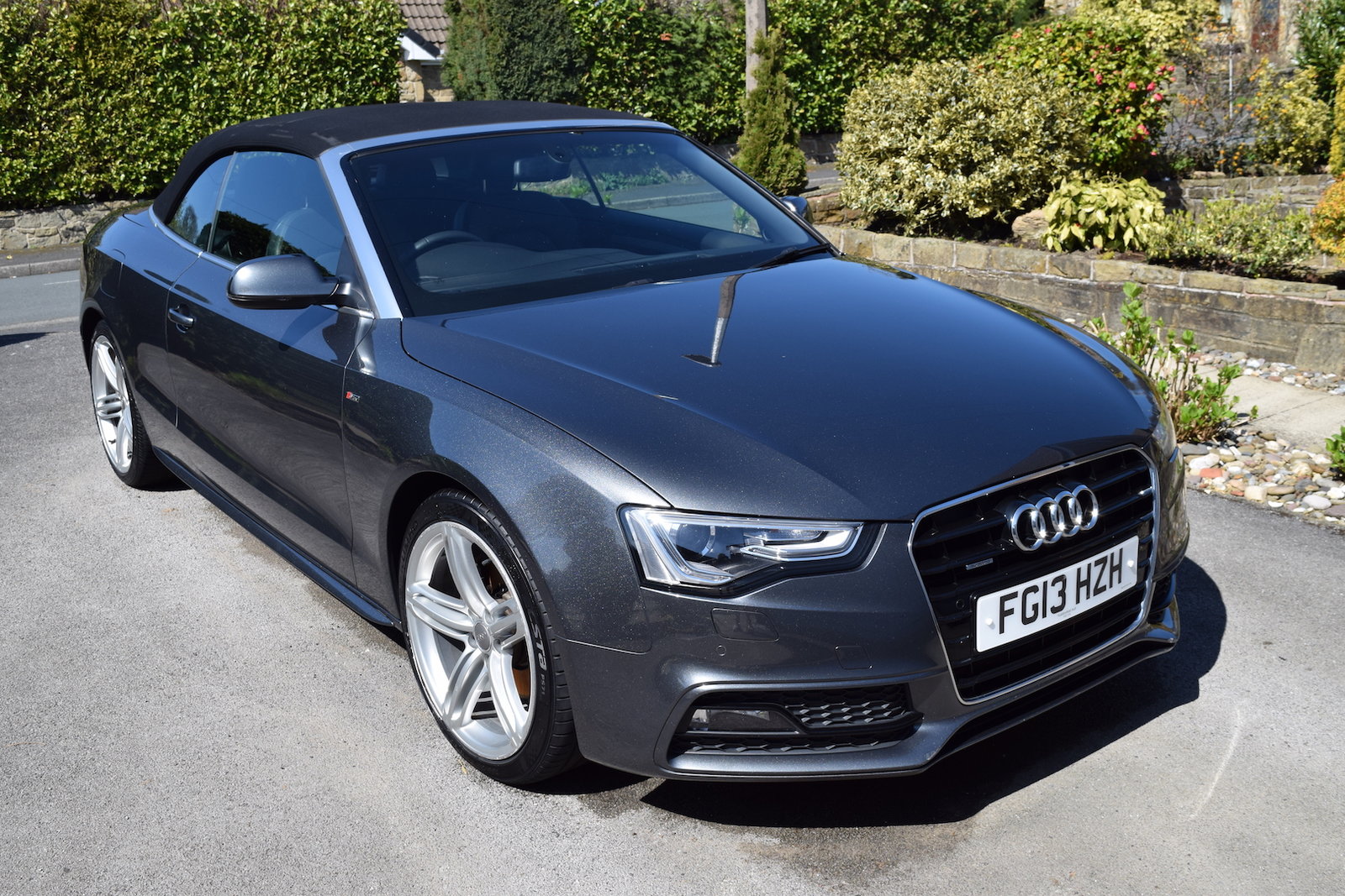

    Vehicle again pressure rinsed off and blown dry for the intricate areas prior to machine work. Next up was Gtechinq Panel wipe to the whole vehicle to get a true indications of the horrors that were left!...Machined with of course all Rupes machines and ' MY " special mix of compounds. Vehicle then treated to 2 coats of Bilt Hamber Double speed wax and topped with again another special mix of mine.
    Tyres then further degreased with Gyeon prep prior to application of Gyeon Tyre. Tailpipes were too far gone for any transformation. Time for a well deserved beer or 12!!!....Hope my client gets a sale now!!!

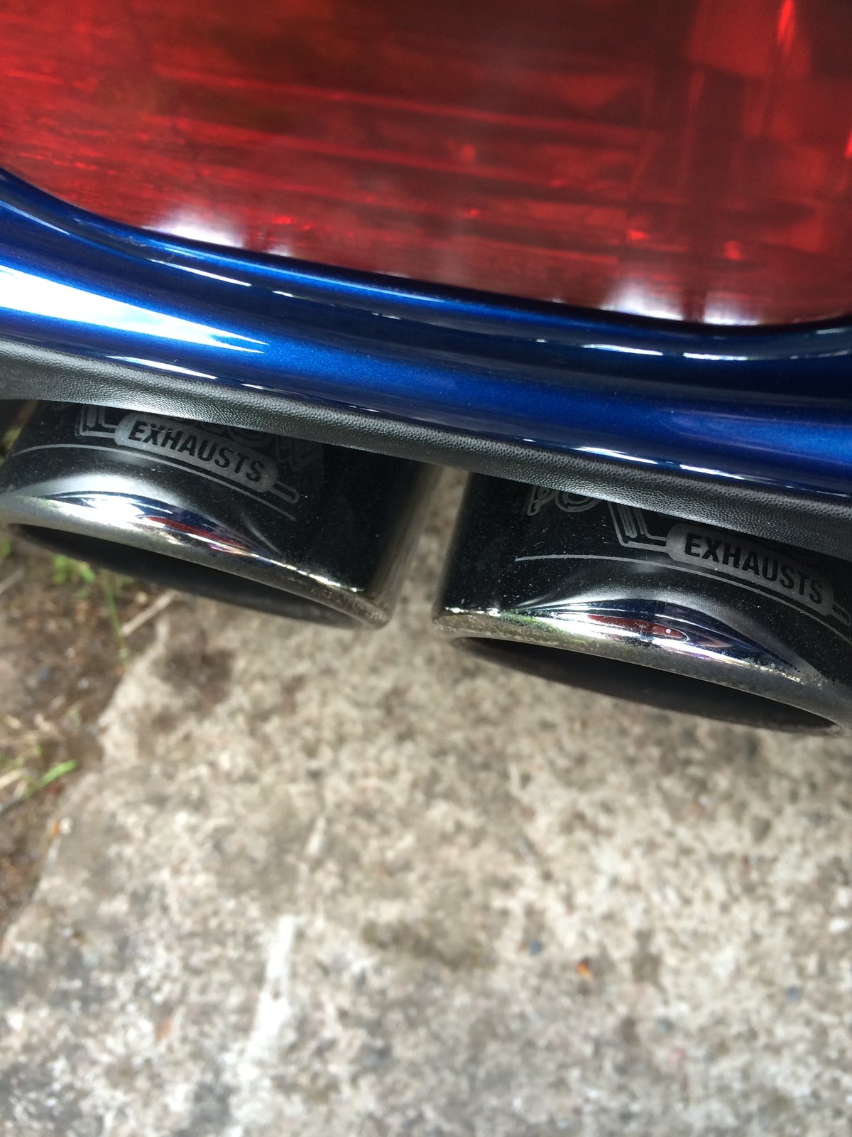

  12. Can you ever get the chrome exhaust tips back to the polished finish ? I’ve tried everything on mine but once they’re tarnished you can’t seem to get them back to new looking...
    Great job btw, love that colour when it’s polished..
    I use brasso on mine
  14. Thanks buddy...yes you can....Britemax twins and 0000 wirewool....job done!
