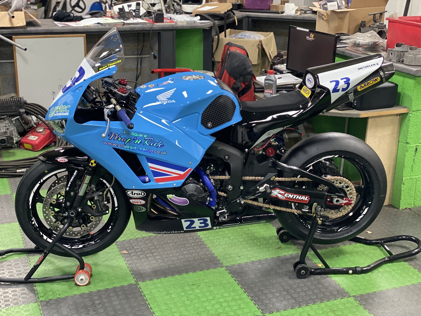

  19. I ran bridgestone 200 Vo2’s on my 600 which was usually fitted with a 180. No problems CA548EA9-0005-44A7-B722-D06EF87C0E2F.jpeg
  20. Exactly. Where I can’t imagine you try and fit a 200/60 Dunlop or Pirelli
